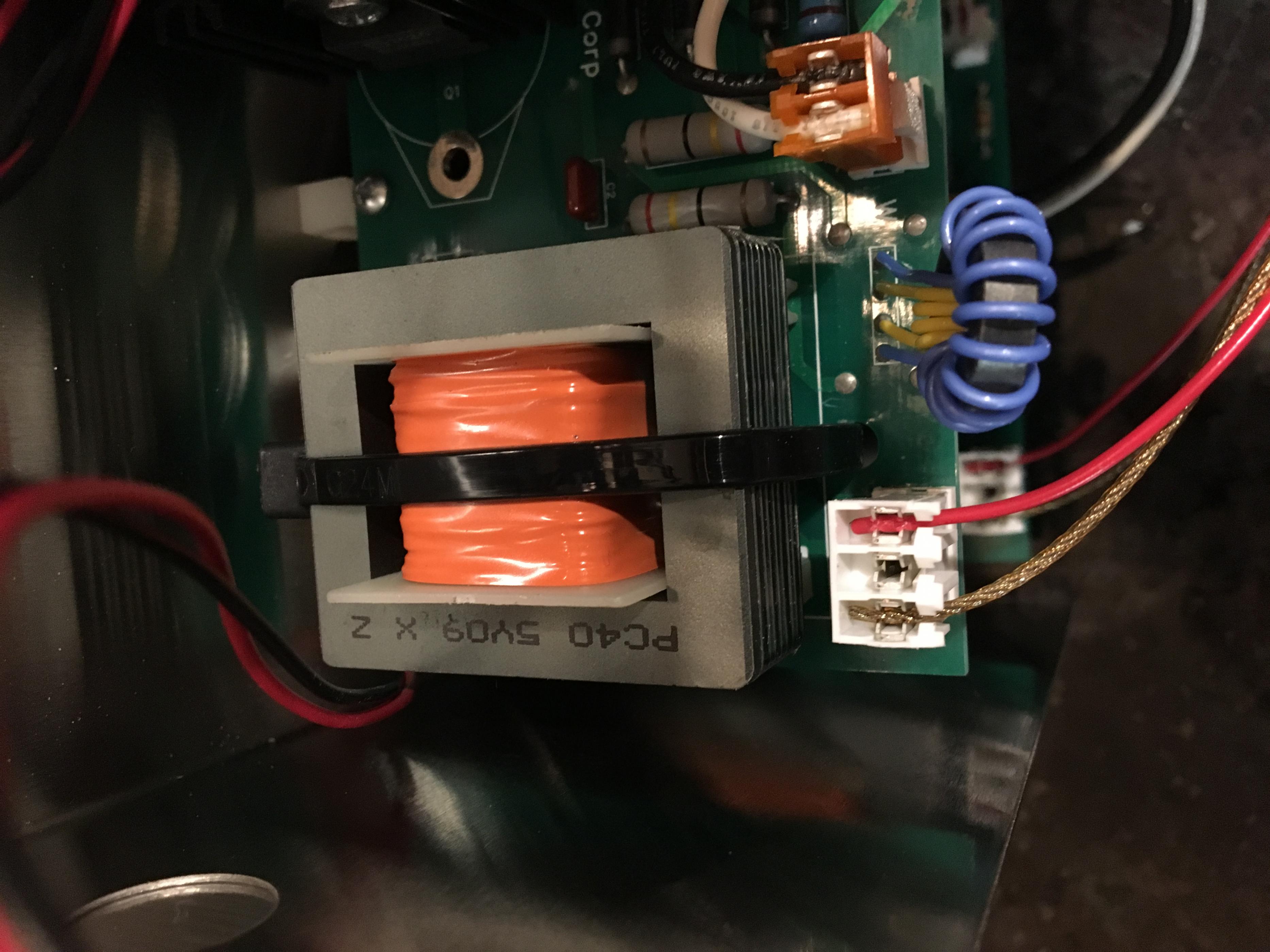

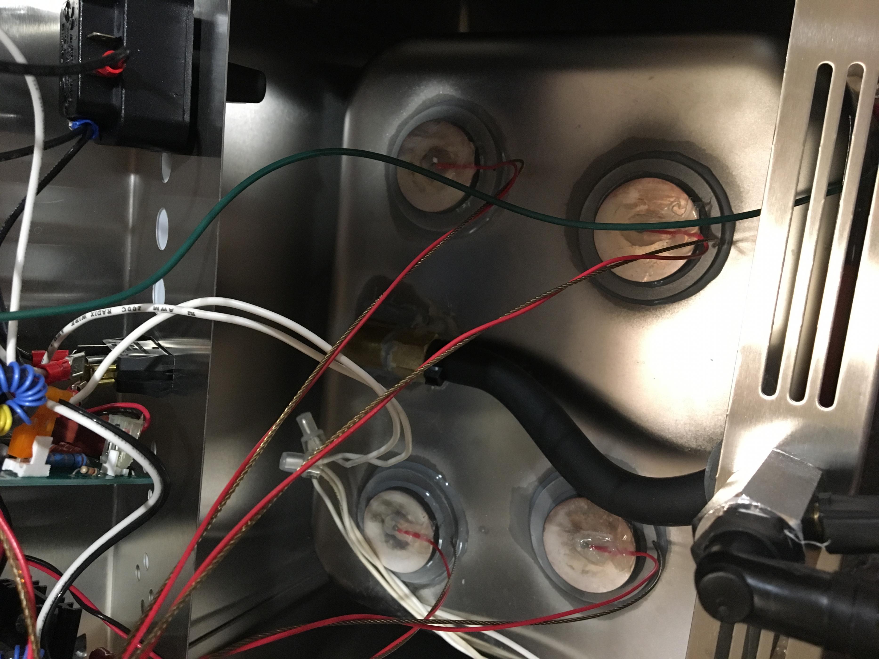

I used to work for Sonix IV and can confirm that those are 60khz Transducers, but are only 35 watts each.
The circuit board was redesigned by me, because there was a flaw with their original - two circuit board traces were too close and would arc, causing the board to burn and fail.
They also had a problem with the transducers cracking or falling off.
-Louis
Louis, I'm curious about orientation of the transducers. I noticed that all the US cleaners the transducers are on the bottom. Is there a reason not to put them on the sides of a tank? The reason I ask is I have some spare Sonix transducers and thought puuting them on the side might add to the effectivness of the tank.
I believe the only issue is spacing. There isn't a lot of space between the enclosure and the tank. If it's too close, there could be arcing/shorting. Perhaps a coat of 'NoArc' or silicone.
The bottom of the tank is where the most vibrations can occur, since the sides are attached to the enclosures with glue/silicone, but side mounted transducers do work.
-Louis

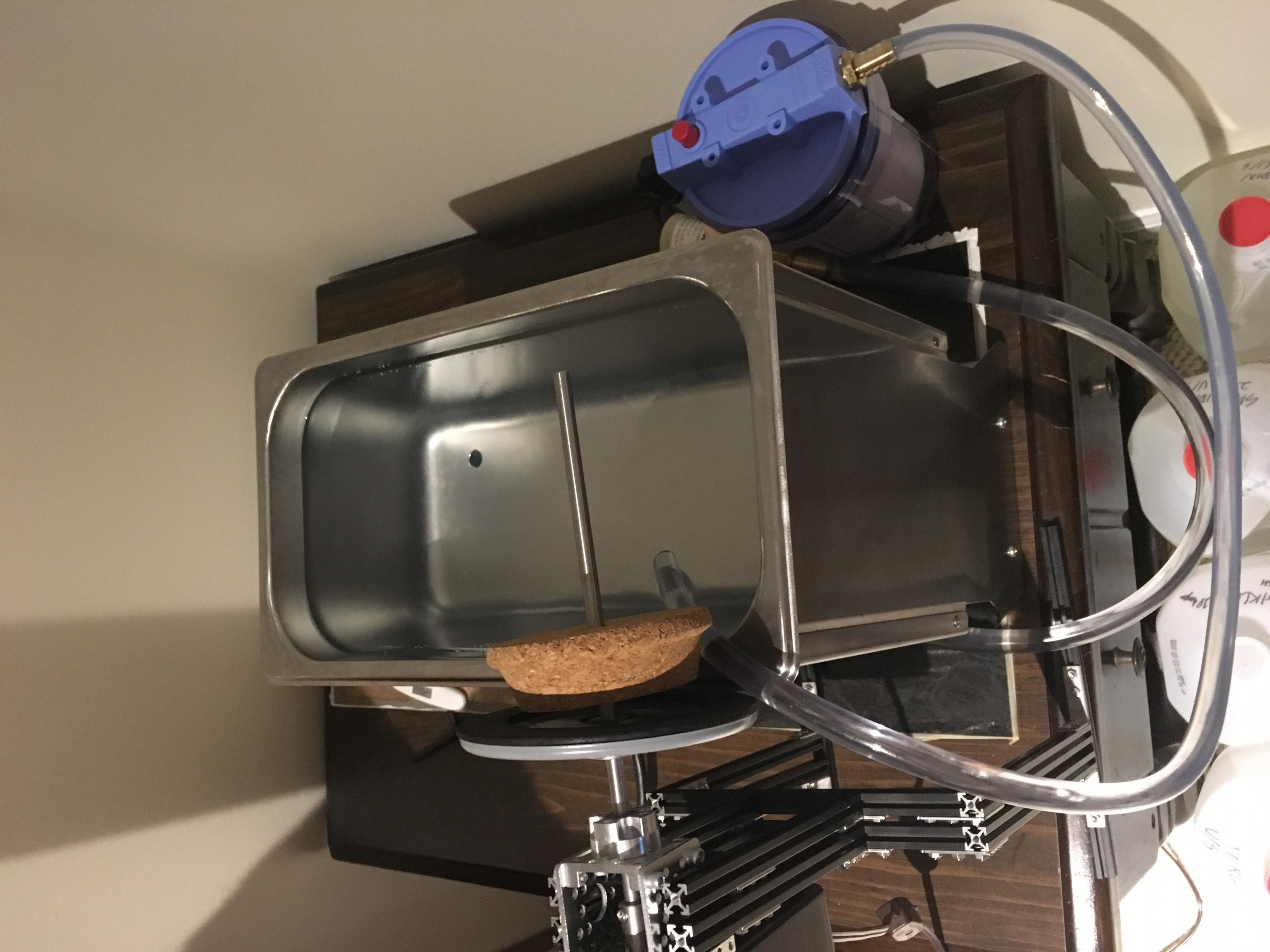

Terrible photo, but here's my new pump & filter setup in action. I need to kludge together a clamp for the output hose, but this works surprisingly well and quietly. Parts list as follows (thanks to someone else here for most of this):
bayite BYT-7A015 DC 12V Solar Hot Water Heater Circulation Pump with DC Power Supply Adapter Low Noise 3M Head 8LPM 2.1GPM - - Amazon.com
Pentek 158110 3/8" #5 Slim Line Clear Filter Housing: Replacement Water Filters: Amazon.com: Industrial & Scientific
Amazon.com: Hydronix SDC-25-0501 NSF Sediment Filter 2.5" OD X 4 7/8" Length, 1 Micron: Industrial & Scientific
Watts SVIG10 Pre-Cut 1/2-Inch Diameter by 3/8-Inch Clear Vinyl Tubing, 10-Foot Length - Plumbing Hoses - Amazon.com
Banjo HB038-90 Polypropylene Hose Fitting, 90 Degree Elbow, 3/8" NPT Male x 3/8" Barbed: Amazon.com: Industrial & Scientific
https://www.amazon.com/gp/product/B00AB5WYVC/
Order total with free shipping was about $60. Does the trick! Got a couple of different nozzles from Kohl's and Home Depot since I needed 1/2" into the pump (pump came with 3/8") to match the output nozzle and hose of the tank drain, and the output nozzle from the filter hadn't arrived yet so I got a brass one instead out of impatience. 😛
Once all parts were set, it was maybe 20 minutes to get everything working. Super easy, works great.

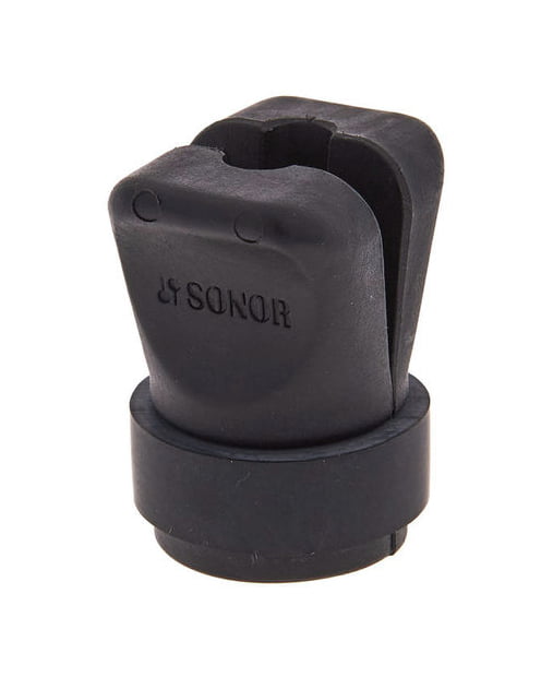

TIP!
What I use on my DIY USC to clamp fast (and uptionally have half a twist to tighten) instead of running the nut all the way on the 6mm thread (only enough room for a couple of LP's on the unit due to its size)
I thought it could be useful for other people as well 😉
