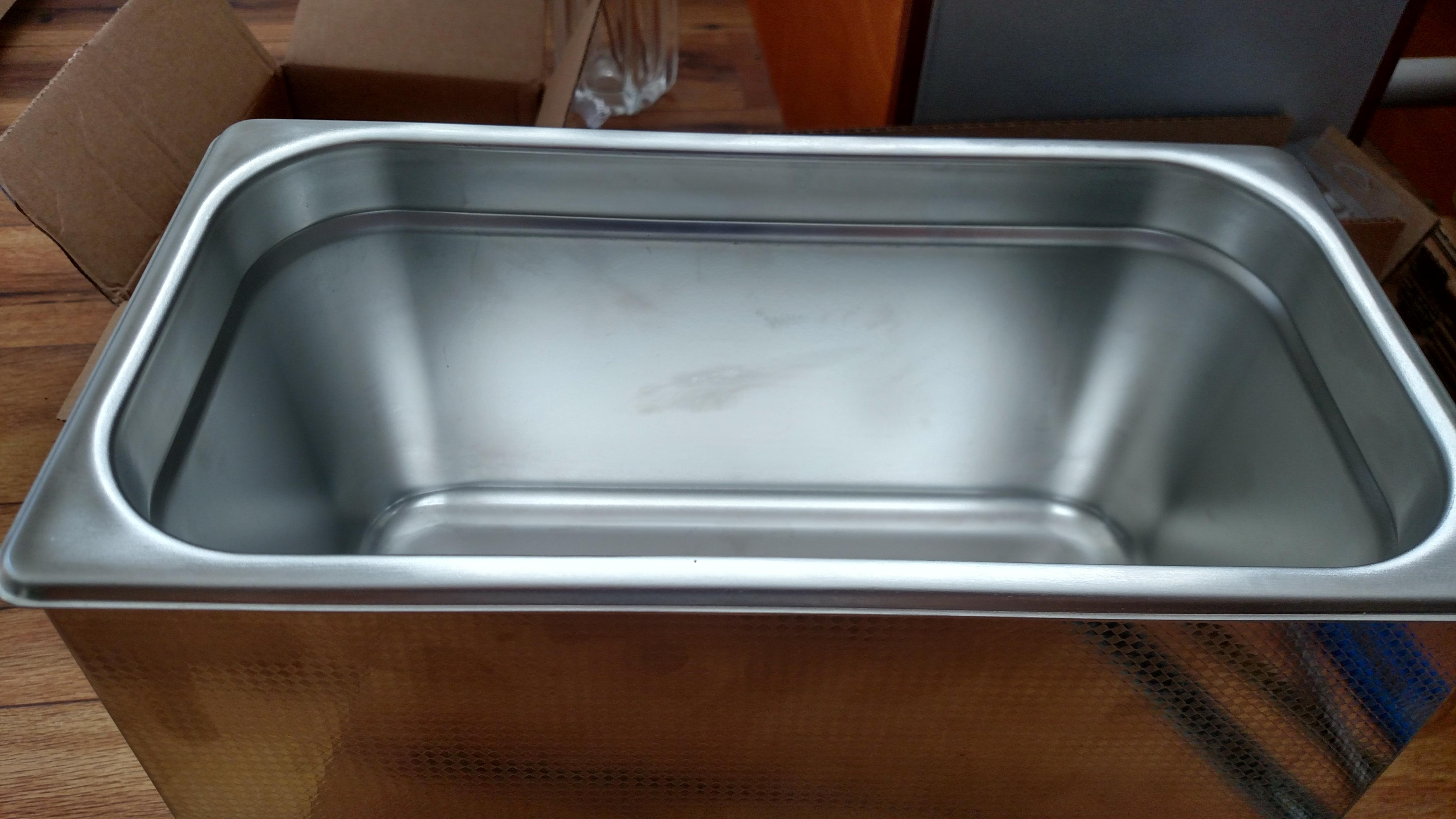

Hi guys been building aluminum over top bridge for the records. I just got a grizzly 6 liter unit and it looks great. Hope it works as well as it looks.
I have a question about water fill line. Grizzly did not know and I searched all over the web. It seems like 1 inch from the top came up twice on 2 different units and mine has a rim for the basket which is 1 inch from the top.
Is the I inch about what your machines are using???

The water level should be high enough so that it is in the run-out grooves - ie. not quite up as far as the label but more than the last music groove.
Andy
Hi Tom,
Each model of cleaner has its own optimal fill height.
In general you don't have to worry too much about overfilling. Under-filling can create more problems, particularly if you are using a tank with a heater.
I'm not real familiar with the Grizzly unit you have, but there are pictures on the web showing there is a max fill line and min fill line in the tank. Does your tank not have a line labeled "Max"? If not use the attached photo as a guide to estimate the proper max fill height. I've circled the position of the max fill line.
B B

Hi B B
It is a be1231. There are no max/min marks any where on machine or in literature. There are 2 lines around the inside of the tank where it tapers down. Will post a picture. They are at about a inch down.
Thanks Tom

You realise, Tom, that the LP(s) you are cleaning is/are held on a spindle which has a support structure which sits higher than the tank?
As the support structure you use might be different to, say, the support structure which I use … there's not much point me telling you whereabouts on my tank, the water level is.
What is important is that the groove annulus should be entirely below the water level - but not so deep that the edge of the label gets wet.
Why don't you mount an LP on your spindle, put it on your support structure and then keep filling up the tank until you get the level just into the run-out grooves. Then you can see how this level compares to your 2 lines.
Andy
Hi Andy
The ultrasonic people want you to be close to max for what ever reasons. The up down movement is easily done on my design. I just wanted to know where I could put max water level, then adjust the records as you recommended.
Thanks Tom
Aah, OK, Tom. I've just got home from work and measured the mark I put at each end of the tank; they are 3/4" down. 🙂
Andy

Tom,
For this type of unit, the shoulder in the tank is the fill line. Just make sure you cover the shoulder in the tank with the top of the liquid. That's your min. fill line. This is especially important for a unit with a heater, which it appears this model comes with.
B B
