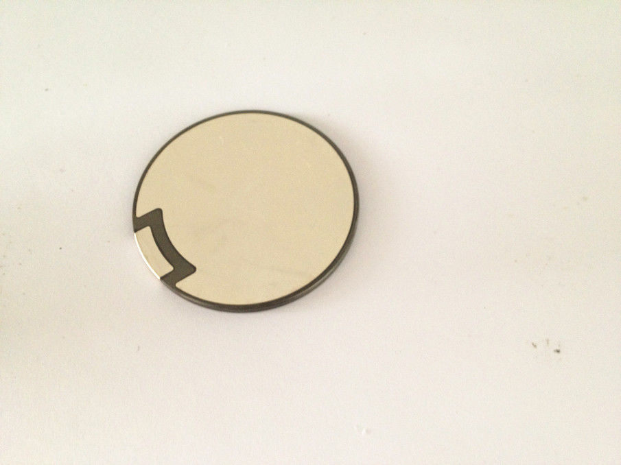

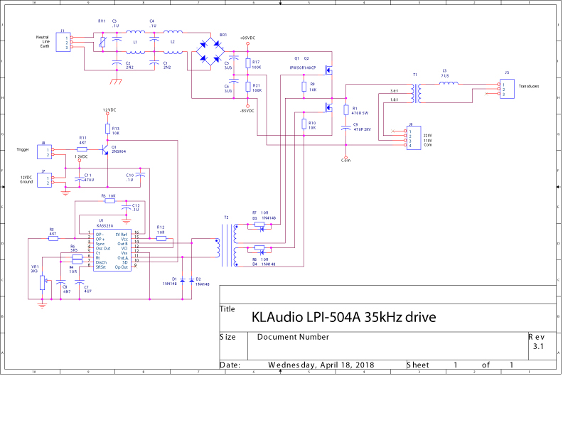

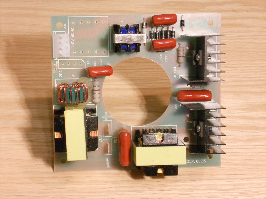

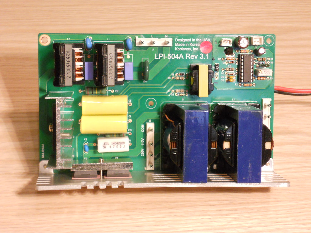

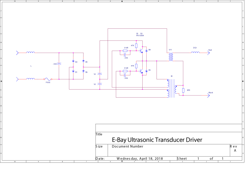

The Kirmuss machine appears to be a low cost Chinese US RCM (made by Codyson) with a custom record spinner instead of the rotisserie motor assembly and no heater. Isonic sells a product that appears to be the unmodified version of the Codyson cleaner. As far as the KA RCM making changes to the transducer angle, it's difficult to see how that could be accomplished. The bottom of the tank has 3 circles where the transducers are mounted and it appears to be the same in all 3 machines. The transducers have to be epoxied flat to the stainless steel tank, and there are no surfaces that are not orthogonal. If anyone has one of these RCMs, it should be a simple matter to confirm this.

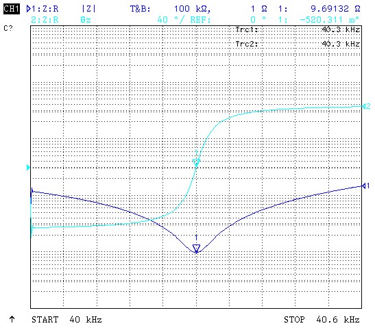

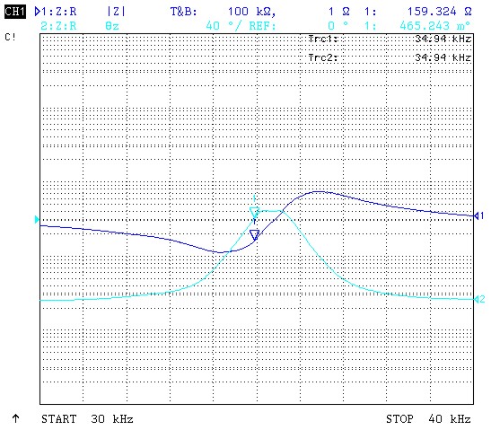

As far as the 35kHz rating goes, the KA RCM is most likely using 40kHz transducers, but when tied together, the resonant frequency and impedance is greatly affected. A stand-alone transducer in free air will exhibit several very definite resonant responses, characterized by a notch in the impedance curve (series resonant) and no reactive component (0° phase) as seen in the first graphic. When the transducer is mounted to a SS tank filled with water, the resonant frequency shifts and the impedance increases drastically (from less than 10Ω to ~160Ω in this case, see second graphic). This is the reason for the HV supply needed to power these cleaners. Unfortunately, it is difficult to build a flexible amplifier that operates at these voltages, so most of the US cleaners use a very simple switching supply that has little control over power, output waveform or impedance matching; see graphic 3 & 4, which are the KLAudio amp and a $25 DIY amp from e-Bay. While the build quality is noticeably better in the KLAudio amp, the circuits are amazing similar. Both use rectified line voltage (±85VDC) that is basically unfiltered so the output pulses at 120Hz. The output stage uses a class D switching circuit and a fixed step up transformer to increase the voltage to ~250RMS at 200W. The KLAudio amp is capable of 115/230VAC input and uses a KA3525 PWM controller to generate the 35kHz signal where the e-Bay module is 115VAC only and self excited.
The last parameter (impedance matching) is one of the most important (this is LF RF after all) and if the source is not matched to the load, the amp will consume a lot of power, but produce much less usable output than if operated at resonance. It is the same effect as detuning a transmitter antenna by cutting it to the wrong length and expecting it to have maximum range; it doesn't work. The second graphic is the impedance plot of the 4 KLAudio RCM's transducers tied together in parallel. Note that this is advertised as a 40kHz cleaner, but it actually operates at 35kHz, same as the KA machine. The frequency is manually adjustable via a small pot on the amplifier PCB and is set so the RCM draws 200W, although this is not the optimum operating point. If the transducers were properly matched, the lowest impedance point would occur at the zero phase crossing and the transducers would be operating at series resonance. What the graph shows is a composite impedance, and most likely, none of the transducers are operating at their resonant output. If the frequency is adjusted down to 34kHz (the lowest impedance), the power consumed increases to 340W, but the transducers also become highly inductive, the phase angle increases, power factor plummets and the acoustic power produced in the tank will decrease.
Driving an ultrasonic transducer is not like driving a speaker. A piezoelectric element has a complex impedance that changes drastically with frequency. From what I can tell, few of these manufactures are able to drive the transducer arrays effectively, either through a lack of understanding, or due to the cost of doing it properly.
