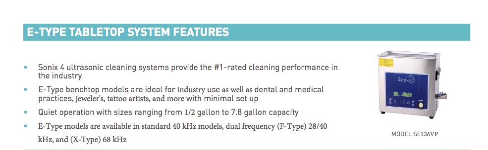

I just bought a SONIX IV ST136 which apparently was manufactured in Oct 2015 as per serial number. I am not for 100% sure if it has 60 or 40 mHz transducer.
I have a 40 mHz ebay one prior to this one. I cleaned a record again in the SONIX and I did not find any difference. I emailed customer service to confirm the mHz with the serial number. Mine has two knobs for heating and timer. The heater knob does not have Celsius degrees. The older version had a on/off switch for heating function. Hopefully it is the old version.
Kanchi,
You shouldn't expect a record you've already cleaned multiple times to sound different when you clean it yet again. It won't.
This isn't a "magic audiophile record treatment." It's just a way to clean some contaminants off the record. Nothing more, nothing less.
Also, these machines run in the kilohertz (kHz) range, not megahertz (mHz).

I don't think the Amazon listing is correct, as Sonix 4 lists the E-series machines as 40 kHz on their website (see attached photo from their brochure). I sent the company a question about their amazon listing, and will relay their response.
