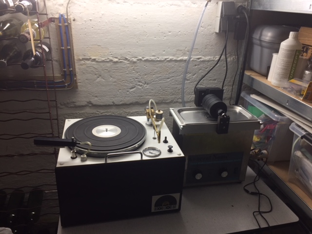

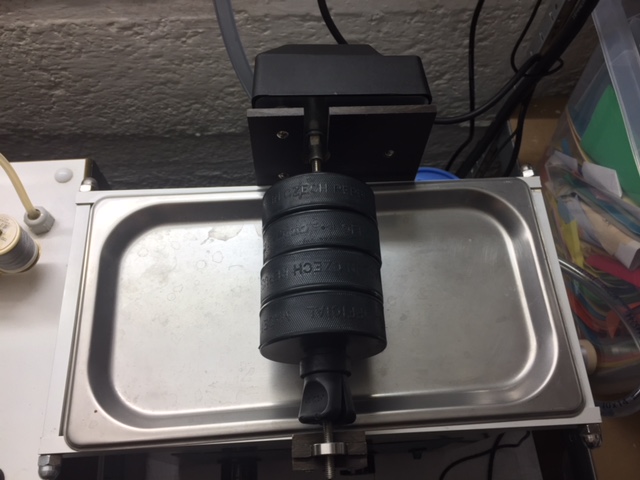

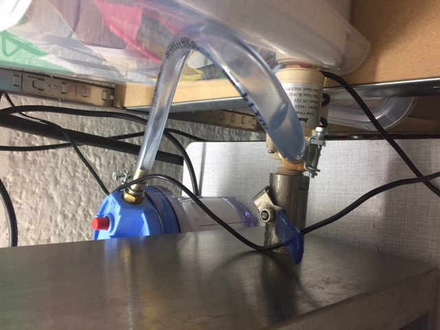

My RC set up
USC for the first run (1um filter/pump for maintenance every 5 Records) and immediate drying with the vacuum arm setup (no extra fluids applied)

The other day, a question surfaced from forum members about the operating temperature for a small aquarium pump that I use in my USC set up. I did not know the answer so I wrote to Marine Depot, a vendor. However, I framed the question at the temperatures I am comfortable using, up to 35°C. Here is their response:
Hello, Mike,
Thank you for your email.
Yes, the Sicce Syncra Silent 0.5 pump is safe to operate with liquids at those temperatures.
Please let us know if you have any other questions or concerns. Have a great day!
Felicia M.
Customer Support
www.marinedepot.com
1-714-385-0080
Hah! Hadn't thought that attaching the pump DIRECTLY to the output would be feasible in the event of different thread pitch. That's hilarious, but presumably works just fine. I MIGHT be a little concerned about vibrations and direct heat transfer causing issues down the line, but hey, these pumps are cheap, so whatever works for you!
