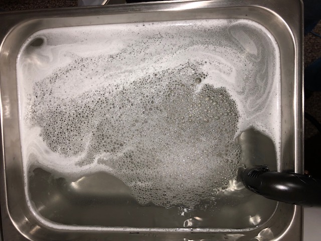

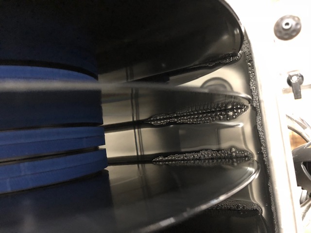

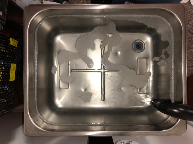

I'm cleaning records using a Trusonik 10 liter unit. I'm using approximately 3 gallons of distilled water, and spacing the records 1.5 inches apart as per the recommendations in this thread.
My question concerns the cleaning formula. I'm not mixing in advance, but adding the ingredients directly to the distilled water each time. I'm not rinsing the records due to lack of time. So, for better or worse, the cleaning formula needs to be aimed at one-step cleaning and drying.
I first used 6 oz (177 ml) of isopropyl alcohol, with 1 teaspoon (5 ml) of Ilford Ifotol, as per the recommendation of Tima on the Vinyl Press site. That resulted in a few bubbles during the cleaning cycle.
I next tried 6 oz of alcohol along with 0.5 oz (15 ml) of Triton-X in 3 gallons of distilled water, as I understand that is the recommended amount as per Rushton Paul. I mixed the Triton-X and alcohol together first before adding to the water. I tried Triton-X since that type of surfactant is recommended by the Library of Congress and the National Library of Canada. Triton-X appeared to work better for the drying of the records than did the Ilford Ilfotol.
The Triton-X resulted in a fair amount of foam. I have attached three photos, first showing the minimal amount of bubbles while cleaning is underway. Second, the greater amount of foam when running a pump and filter. But maybe that is understandable due to the agitation caused by the pump and water circulation (I believe at least one gallon per minute, which is not during cleaning and therefore might not a reason to be concerned? Finally, a photo of the remaining bubbles after I turned off the pump and waited about 15 minutes.
My question is whether the small amount of bubbles/foam next to the records is a cause for concern while cleaning? Or the greater amount while the pump is working and cleaning the water?
Should I reduce the amount of Triton-X? Or use Ilford Ilfotol instead?
Many thanks in advance for any responses; for your assistance; and for the excellent information provided in this thread!

Emosewa,
Try using just distilled plus isopropyl, particularly if you don't want to rinse. Pure water and isopropyl contribute zero residue. Any contaminants removed from your LP will be in solution in the bath and become very, very dilute. Most can be filtered out of the bath with a filter setup.
You've been using too much Triton-X and the Ilford. You definitely don't want any foaming. If I use anything like that now (i.e. Photoflo) it's a couple of drops --- certainly not 0.5 oz. Start from the other direction (i.e. no other ingredients) and see if you get satisfactory cleaning. I find that I get great results that way.

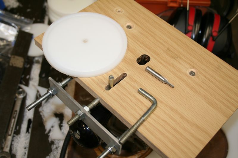

Creating record separators with a router
I am on the home stretch in finally completing my ultrasonic record cleaner. I hope to have it completed in the next few days. One of the things that always vexed me was the separator devices. I wanted to use UHMW plastic and an o ring. I don't have a lathe but I do have a router.
Most routers have a protractor accessory that will allow you to rout circles. Problem is that the circles you can rout with the standard accessory are far too large of a diameter for this application. The pivot point has to be within the base of the router to create circles that are less than 5 inches or so. I created a base plate that has an adjustable pivot that will allow me to easily reset the tool for the different diameter cuts that are required. Hopefully the pictures will provide enough detail should someone want to try this with their router. The pivot is an "L" shaped 1/4-20 bolt that I had in my junk box. A square cornered "U" bolt could be cut and would be much easier to source. The base needs to be thick enough to keep any play in the pivot to a minimum.
The process is to drill a 1/4" diameter hole in the UHMW and a plywood backing board. The pilot must extend through the UHMW and into the plywood backing board. Clamp the UHMW and the board to a sturdy table. The groove to receive the o ring is done first. I used a 1/8 inch round router bit for this. I found that two passes with slightly different settings would give a groove that would hold the o ring snugly. The final cut is with a straight sided bit that will create the final shape. It is best to do all of the similar cuts in a way that the tool has to be adjusted the least number of times. Be sure that you are happy with the groove cut before cutting the final diameter. There is no going back.

Another try for a picture
I resized one of the images and am posting it as an attachment. Let me see if this works. The thumbnail photo is of the router fixture and one of the disks I have created. I will keep the full size images in a Google folder for future reference.
