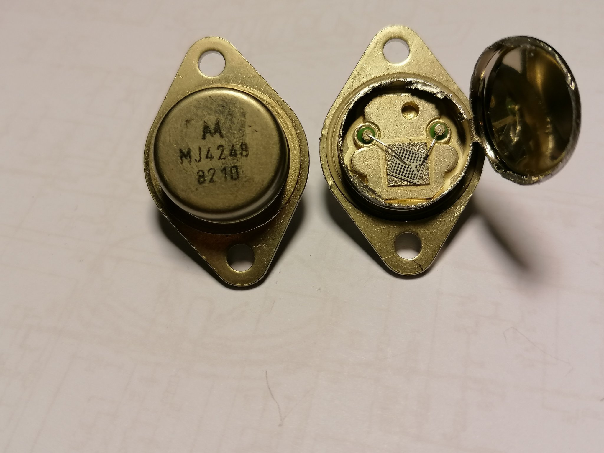

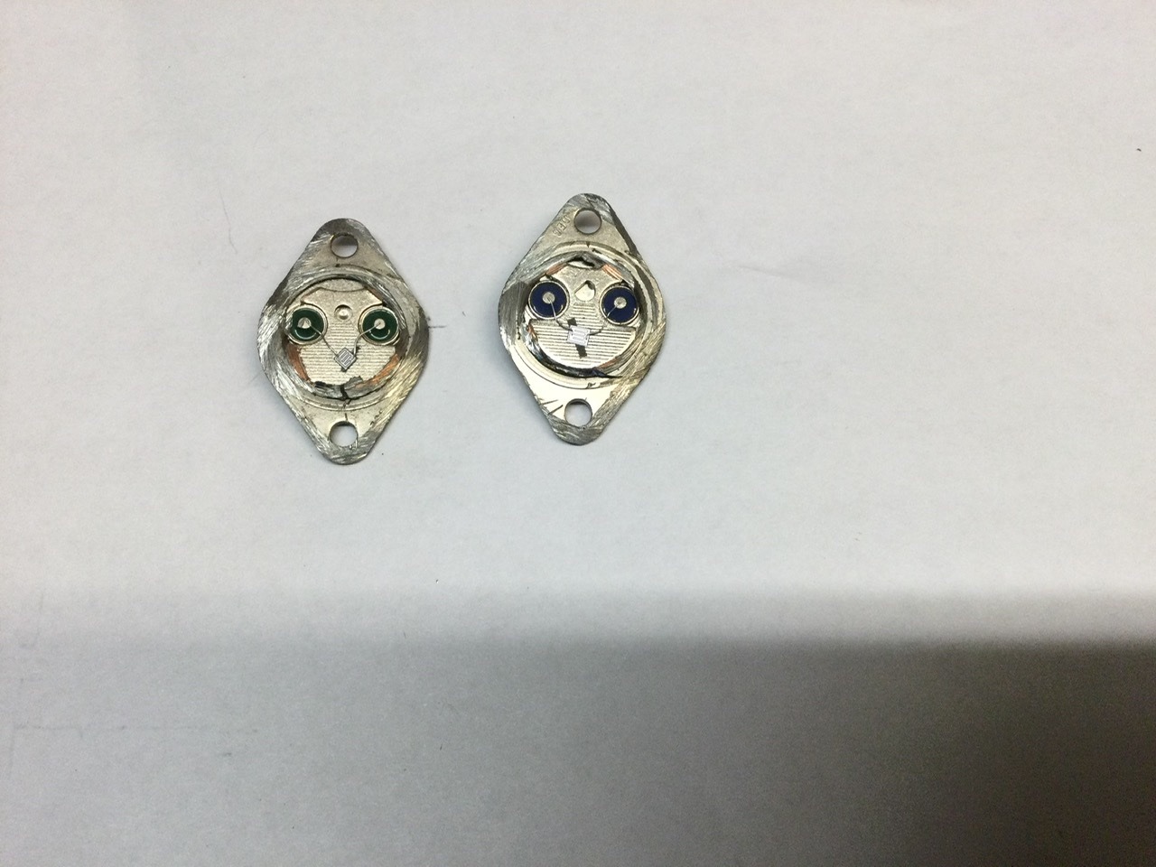

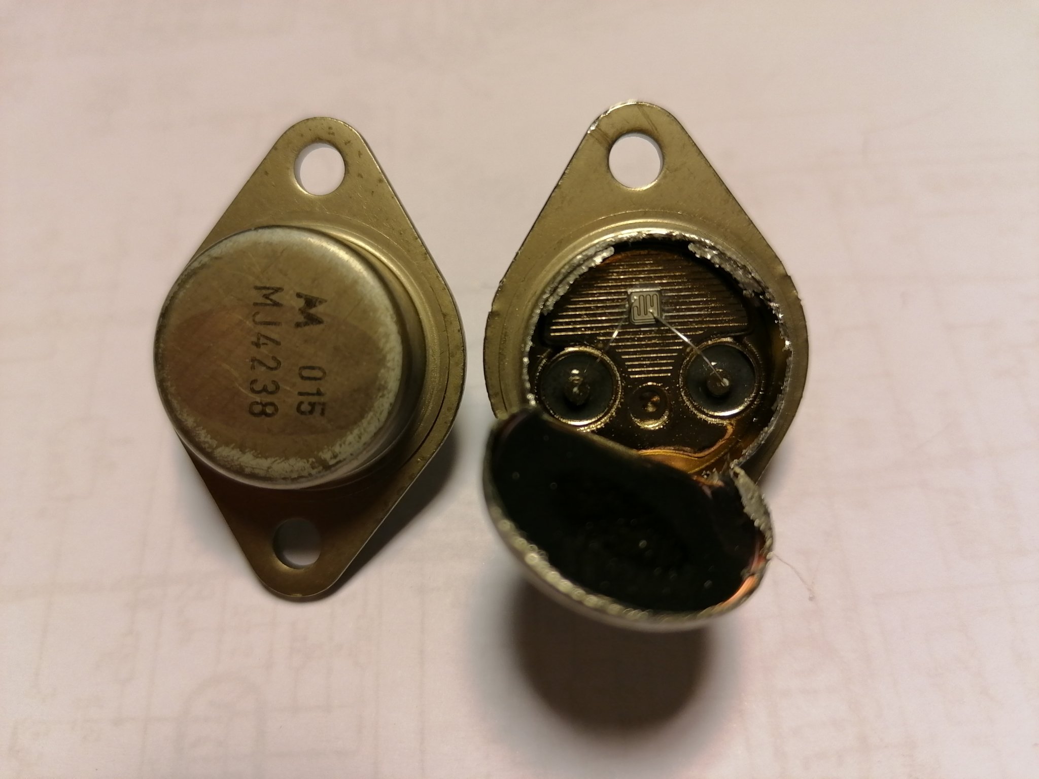

I have opened one of each and here is result:
The die in the picture at the top looks like the proper size for the job - whether it's the actual part in question or a re-marked part is quite another matter. The die inside the part in the bottom picture does not look anywhere near large enough to do its intended job, and would probably blow up wen presented with a substantial load. At least the die weren't coated with that nasty white silicone goo that all the fakers love to use.
The top one is definitely NOT Motorola - internally it’s simply not their package. Whatever it is, it is probably pretty good. MJ15024 size (200 to 250W) but the fT is anybody’s guess. I’d guess low - Layout looks like a vintage epi-base type. Bottom looks like Motorola 2N3055, or possibly any of their old 100W epi-base types. Probably a 4 MHz fT. You‘re better off leaving those 15024’s in there.

I haven't made a practice of ripping open my varied TO-3 stock to check construction details, so I will bow to your experience. As I pointed out, at least the innards weren't slathered in that horrible white silicone glue. The really phony device with the logo printed sideways (Motorola never did that) looks distinctly on the puny side. I wouldn't trust either of those transistors in any of my projects. Having said that, though, I rarely use anything but mosfets of vertical or lateral flavor as output devices any more. That's a whole 'nother realm for fakers...

That sideways logo isn’t Motorola’s printing, that’s for sure. But if you look at the scrub pattern, the original logo went the other way. It DOES look like Motorola inside. But a 100 watt die, and only 10A bond wires. Probably some old discontinued low value device, like 2N5878.

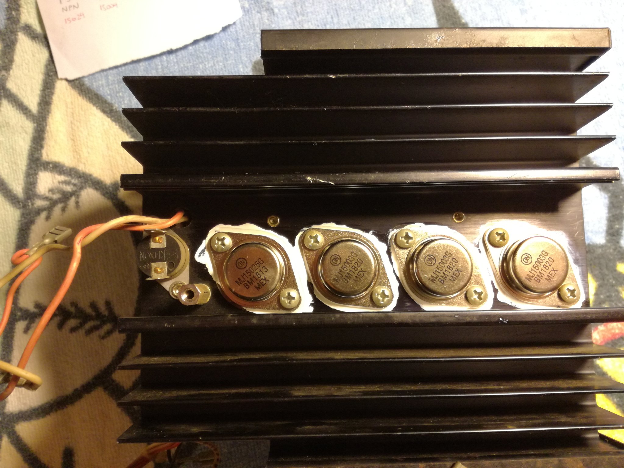

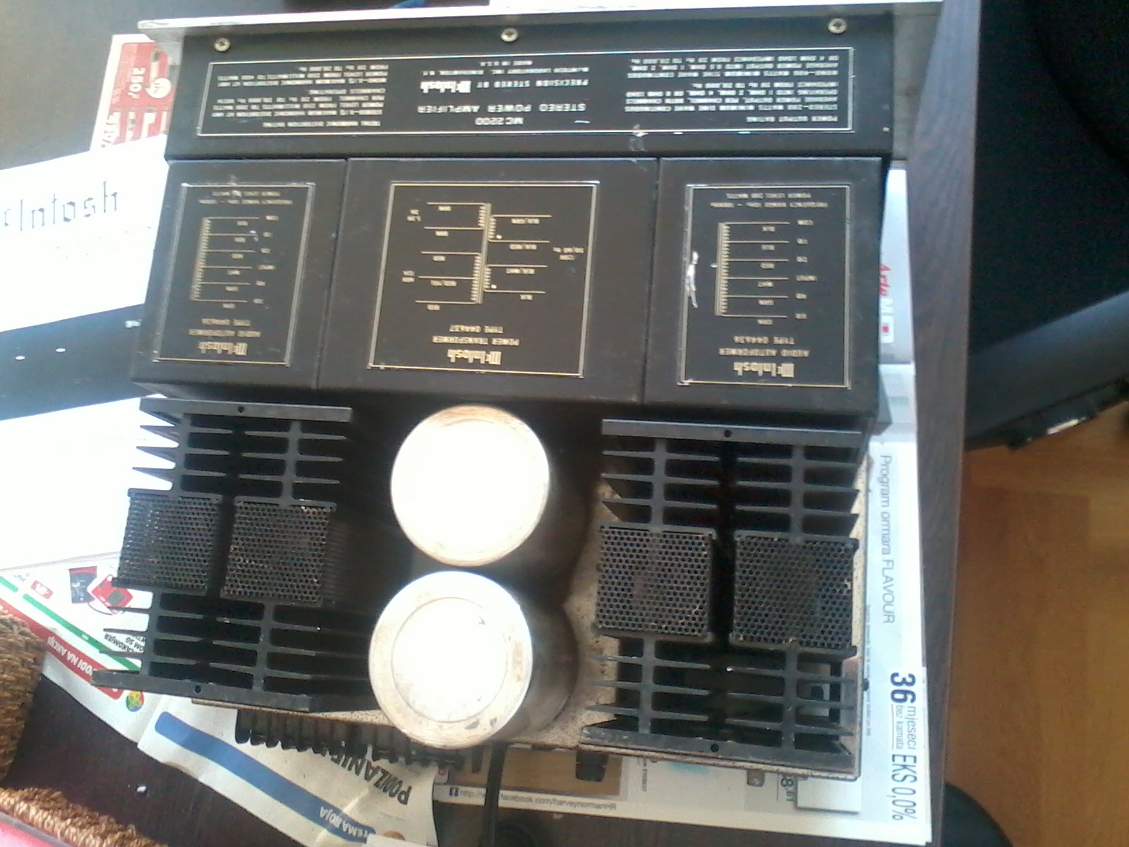

Here is the picture of heatsink where currently is MJ15025 which should be replaced with better replacement. I am affraid that even TO218 will not fit. I though that it will but when I look at picture I am nor sure anymore:
Square (not rounded) case of 2SC5200/2SA1943 will definitely not fit as hole of transistor goes in hole closer to the edge of heatsink.
So do you haver suggestions for TO3 or TO218 replacement for MJ series with hi(ghier) fT?

Why not change the heat sink as well?
Old CPU sinks, or equivalent should be enough.
Or find a similar extruded shape, which allows that package to be used.
Yes - If you can open up to packages other than TO-3, there are several options for complementary high ft devices. Sanken makes some, as well as Onsemi. A smaller heat sink with a dialed-down DC fan for cooling might be the way to go.

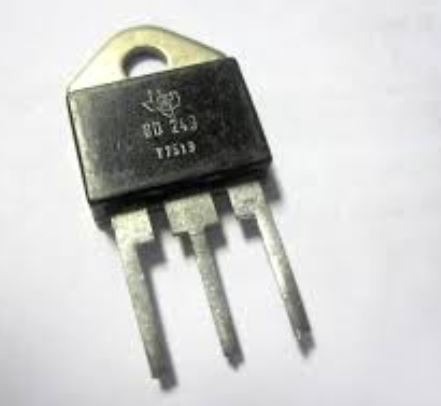

If you use TO-247 or TO-3P packages, there may be more room on the heat sink for them than you think. I would try removing one TO-3 device, then laying down the alternate package so that the mounting hole on the plastic package lines up with one of the TO-3 mounting holes. From the top view of the heat sink provided, it looks like you might have a little more room on the top side of the TO3s than the bottom, as viewed from above - correct me if I'm wrong... Connections could be made via jumpers from the plastic package leads down through the holes in the heat sink. If you are lucky, the leads on the plastic package might even align with the proper holes in the heat sink for base and emitter pins.

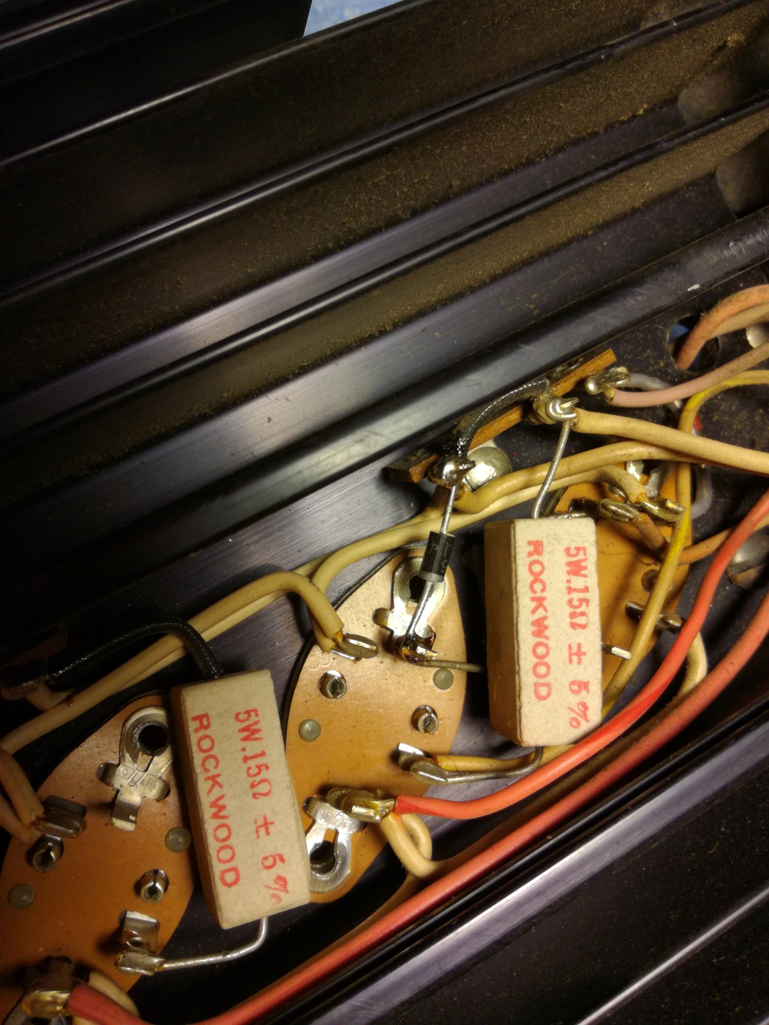

It actually looks like the TO-3 devices might be socketed, so it wouldn't be too big of a stretch to run the leads up through the heat sink holes to contact the pins on a TO-3P device.
If they are socketed and PTP wired there is also the option of removing the socket too. And then mounting the driver from the inside - from the opposite hole. Looks like plenty of clearance there.
It all depends on what's really on the bottom side of that heat sink, but I definitely get your drift...
Unfortunatelly, changing heatsink is not an option since heatsinks are part of the housing. You can see on picture position of heatsinks:
And this is from the inside, or underneath:
So, TO3 or maybe housing with rounded top like old BD249/250 for example, is my only choice:
I am not 100% sure that even transistor from picrure would fit.
I hope that you got the picture of problem with space. I forgot to mention and I apologize for my language as english is not my native language🙂
My idea was, if unable to find TO3 substitute with high fT, to make this conversion:
So I am affraid that TO3 or flat rounded package is the only choice.
Ivo
