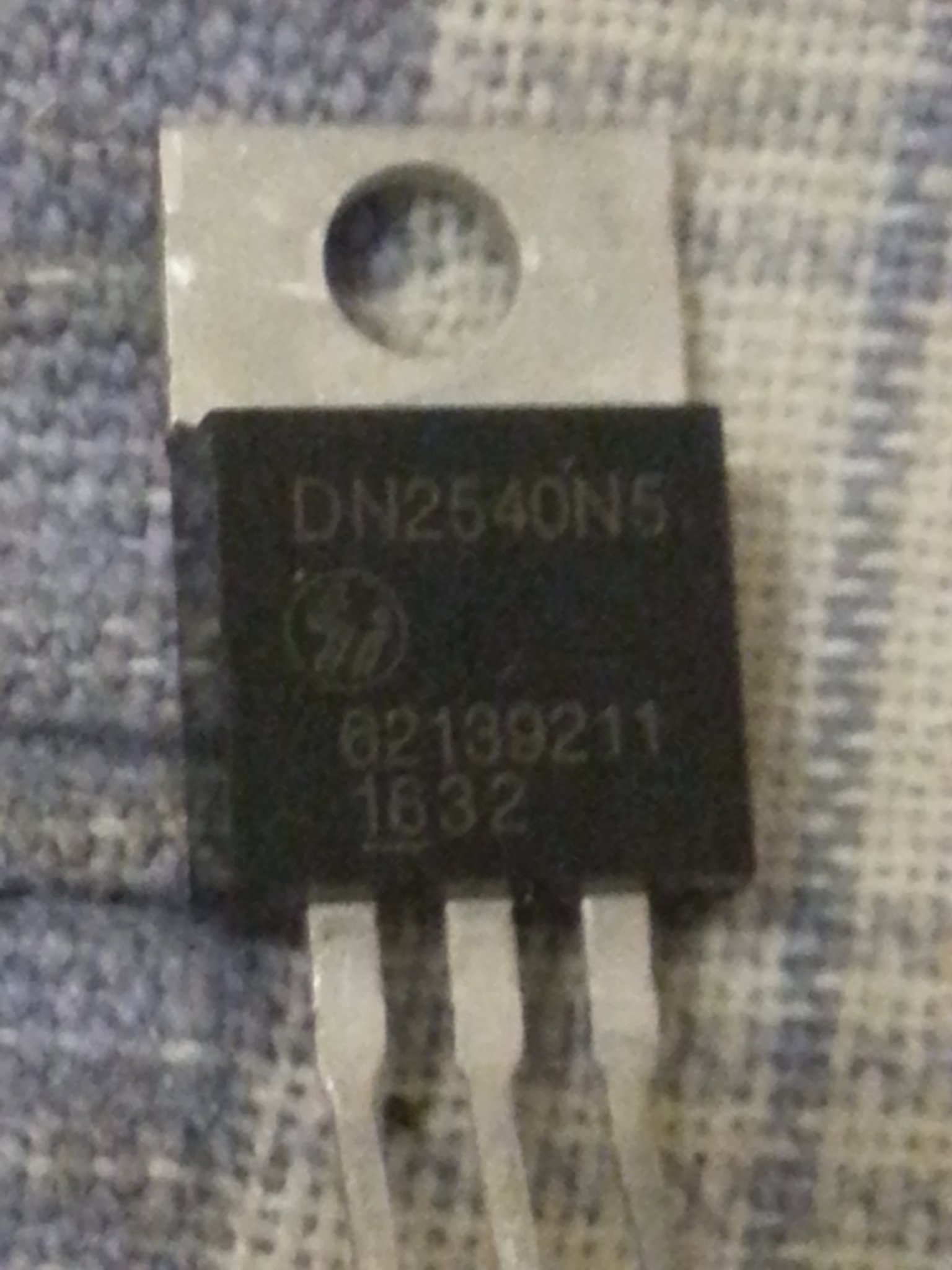

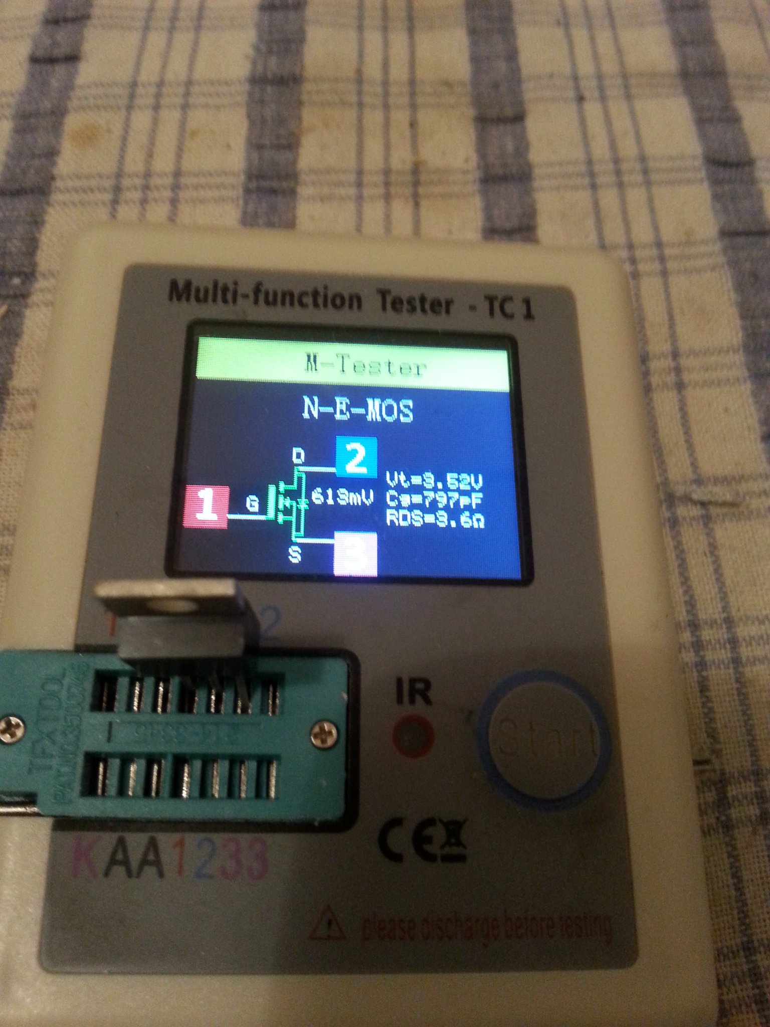

Hello, I came across a DN2540 from a trusted seller on ebay...as soon as I put it on the test circuit I realized that something was wrong. In fact from a subsequent test it seems to be a simple mosfet. Probable fake component?
PS: d-s has no values in ohm-meter and diode range.

Too bad it wasn't in English ...
Anyway, not very many of us will bother to crack the case to examine the die. In a sealed epoxy or composite case things are rather more difficult.
So, buy from accepted authorized distributors only if you can. If you can't, then you better know enough to be able to (properly) measure hFE, leakages and capacitance on the junctions. Then you need to be able to test the device in at least on configuration appropriate for that device. It would greatly help if you have a current limited HV supply so you can measure breakdown voltage. I use a 6186C HP DC current source (300VDVDC compliance voltage) for that purpose.
I'll be honest, it isn't worth the risk and work to buy from unknown sources for me. Most parts I get today are fakes, even special purpose ICs! Why would anyone buy an op amp for high performance from an unknown source ????? !
It comes down to using your head and do not give in to wishful thinking. The odds are against you, face it. But, it's up to you. May as well spend the money on lottery tickets, at least you know the odds.
-Chris
