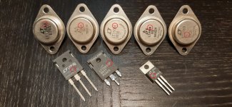

My Transistors, original or copy?

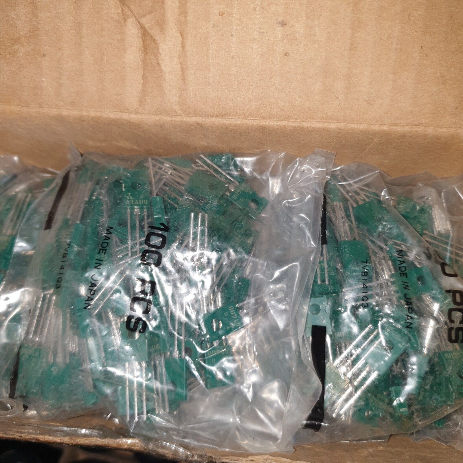

Hello ,
I am not questioning the authenticity of these,
but I am just curious if anyone else seen these before.
I have seen that regulator before, but not by Linear Technology. I would have to dig out a databook from those years to check the markings to be sure.
Failing that, you would have to test them on a heat sink. Now for the big question. Where did they come from (that you know is fact)? That path and their condition might tell you something. They are extremely clean for an old part number from 1992.

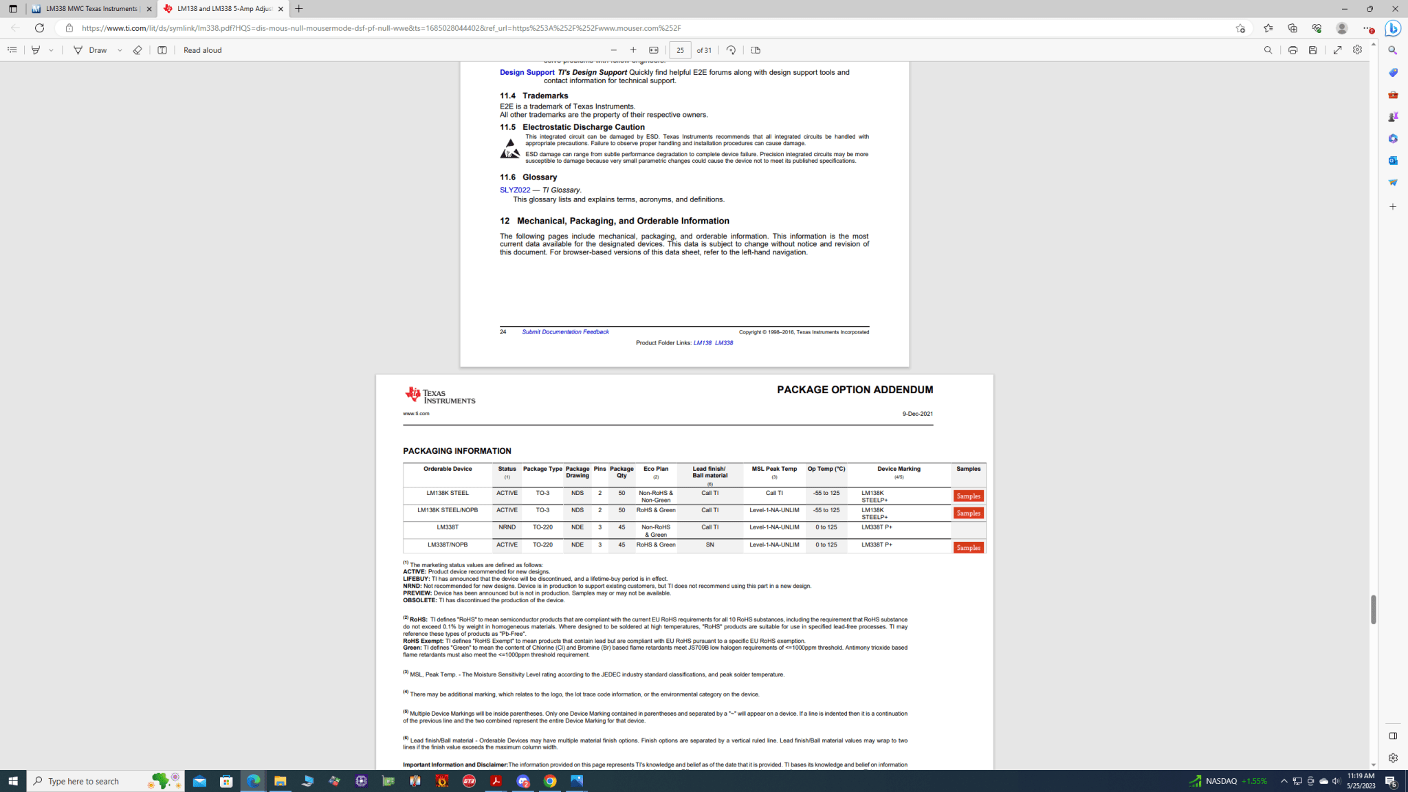

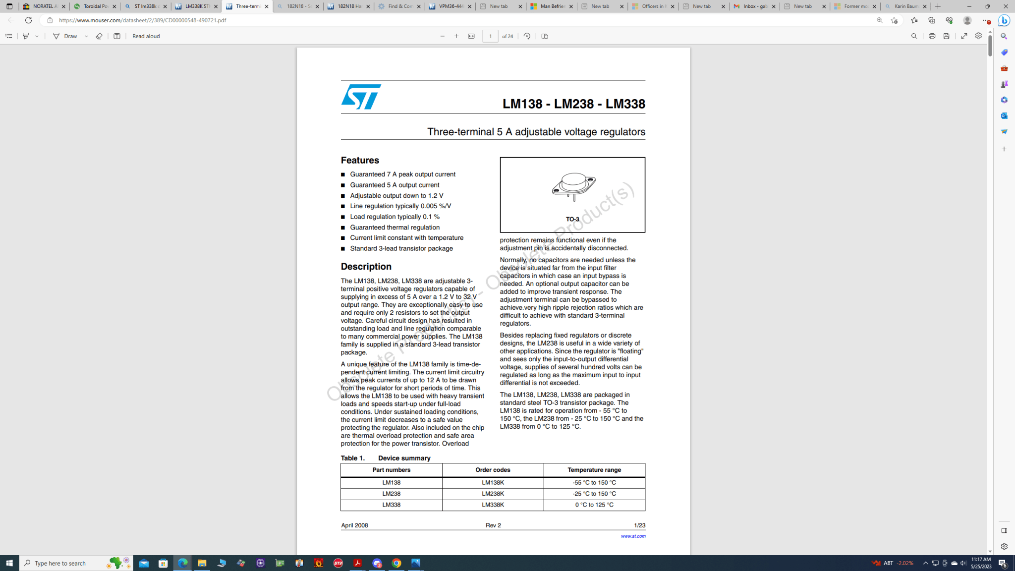

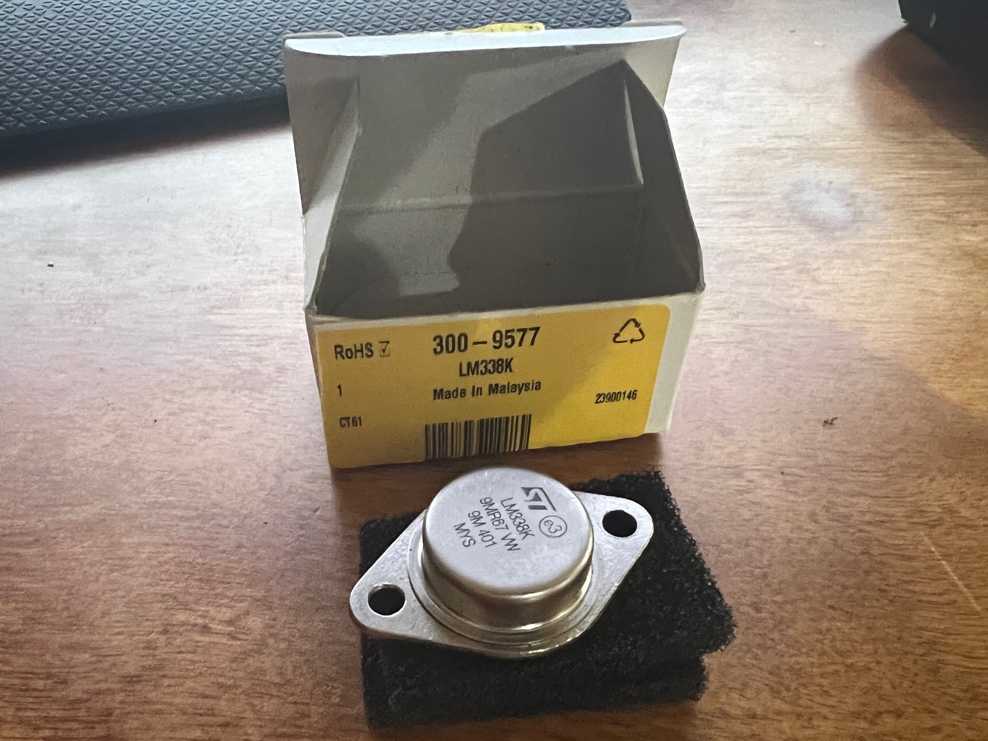

Thanks but I was aware of the datasheet and the K and P packages listed there.
ST and TI are listing their lm338 metal can(k package) as LM138k/338k, but Linear Technology does not( or I cannot see it)

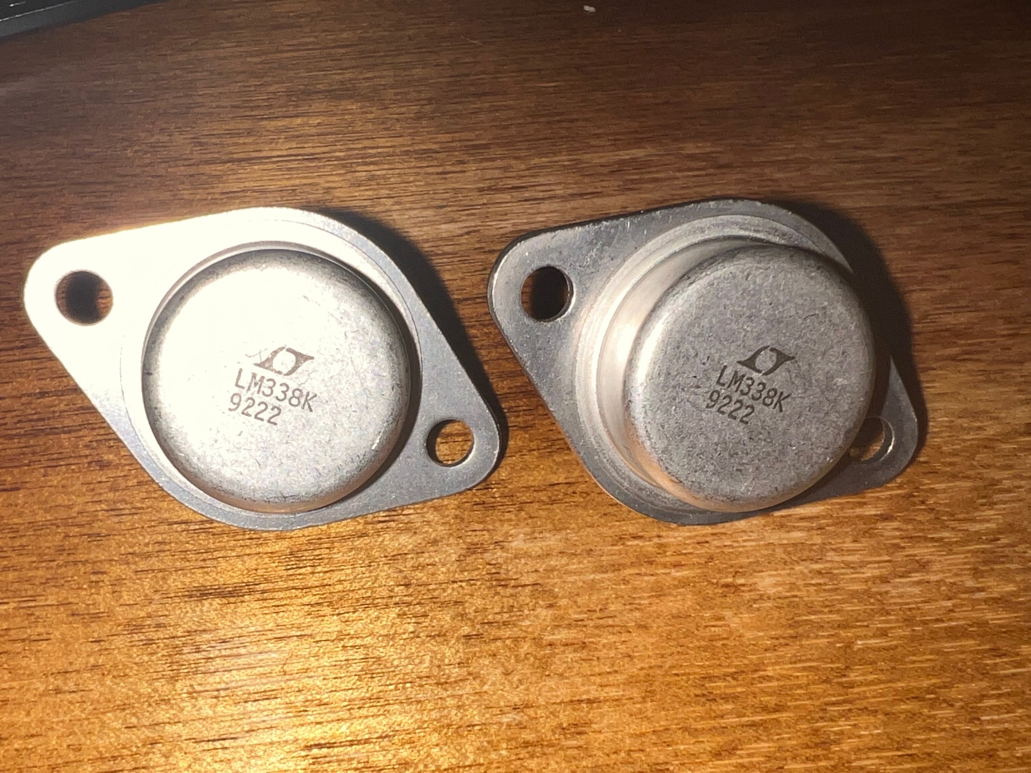

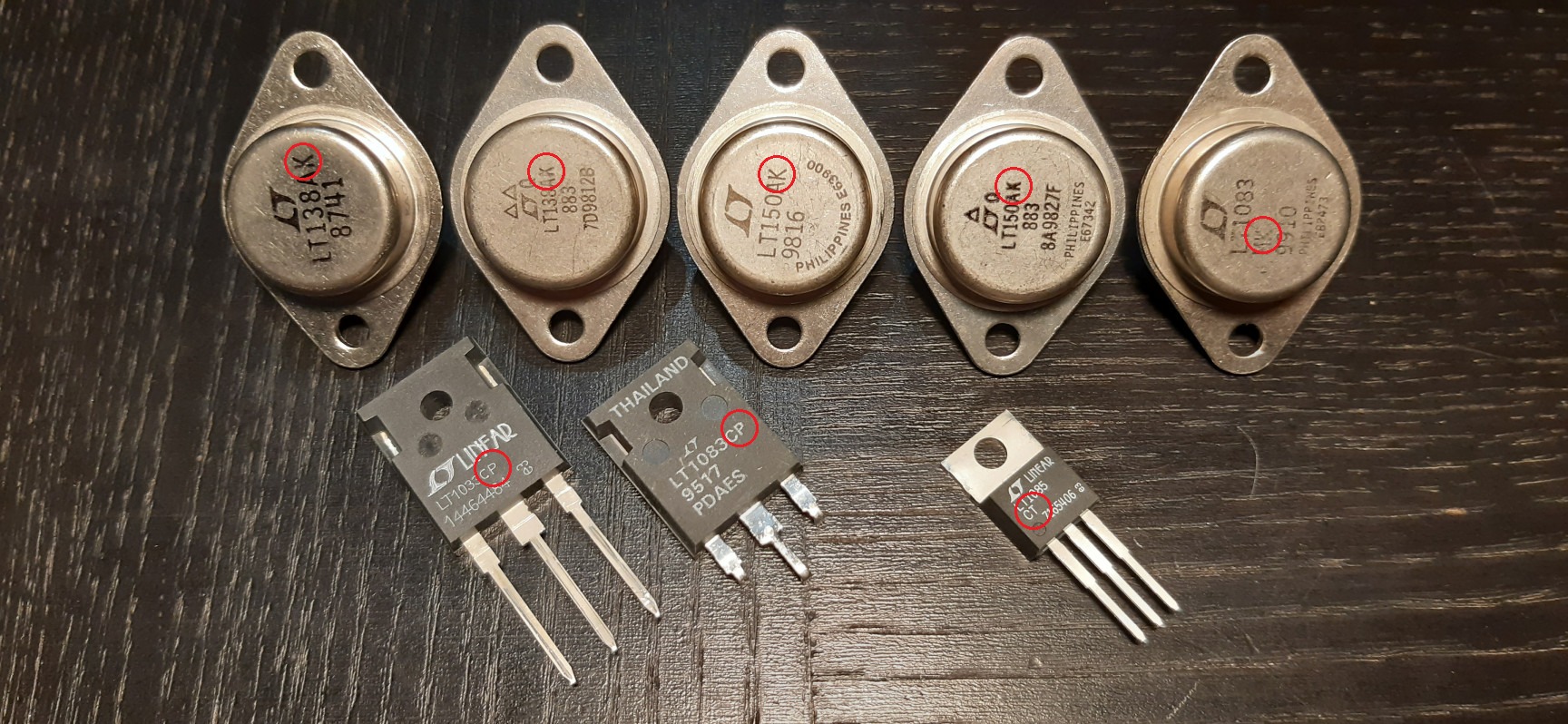

Sorry for the late reply - I wanted to take a pic of my LT regs, but that part of my stock didn't make it to our new house until today. I'm not aware of any document detailing the LT part marking convention, but - going by the actual parts I collected over the years from various trusted suppliers - the package designation letter is always printed on the case.
Hope this helps at least a bit...
