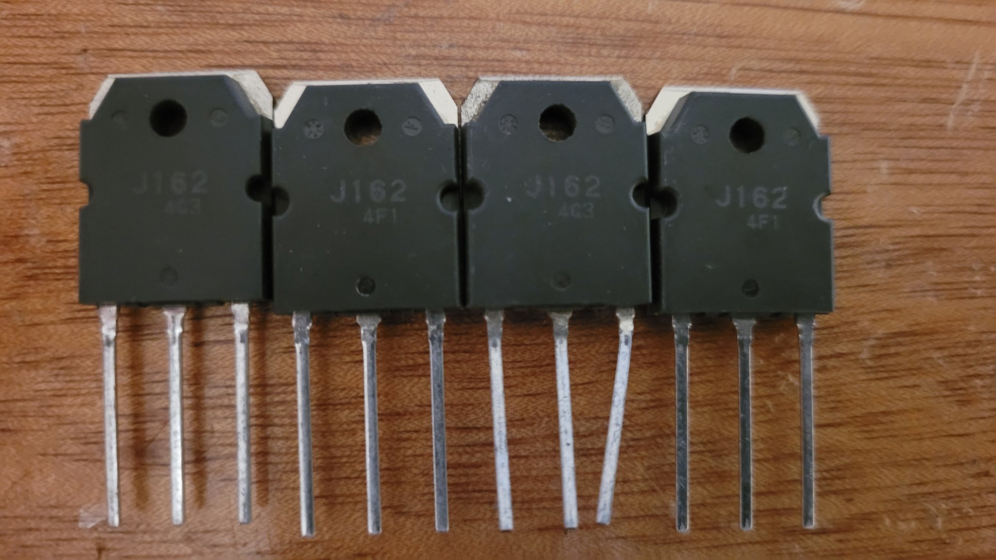

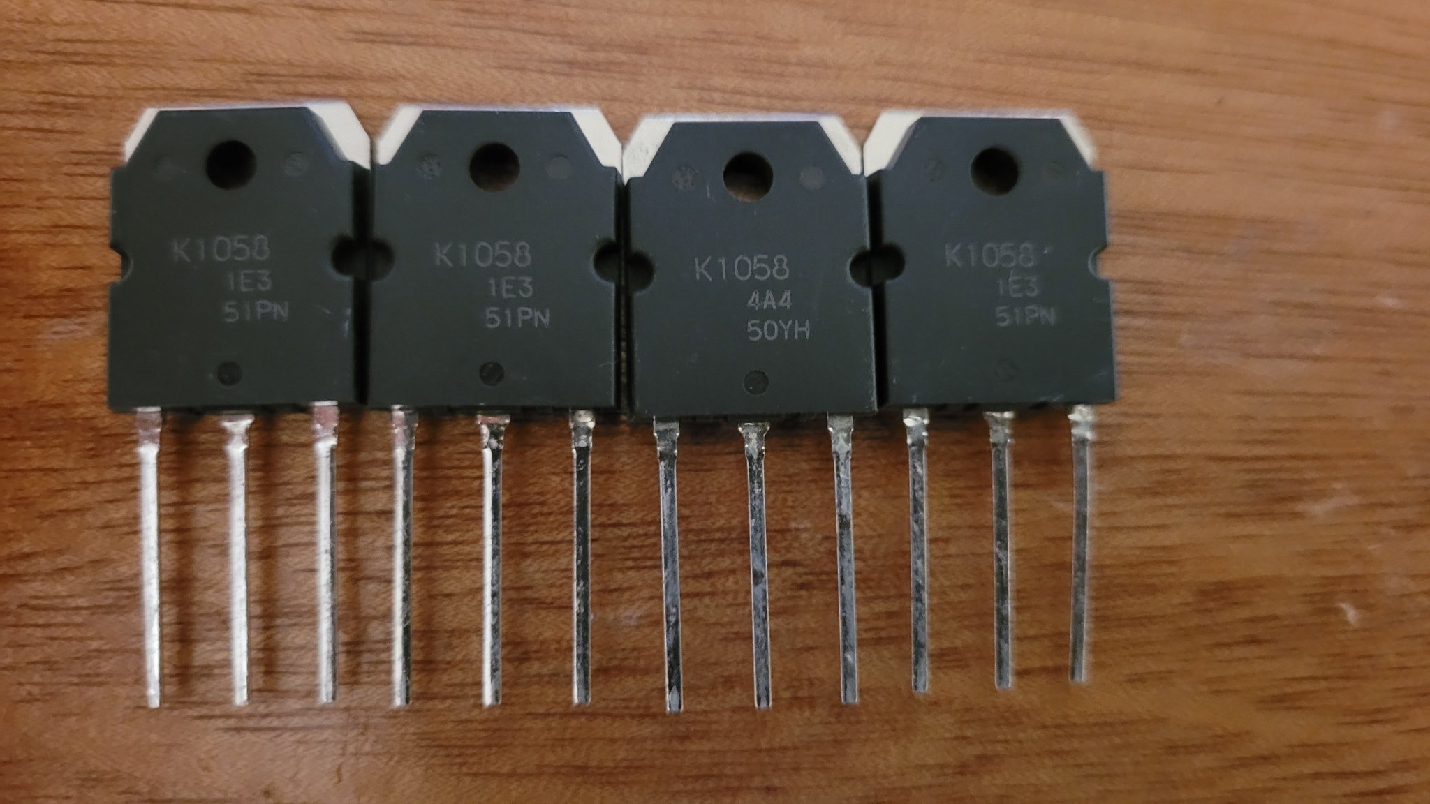

Have you tested them in a simple circuit to check Vgs is in the right ballpark and also that the G, S and D are where they are supposed to be?
If that checks out then you have a fair chance they are genuine.
If they are fairly new the brand will be Renesas. Test the gate-source voltage for small currents. The data sheet says 200-400 mV. A "normal" mosfet will have 3-5 volt.

They look good to me.Hi Guys,
I purchased some 2Sk1058 and 2SJ162 mosfets on clearance from a local brick and mortar store here in New Zealand.
Are these the genuine article?

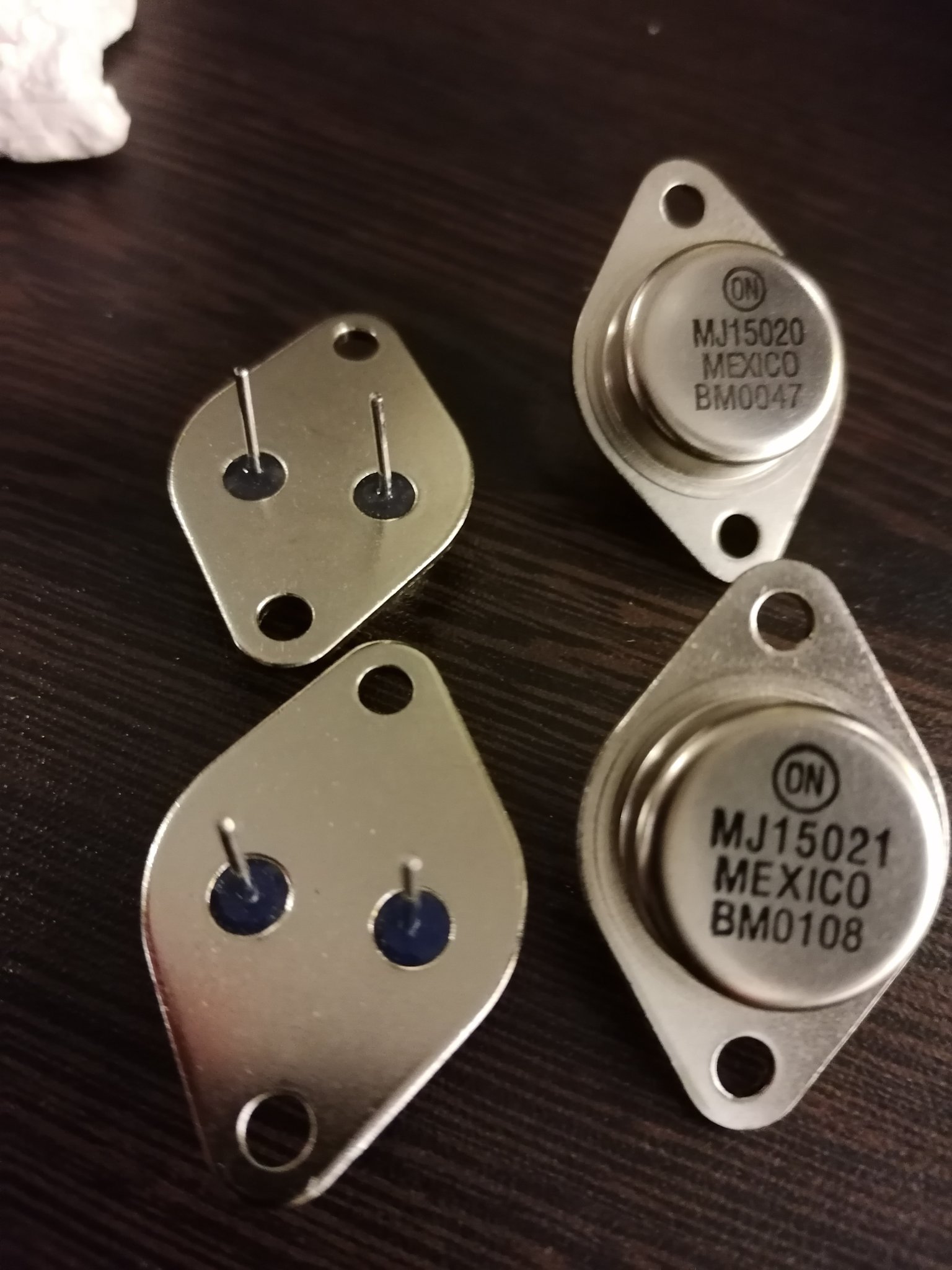

Hi again
I have managed to find two pairs of MJ15020 /MJ15021. Can you please tell do you think are they original?
Ivo
Ivo
Worth at least 5 bars of gold press latinum if they are real. They LOOK very real - exactly like ON normally does from that vintage (I have plenty to compare with and they are spot on). Nothing throws a red flag other than the fact that those types may have been discontinued in 2000/2001. I‘m not sure exactly WHEN they were. Possible they were a special run for a high end manufacturer (who might otherwise have used a house number) - getting them long after the rest of us couldn‘t. They have been known to do that for makers like Krell - there is precedent for that.
I wouldn’t do any destructive testing because they are rare. If they are fakes, the maker wouldn’t bother putting anything worth a damn in there. Just look at basic characterstics and look for signs of fakes - like a very high Vbe, excessive low current hFE, or input (base emitter) capacitance under about 4000 pF. If it “looks” bigger than a 2N3055 it probably is.
Thank you for reply. I have just received them and post picture. It is almost midnight here so I will do basic measurements tommorow and post results.
