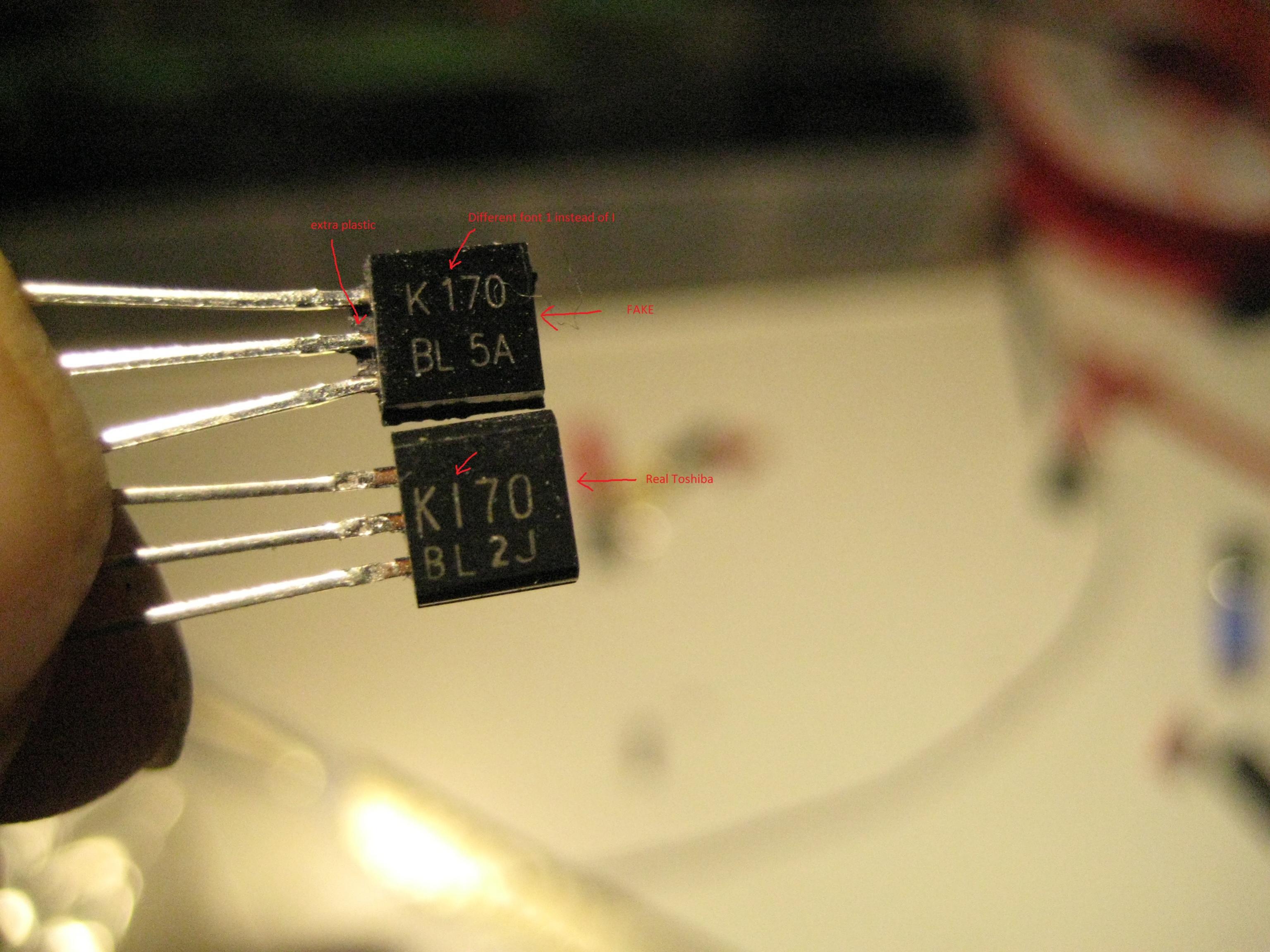

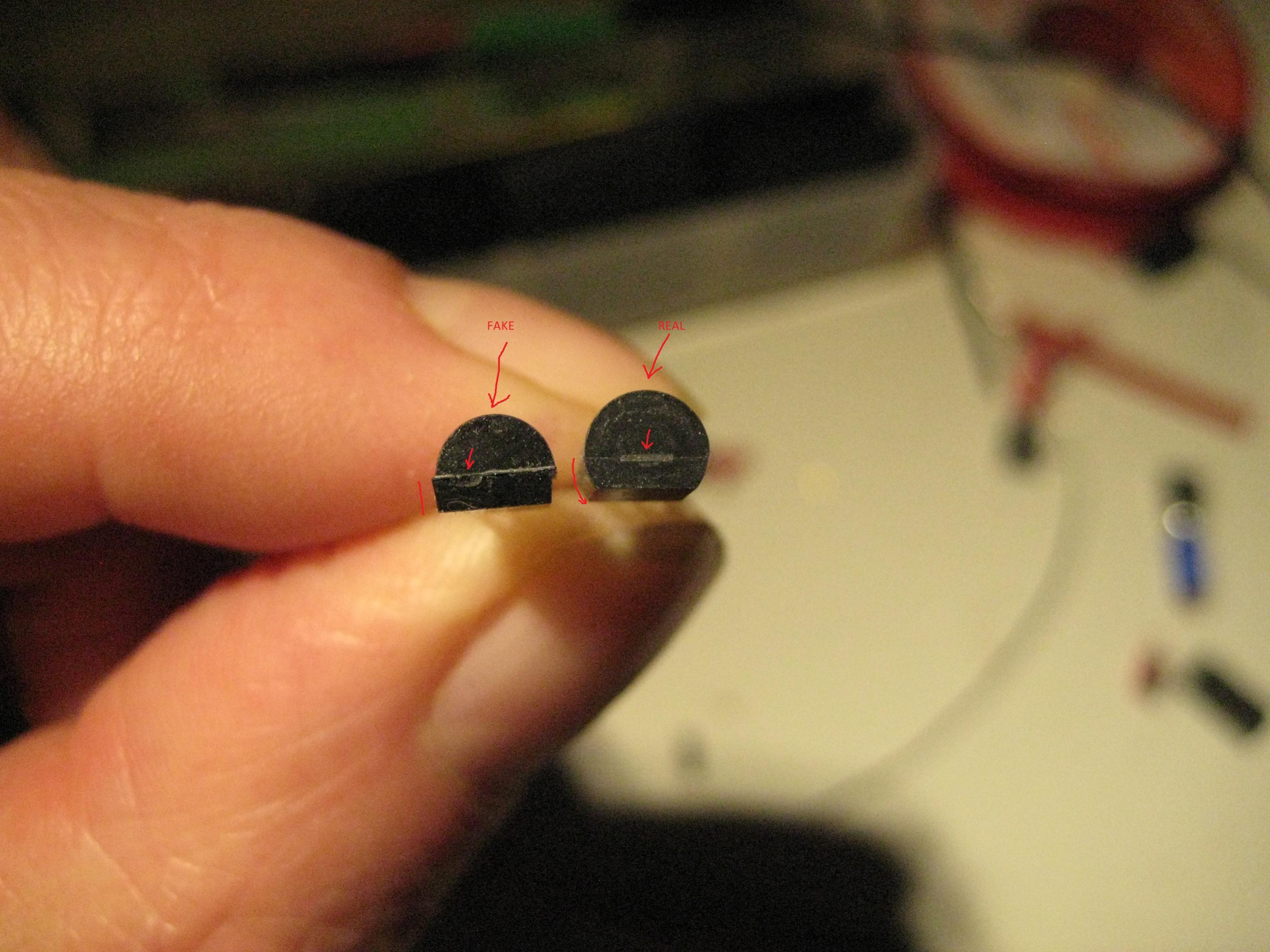

Bought 10 x 2SK170's from seller 'SZ Integrated Circuit' on aliexpress. All fake.
Asked for a full refund. Don't buy there. Picture they advertise with is from a real Toshiba, but they send you fake.
Measured Idss is between 14.0 - 15.5mA. Should be below 12.0mA for BL

Why bother with fake Jfets from Aliexpress?
Are you sure that these are original?2SK170BL :: Other Transistors :: Transistors :: Semiconductors :: Electronic Parts :: Banzai Music GmbH
0.96 euro?
Hi Pete,
That looks to be an original (good). Please let me know where you're going to buy them.
-Chris
I'll tell you through PM, don't want it to dry up.

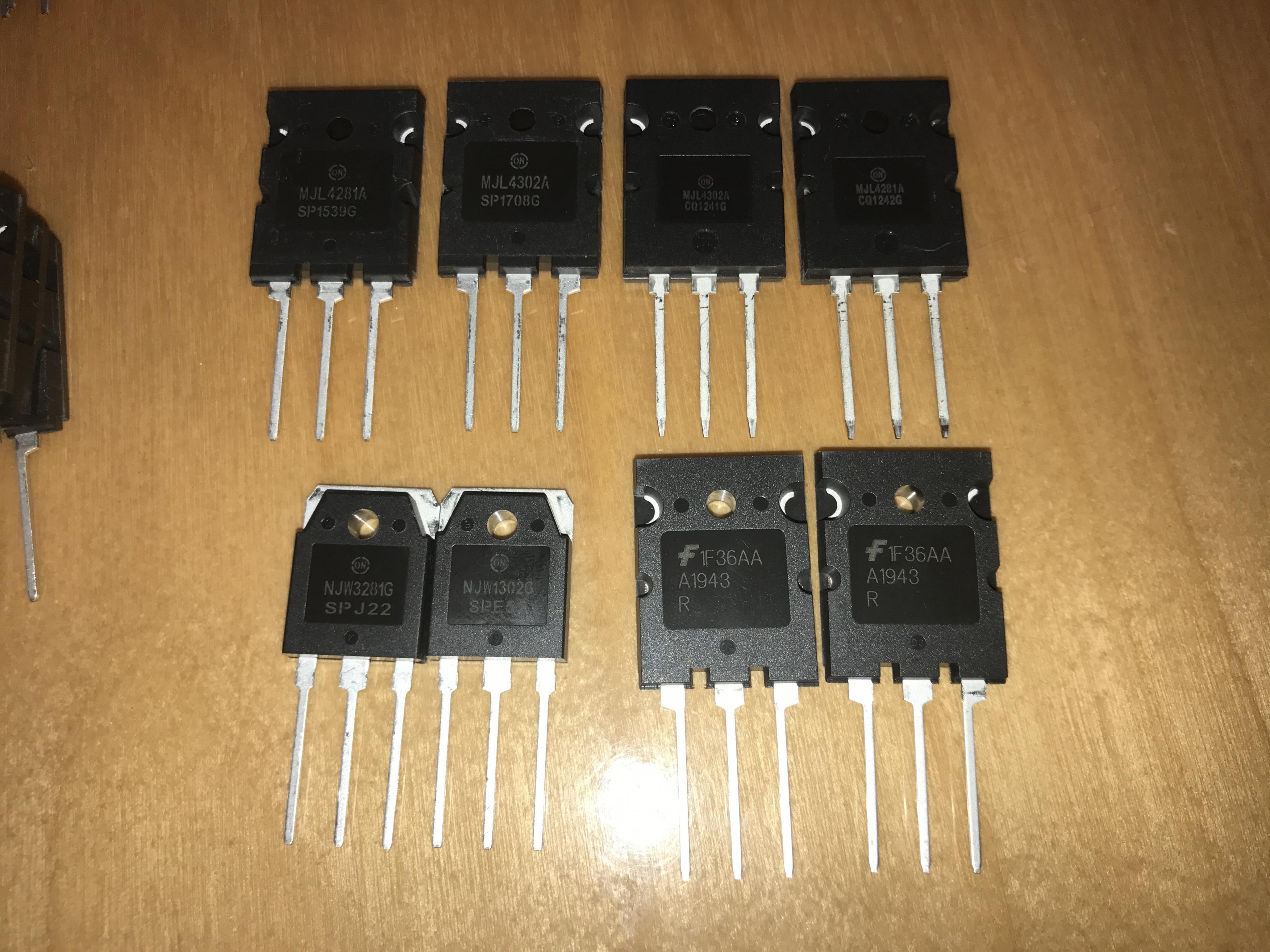

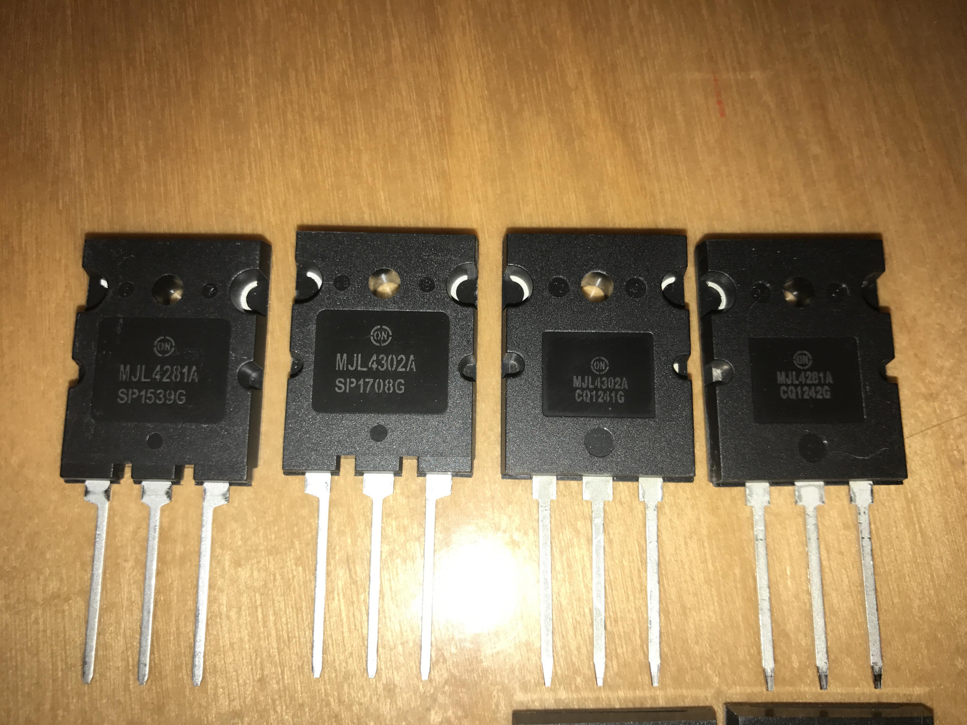

- My Transistors, original or copy?
