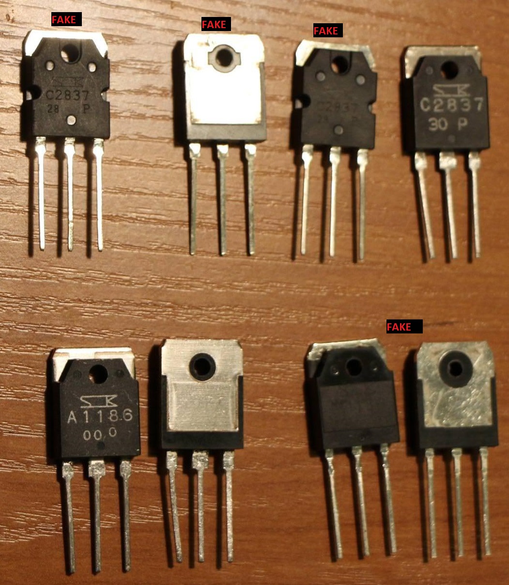

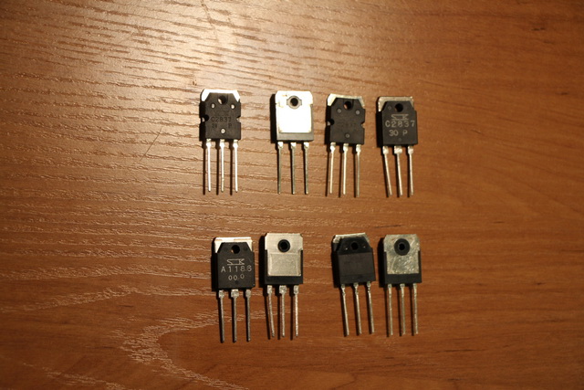

Just receive this from local store. All transistors looks different.
Photos made under different lighting conditions.
Is it fake or original?
Pins 2SC2837 is higher than 2SA1168 (the distance by datasheet from the heatsink should be equal to 1,7mm in both cases). Fourth in the upper row and 1, 2 in the lower row are more correspond with the size of the datasheet. The others do not match the width of the pins. Also strange marking of 2SA1186. The last letter corresponds to Hfe, but there are digits on this place. On the other hand, I bought it from a big local supplier. It's unlikely that it is selling fakes.
Crop photos:
Here's what I think about the package and mold. Compared to original Sanken parts that I have that are in TO-3P/MT-100 and MT-200 package, the collector lead near the body is wider than the base and emitter leads. The ones I didn't mark as fake appear to be the usual Sanken part. Now the question is are they not relabeled? The reason I'm bringing this up is that lettering appear to be inconsistent. If the surface is too shiny then, it was sanded off. Use acetone and see if the label comes off easily
Sanken datasheet is very specific on the lead dimensions, that alone is an easy way to weed out the obvious fake parts.
The next step is measure the Cob with 10VDC reverse voltage applied. Then run the part through a curve tracer.
DigiKey sells these parts. I trust them 100%. I also have a BIG local seller but they also sell fakes.
