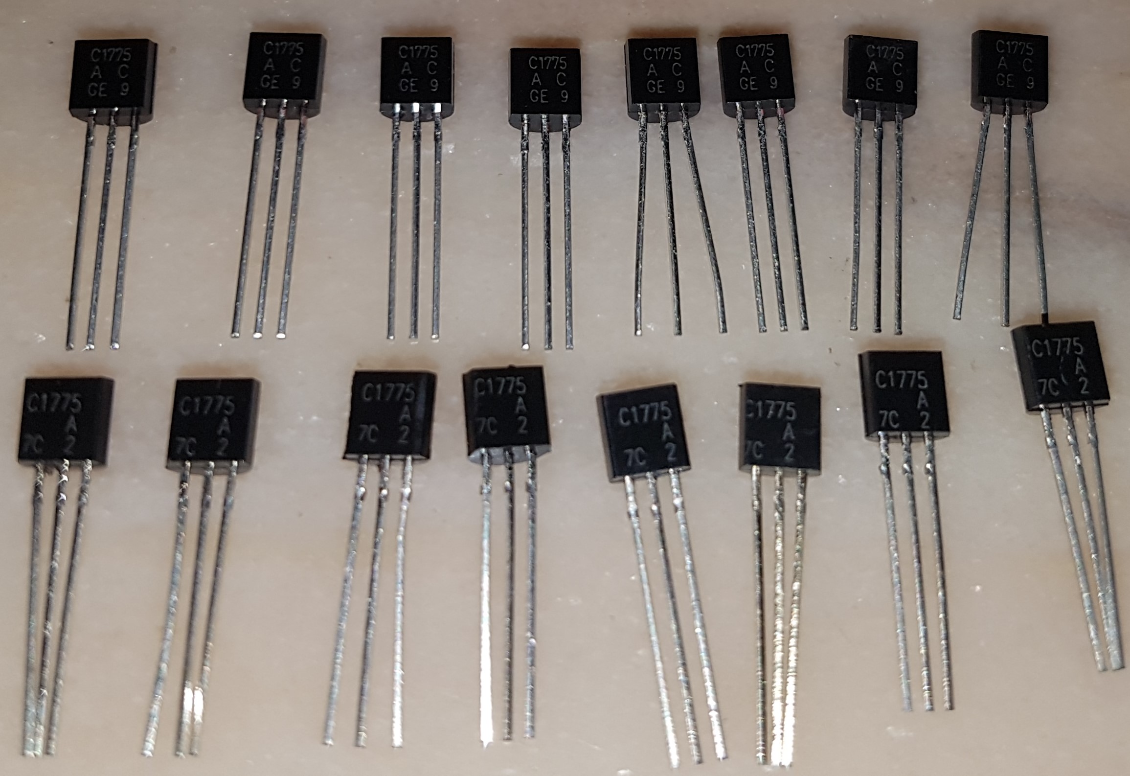

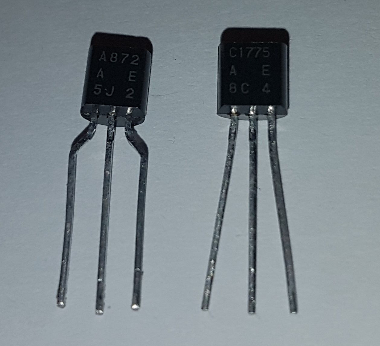

Fake 2sc1775 2sa872

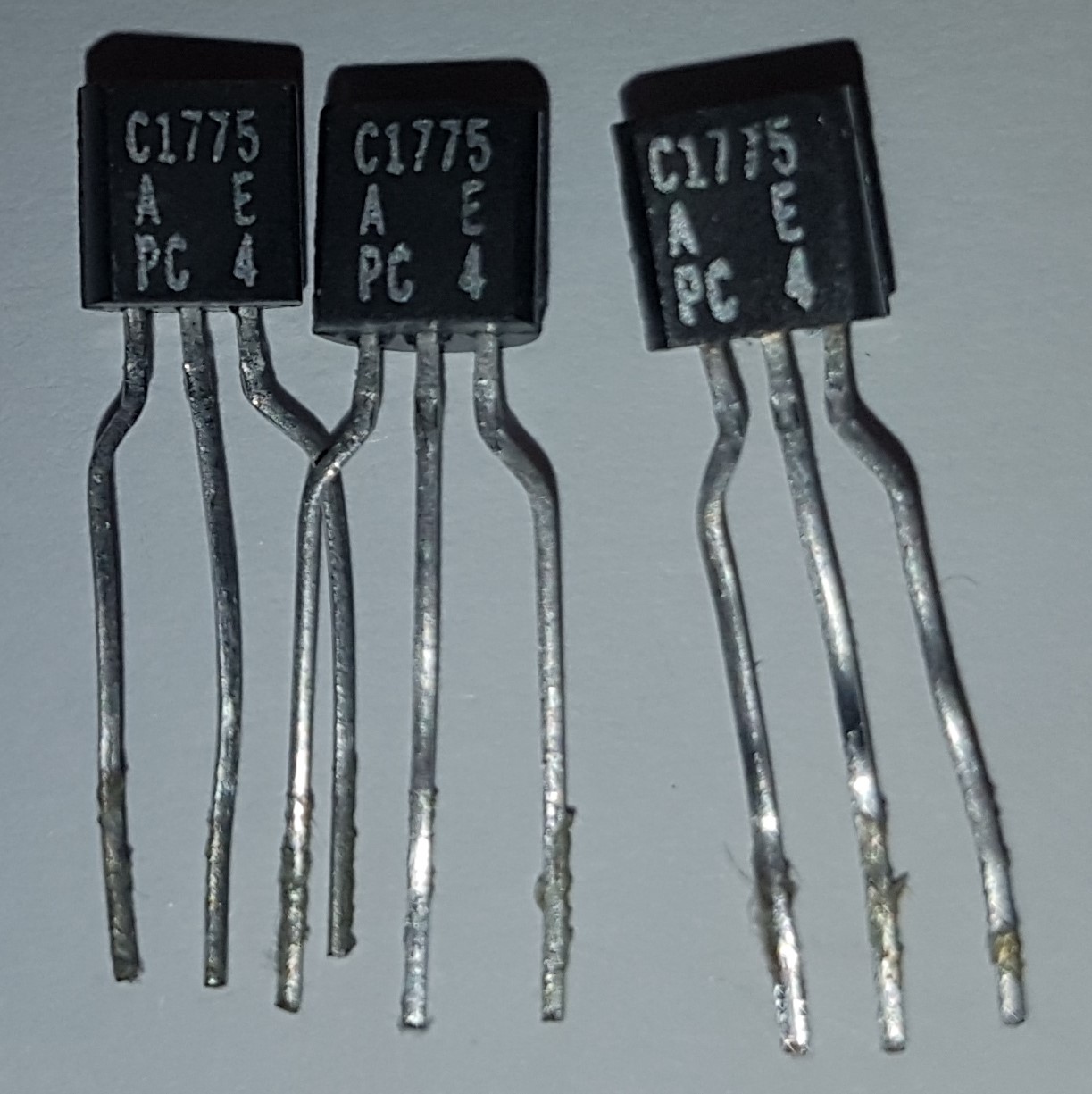

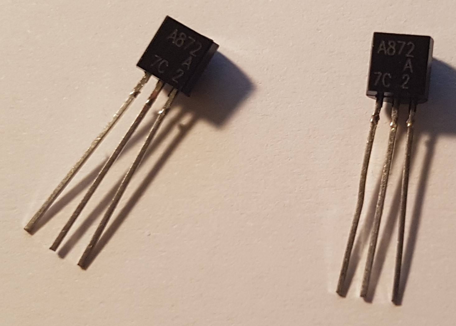

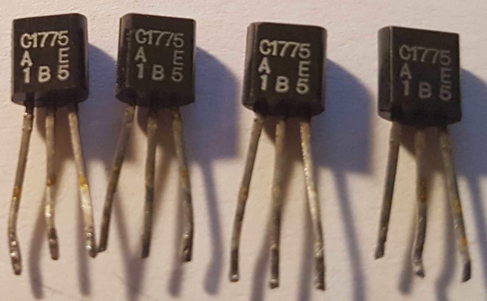

Hello to all.
I would like to share my recent experience with transistors that I recently purchased from two UK sellers.
These transistors are the 2sc1775AE and the 2sa872AE that I would like to buy to build an Hiraga Super class A.
The received 2sa872AE were genuine, while the 2sc1775 were counterfeit.
Both the 2sc1775A and 2SA872A have two hfe grades: (E between 400-800 and F between 600-1200). For both transistors either Renesas or Hitachi (that have different kind of printings among them) there are only these two grades of HFE and this is always printed on the transistor (if it is genuine) whether it is E grade or F grade.
In one case, although you just have to look at them to understand that they are fake, I had to make many measurements and photos to show seller who were fake.
In the second case it was necessary to measure them to understand that they are fake or out of specs anyway.
All the 1775 that I received, have a HFE between 260 and 340, really out of specs for the E grade.
About the 872, 14 of them have HFE between 430 and 450 (that meet the specs) and two of them have 330 (out of specs and anyway different printing respect to the other 872).
Here some photos.
Best Regards!

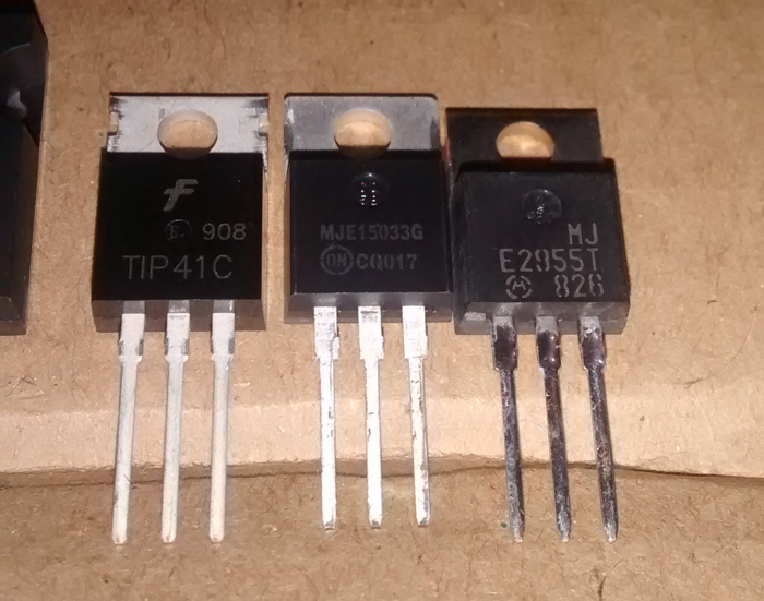

Hi Guys

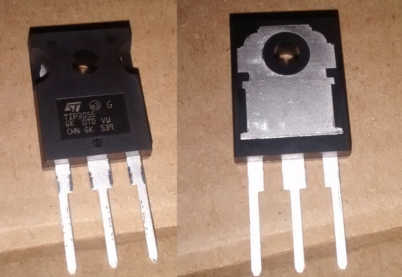

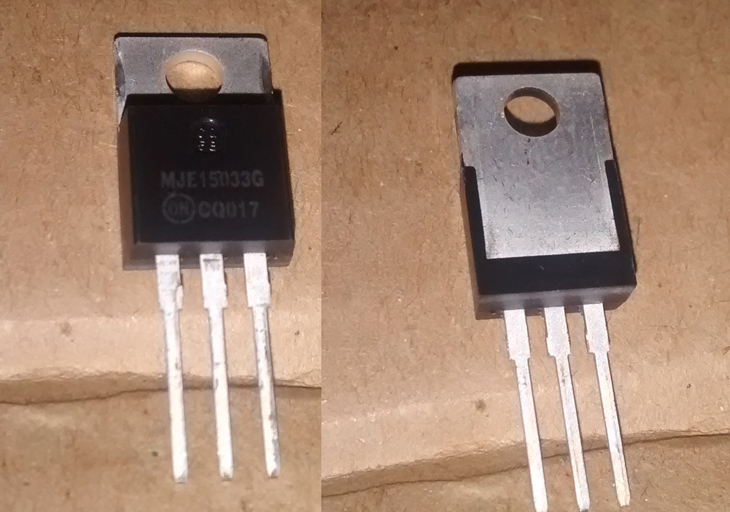

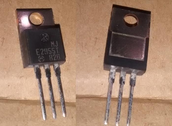

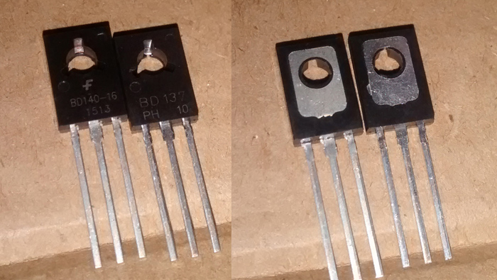

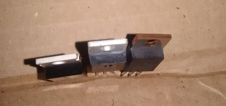

It's me again hehe. I tried buy some transistor in another store here in Brazil let's see the results:
I have serious doubts, the BD140 by Fairchild really have the fairchild logo ?
The TIP41 TIP3055 and MJE15003 has silk look (Matte) both in the tab and in the terminals
The MJE2955 look like fake, the tab are "copper color", and is very shine (Tab and Terminals)
Some Opinions ?
Thanks ! (Sorry for the english :smirk: )

All those transistor types are generic enough that the risk of fakes is less than 100%. The 2955s look like an old non-RoHS version. They still have the old Motorola logo, so it's possible. Compare the die inside it with the ST TIP3055, they are probably about the same size.
These are the kind of parts you actually find inside fake ON's, Toshibas and Sankens when you buy such on E-bay. At least if you find them in a store, you can just sacrifice one before you buy any more. You may find a 1mm^2 2N2222 die inside a device marked TIP41, but it's far far more likely to find a TIP41 die inside a device marked C5200.

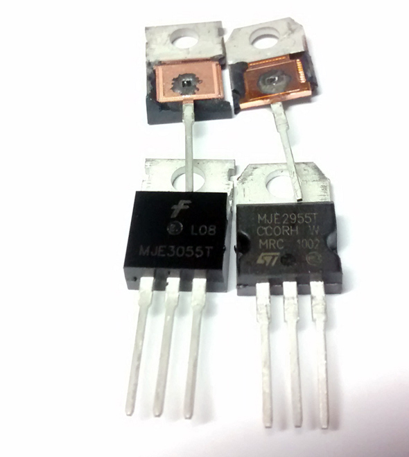

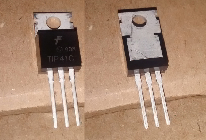

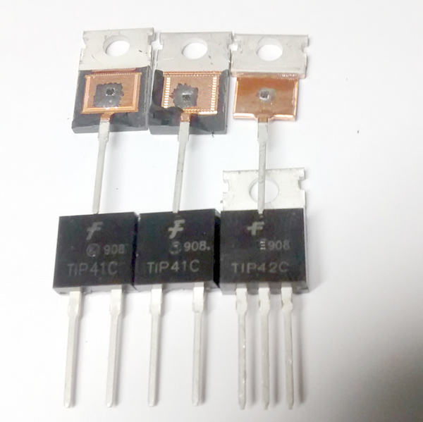

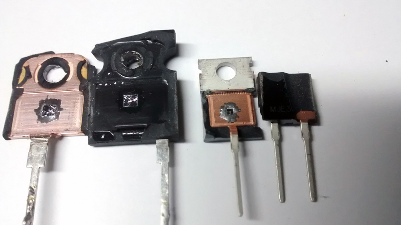

I don't resisted, something was weirdo about some TIP41 that i bought in 3 diferent local stores
The Fairchil logo is diferente in this 3 types, all with the same data code..
Opening them i saw a little bit differnce, in de left, the possible real one, in the middle the die isn't centered, look fake fairchil logo. In the right, weird fairchild logo again..
Some opinion ? Even TIP41 is being counterfeit ?
About TIP3055 and MJE3055 in the second image. the die is quite different.
Now MJE3055 Fairchid vs. MJ2955 ST. The same die size...
I'm realy lost.. 🙁🙁🙁

Those dies are all about 2mm on a side, properly soldered to a copper base. That's the way ther are supposed to be built. I wouldn't say that any of them are fake. Fairchild and ST both have plants all over the place - so the laser markings can get inconsistent. And the specs on those generic parts are very loose so they may not even be the exact same die from plant to plant. And certainly not between different brands.
