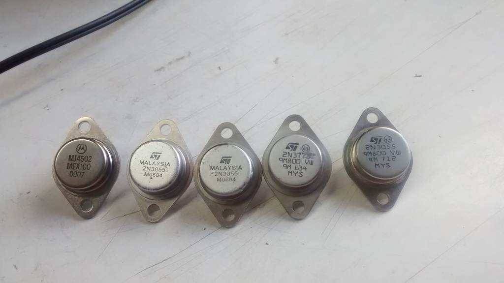

Hi everyone (Sorry for the bad english, but at least i'm trying hehehe)
Here my attemp to find some real TO-3 transistors here in Brazil, each one was buyed from different stores.
The MJ4502 is the heaviest from then, the "Malaysian" ones seem's like fake.
The MJ4502 have a thicker tab and the terminals have a finished and round tip
The other have a "cuted" end

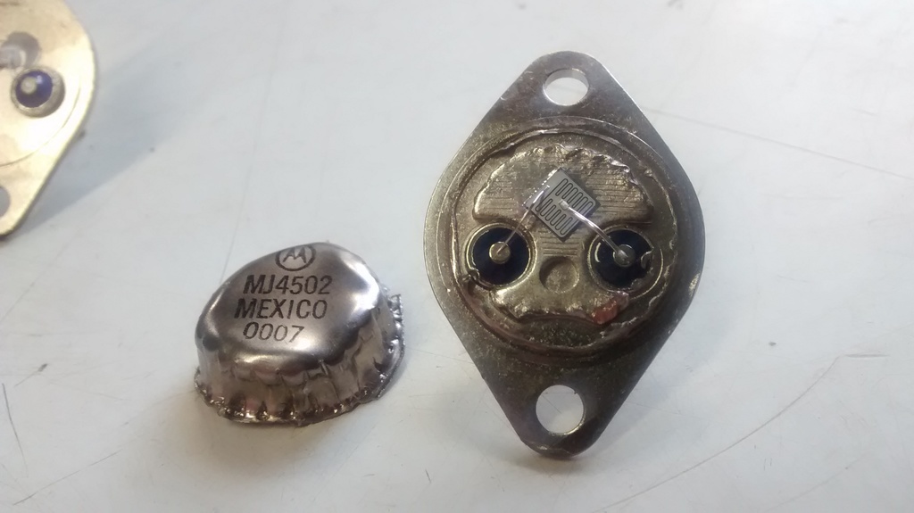

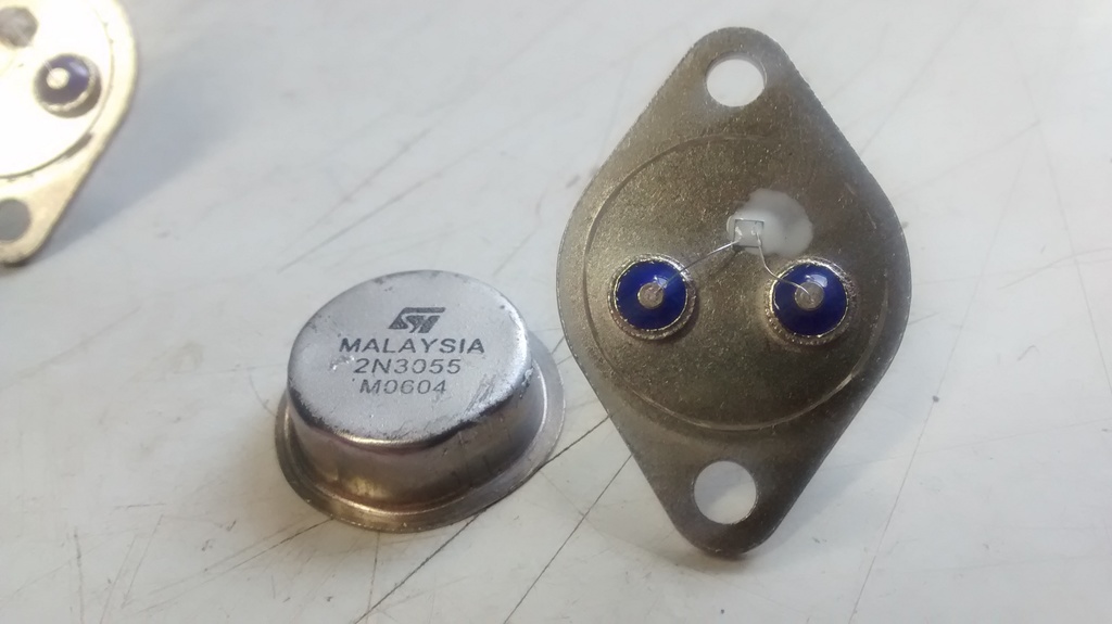

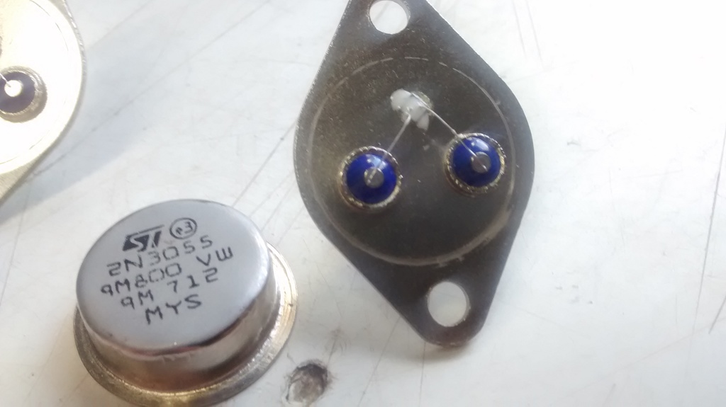

Was too easy remove the cap from de 2N3055 and 2N3773, but as showed in the photo, was very difficult remove the cap from MJ4502
Is it very difficult to find 2N3055 or is it that the new ones from ST really are with the painted cover?
What are the minimum size of the die ? those of the photos are between 1.6 mm and 1.9 mm and the MJ4502 is about 4.5 mm

The 2n3773 is fake.
That die is about 20% of the size it should be.
There should be a copper slug similar to the 4502 at the end. You should be able to see the copper on the outside.
The copper slug in Toshiba from circa 1980 is even bigger than the MJ4502 shown.
The MJ4502 looks it might be genuine.

All false except last motorola one, the wire to the die are sooo thin, needs to be as last one, and die is much to small, the 3055 are also not oke.
ST quit making 2N3773s a long long time ago. And I think they have even quit making metal can 3055's as well (still make a TIP3055 TO220). And when they did make them, the lids were just as hard to get off as that Motorola. Unless it's old and you can't get the lid off easily - stay away.

The 4502 looks real. Others, die looks smaller than the Toshiba 3055 I saw a couple of decades back...
Thank you so much guys !
I think MJ4502 is really genuine, i'll try buy more of them this weekend in the same store (physical store).
Now I really want some original 2N3055, it's very hard to find them.. Always this painted gray cap labeled as "ST"...
