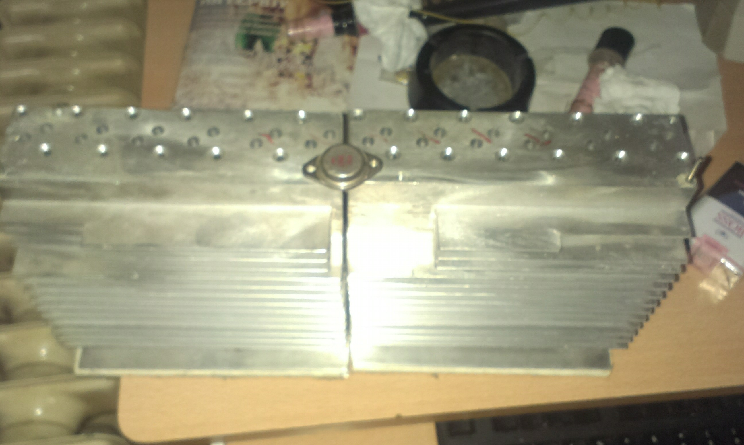

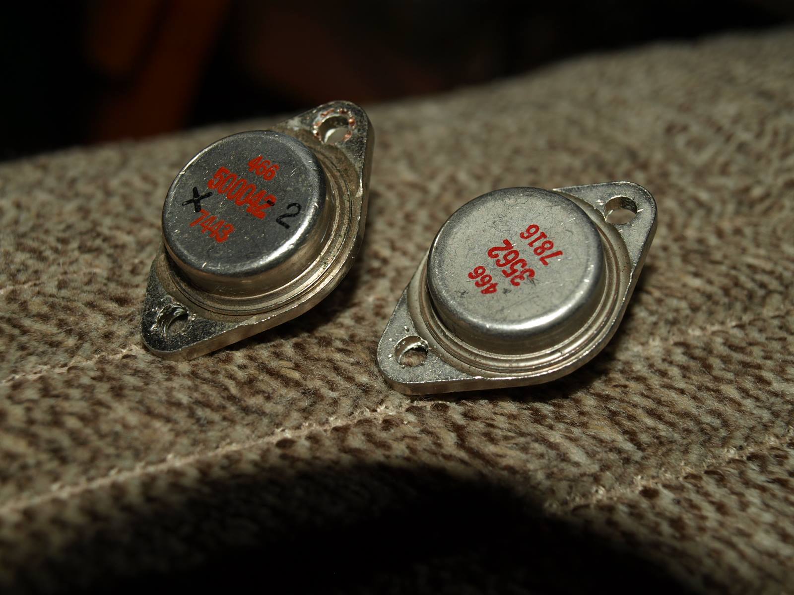

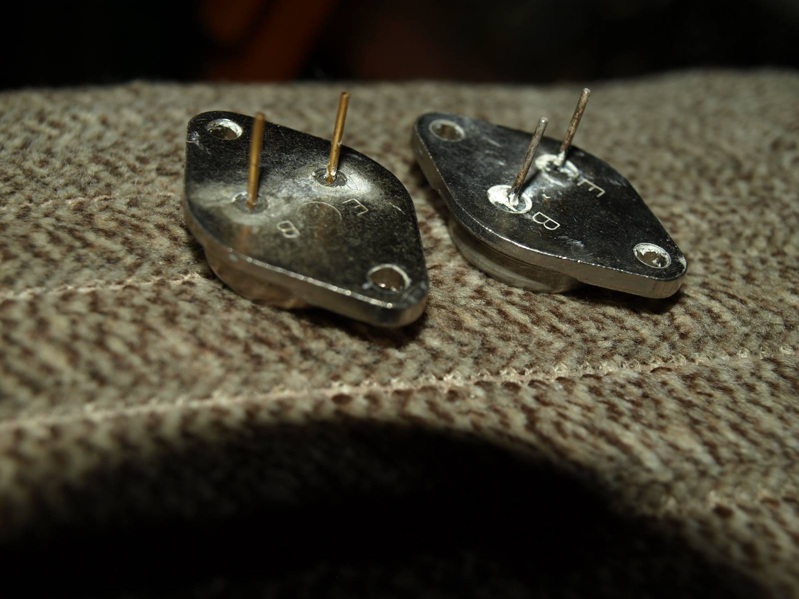

Question
Do You have any idea what could be those unknown parts to me?, any specifications, or data sheet?
Those are called "house numbers". These are used by companies when they either need to specify a transistor with certain parameters, or in the dark days of service, when they actually tried to hide what parts they are using.
You can do one of two things with those. Find a schematic for that piece of equipment and determine what the lowest possible rated device they would have been and use them in a project in a similar set of voltage and expected currents, or discard them. Personally, if I can't identify a part, I discard the thing as it is basically useless. If it failed in your project, was it being used beyond it's ratings, or is there something wrong with your circuit.
Do not use them to repair a stereo !! Especially not for someone else !!!
-Chris
-Chris

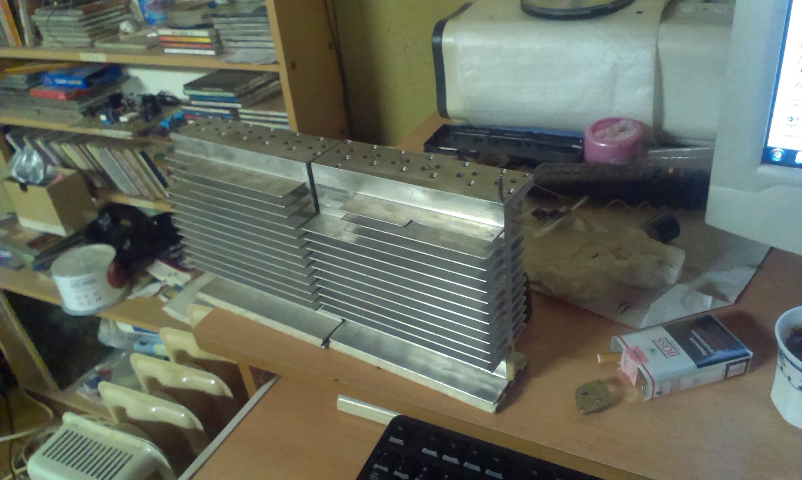

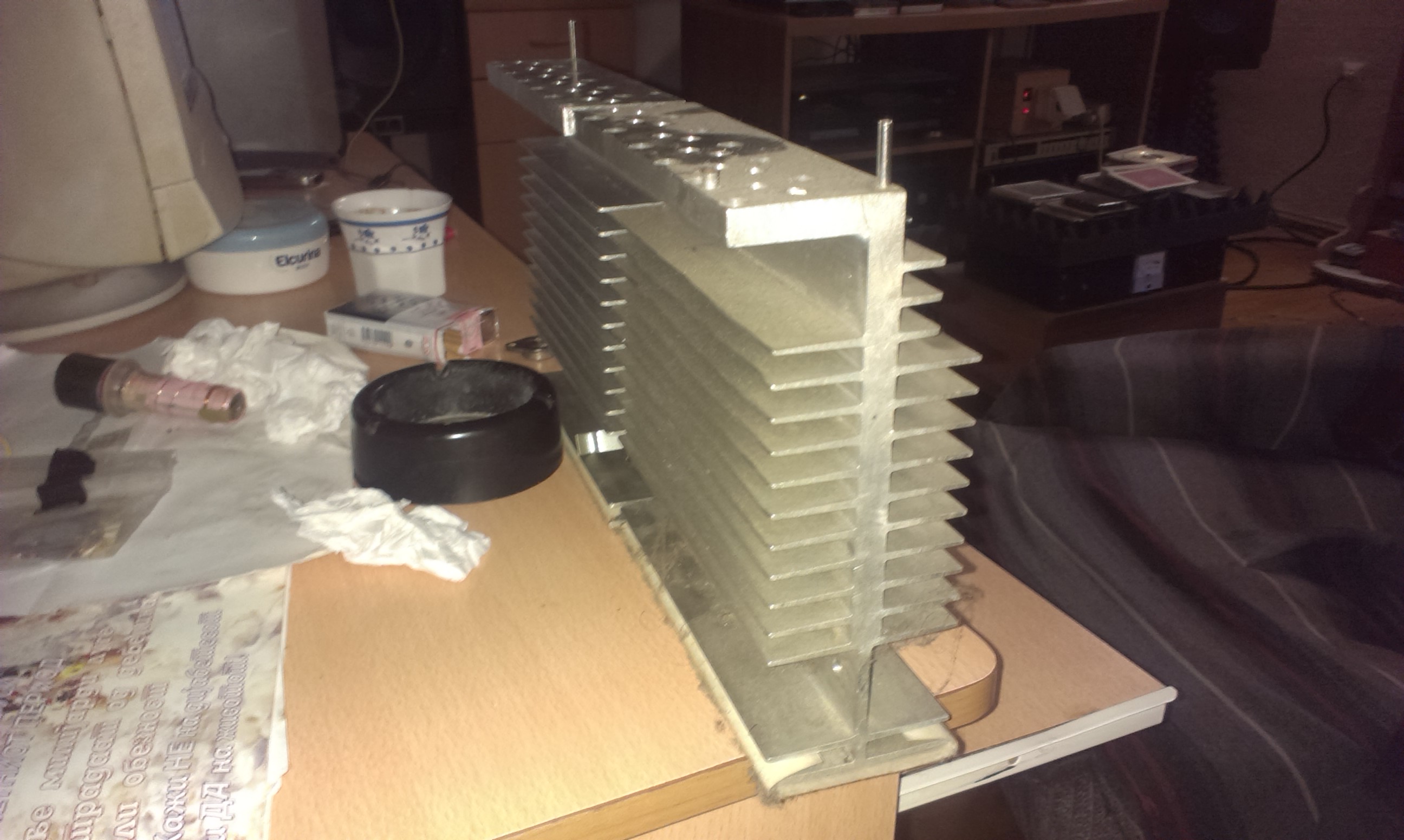

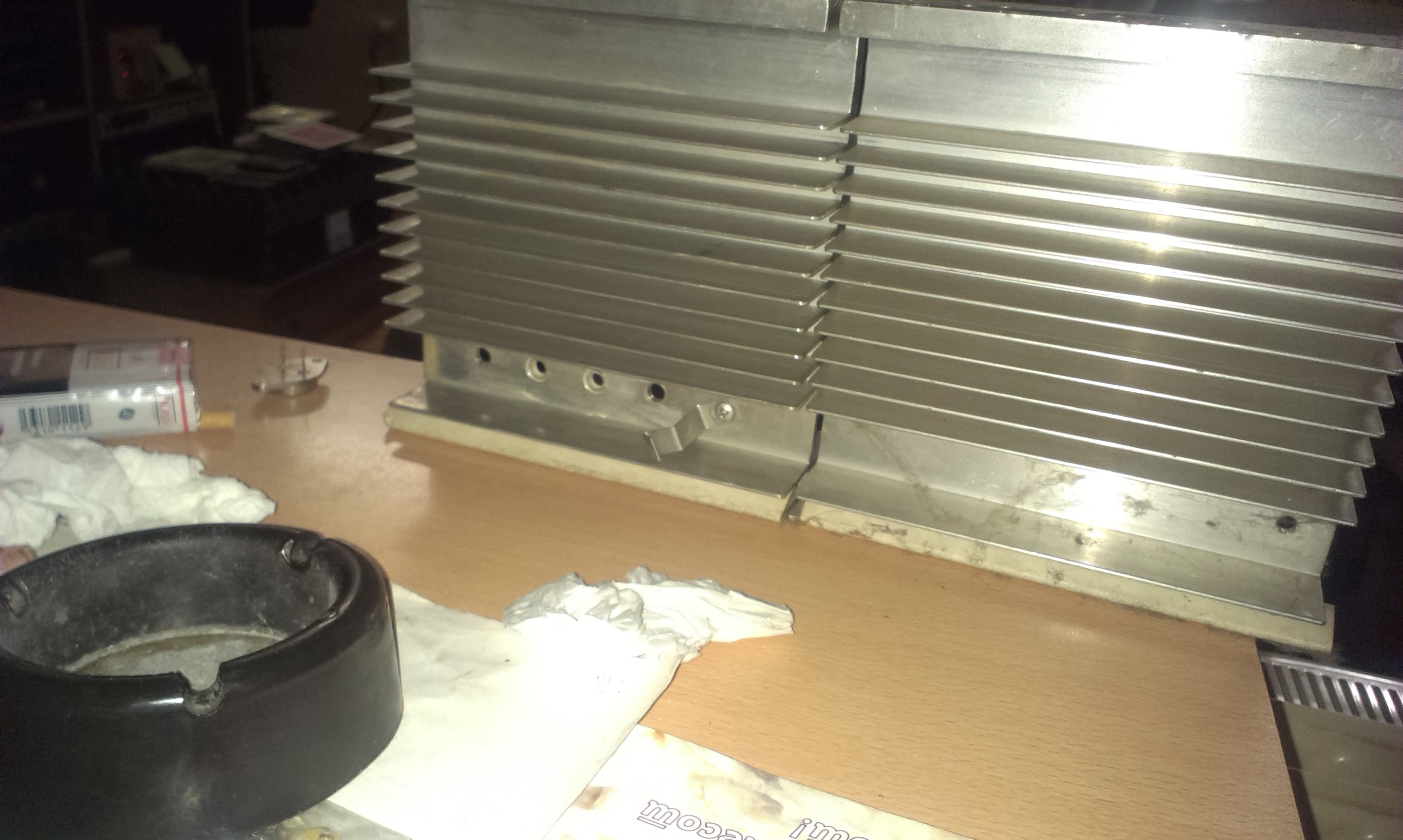

They came fixed on a massive aluminum heatsink around 1cm thick at fixing area, and i have no idea from what a device were used in.I've seen a potential usage of that alu. heatsink for an amplifier, and now wonder if I can find them a place in anything..according their data which i can not find it according to their titles 😉.Btw they are all original and perhaps from IBM vintage pc or server things american made because of some big elkos caps general electric came at the same time with that aluminum.
Anyhow thank You for your spent time, and perhaps someone else might find useful data for them, even if not..they will rest for sure.

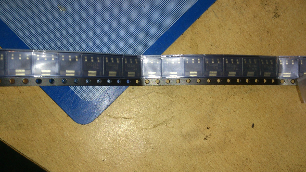

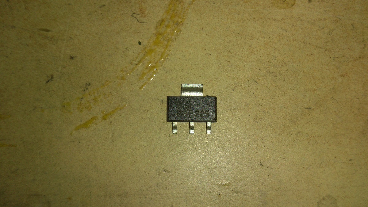

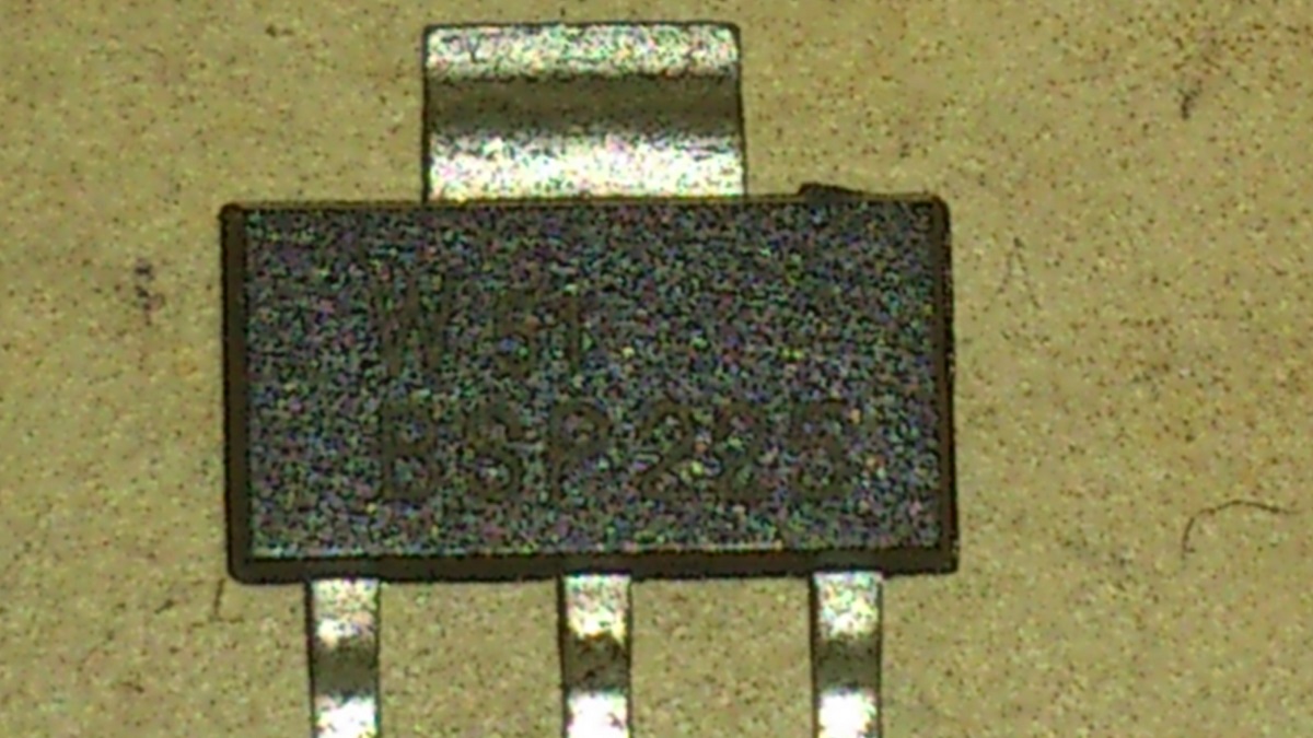

Again some transistors who i do not now if fake or not, but she are different then on other photo,s, it is difficult to tell, she came in protected package from wheel. Also difficult to solder, need to get to long before it do.
I do have experience that with ebay there more fakes as with Aliexpress, seems more secure and remove those who sell fakes.

Hi kees52,
Welcome to the lead-free solder world. You need to use a higher temperature for starters, and some liquid (electronic) flux would also help a lot.
-Chris
I have still the older lead solder, still not out of it, but when it is yes I need updates.
These transistors are just without solder so it have to do well, maybe some oxidation on the pins do trouble, I have clean that and it do work.
My solder iron can get high enough, for weller just a simpel upgrade.
regards

If your info is correct, the transistors are probably output types for car radios.
Possibly germanium such as OC35, AD149
Check with a transistor tester![/QU

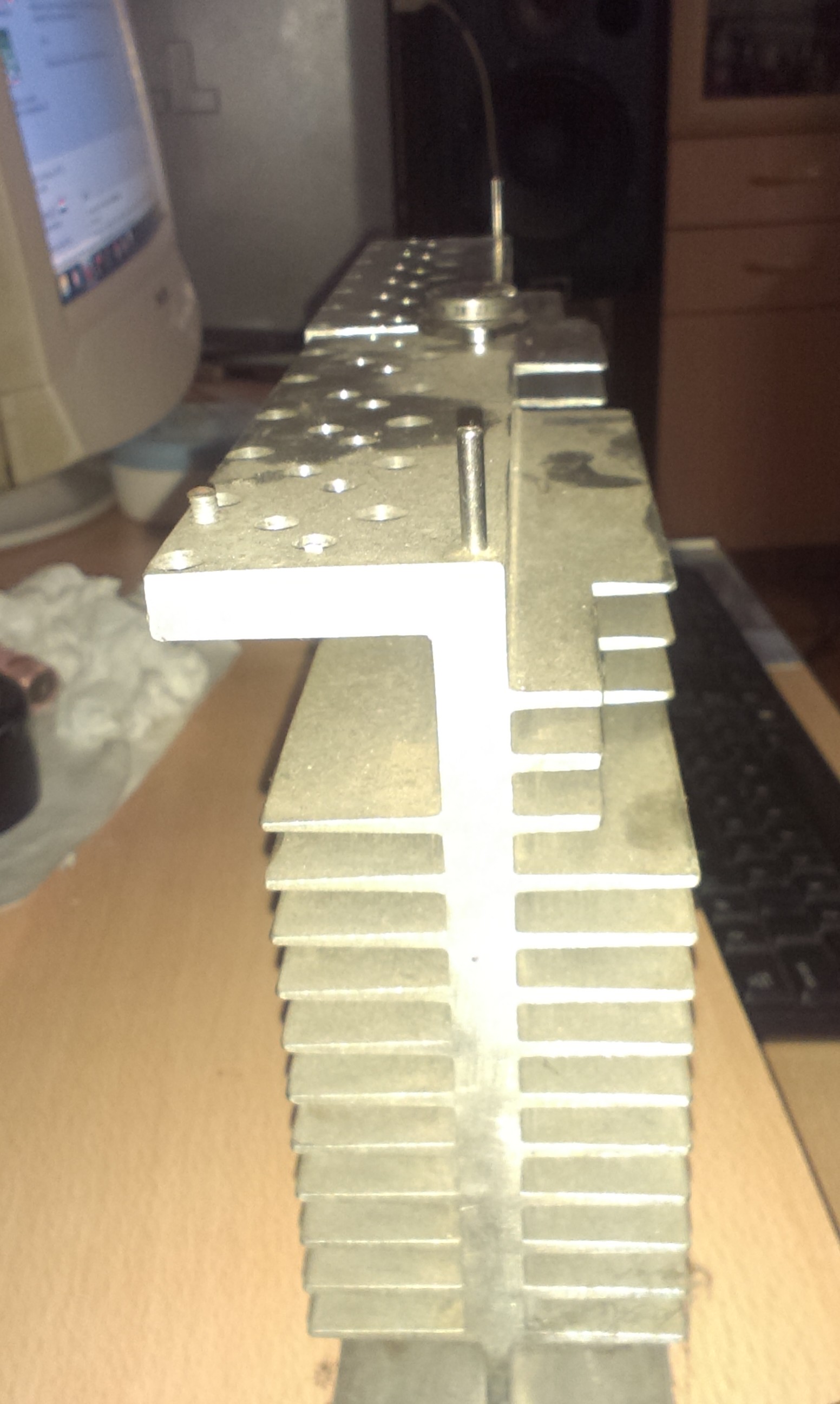

probably no, no way car radio, 12 of them bolted on so heavy aluminum heatsink, the reason i bought that thing, both transistors are npn type and look so powerful, bolted on 1cm thick plate alumin with wings which i have halved at half eheh for stereo, year of manufacturing I suppose is mid 80's , not sure, thing from a bank or similar, if i knew would not ask for data, even if knew, you see that is hard to get data for such left numering.
just took sum photos if possibly can help to identify this crap""
