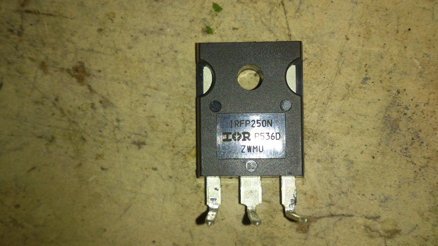

Hi There
I have been busy with X on a circlotron, however the amp do have a uge temp run away on the IRFP250N mosfets, the strange thing is it run out in just a few seconds to a idle current of some amps and blowing itselfs, like what happens with X
In my opinion, a mosfet temp runaway who go so fast the tracking transistor did not track it means the silicon get hot very fast before the mosfet housing do>?.
I do cool the amp with a fan, it stays quite stable on 500 mA but when I do take the fan away it do drop to 120 mA who do prove the transistor do work and is overcompesated, but it do not track on time, the irfp heats up so quickly inside that it is already in the amps region before the outside of transistopr body gets hot, very strange, It looks like a igbt I did have in past who has the same behavior and was not a solution for, the elektor amp.
Here pics of the mosfets, maybe she are not genuin but then very good made.
thanks.

the case and heatsink heat up slowly as it has a large thermal mass. I saw large differences between plastic top temperature and case temp. so maybe better to glue the temp sensor directly on the inscription side of the fet. the sensor should have a low themal mass not a large metaltab type transistor.
I have a bd139 on the bold, glue it is maybe not such good idea because when it looses amp blow up.
Then there is thermal resistance between the case and the silicon , for 30 amps mosfets these need not to heat up that quickly causing very fast thermal runaway.
I however did als discover the J310 casoded current source in lpt do warm up giving a run when cold. so I need some work to do.
thanks for advice.

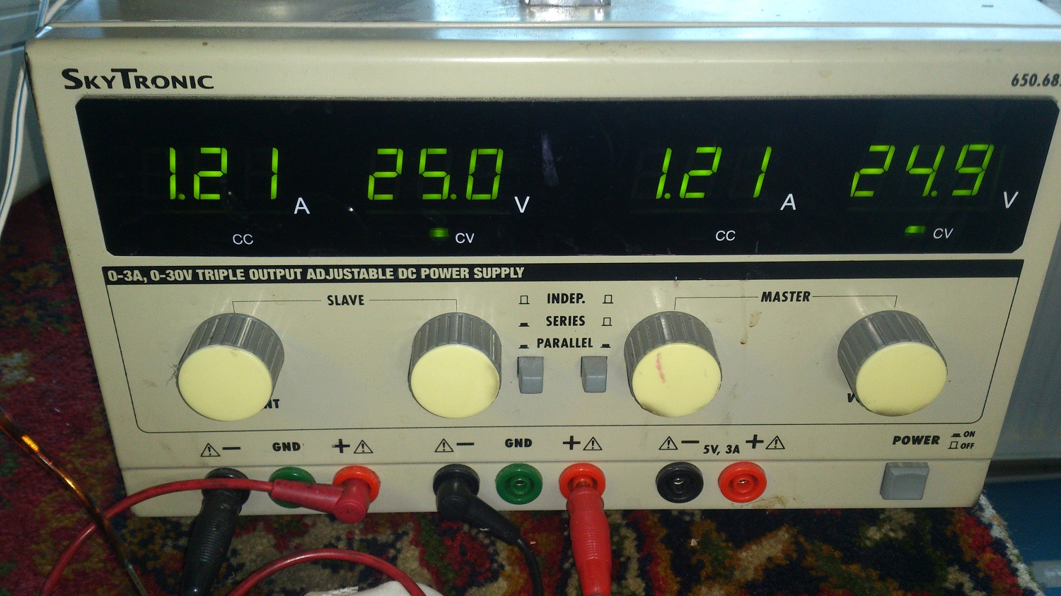

I have removed the irfp250N transistors and put in irfp240N transistors, now I have not a problem with my design, it is quite stable on 1.21 amp class A current as X want, I go lower.
When start cold it has 720 mA and steps up in 50 seconds to 1.20 amps and stay there happenly.
These transistors are or fake irfp250N or these are not happy in a amp, I think it are fakes, I think it are or faulty ones or igbt,s who has the same behavior as I have experienced in the past.
The silicon can be bad set on the case so cooling it down do not work well causing it to heat up fast and so it go jump high in seconds.
What I did experineced with the irfp250 was that it just sometimes jumps from 420 mA to max current of supply and was 1,3 amps, in just a second, then it jumps back again etc.

He he the amp has a fake mosfet or reprinted igbt, sadly, I have not originals and these do fine.
Various makes of the same part and even newer design generations from the same make can behave very differently in threshold behaviour, especially temperature coefficient.These transistors are or fake irfp250N or these are not happy in a amp, I think it are fakes, I think it are or faulty ones or igbt,s who has the same behavior as I have experienced in the past.
Current suddenly jumping could be due to RF oscillation.
Don't assume all strange behaviour is due to fakes

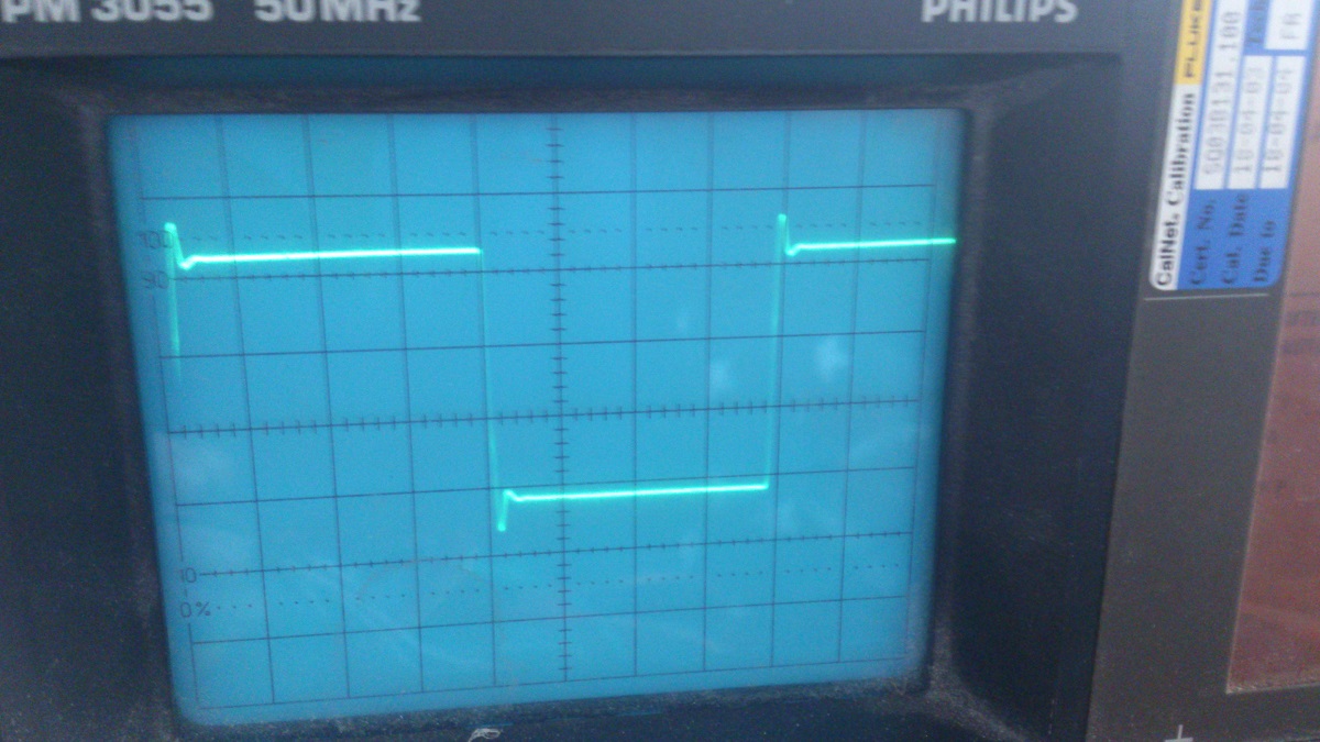

I have now put in irfp240 these behave very good, when cold idle go up and get regulated after, and stays on 350 milliamps, however the tem sens resistor is overcompensate.
The irfp250 did go up so fast the temp transistor can not regulate on time, I have no oscillations, did test this on the scope. Maybe the 250 is not suitable for the amp, I did have such problem in past with a igbt amp, did not get stable with idle.
Here a square of 20 Khz, and have some overshoot but that is easly get rid of with compensations.
