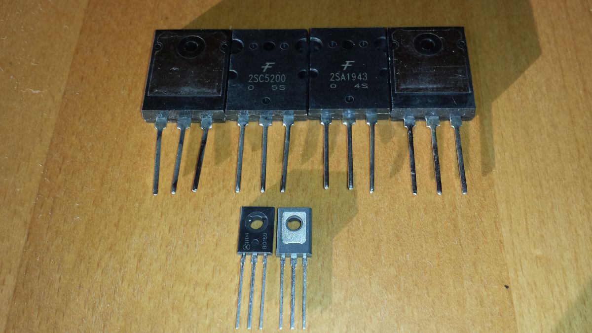

about one year ago I bought some pairs of 2SA1943/2SC5200 and a bunch of BD159's as well. They're labelled as being made by Fairchild and Motorola, respectively.
Yes, in ignorance of the existance of fakes I bought them via ebay. Meanwhile I've learned that most probably any device offered on ebay has to be suspected as being counterfeit. But could anyone, please, tell exactly what I've got? I'd only like to know for sure. Thanks in advance!

According to the Fairchild datasheet they use a different shape of the lead out and they have a plastic 'sleeve'. Also, the logo is different, the top line ends with the vertical (or more slender) one.
Though, both could be changed without notification and the F transistors could be (very) old stock. I can't tell for sure but I would rather suspect them to be fake.
Thanks a lot for this info - though being a not too optimistic one 🙄.
I always prefer going for sure over being discouraged, as I'd wish to use these devices in my upcoming Honey Badger project. So, are there any reliable tests, or measurements, that I could perform?

Hello!!!2SA1943/2SC5200 are fake for sure but they still will work just put them a lower voltage and go until you get orginals.

As I recall, the seller of my trannies wasn't located in China. At least the package came from a domestic adress. That's why I'm not inclined just to follow any statements, but to know for sure.
