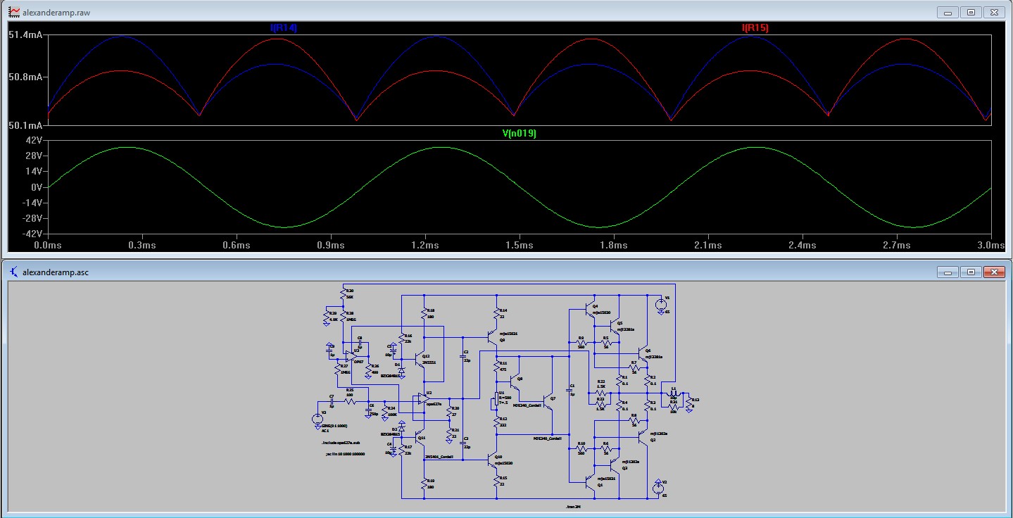

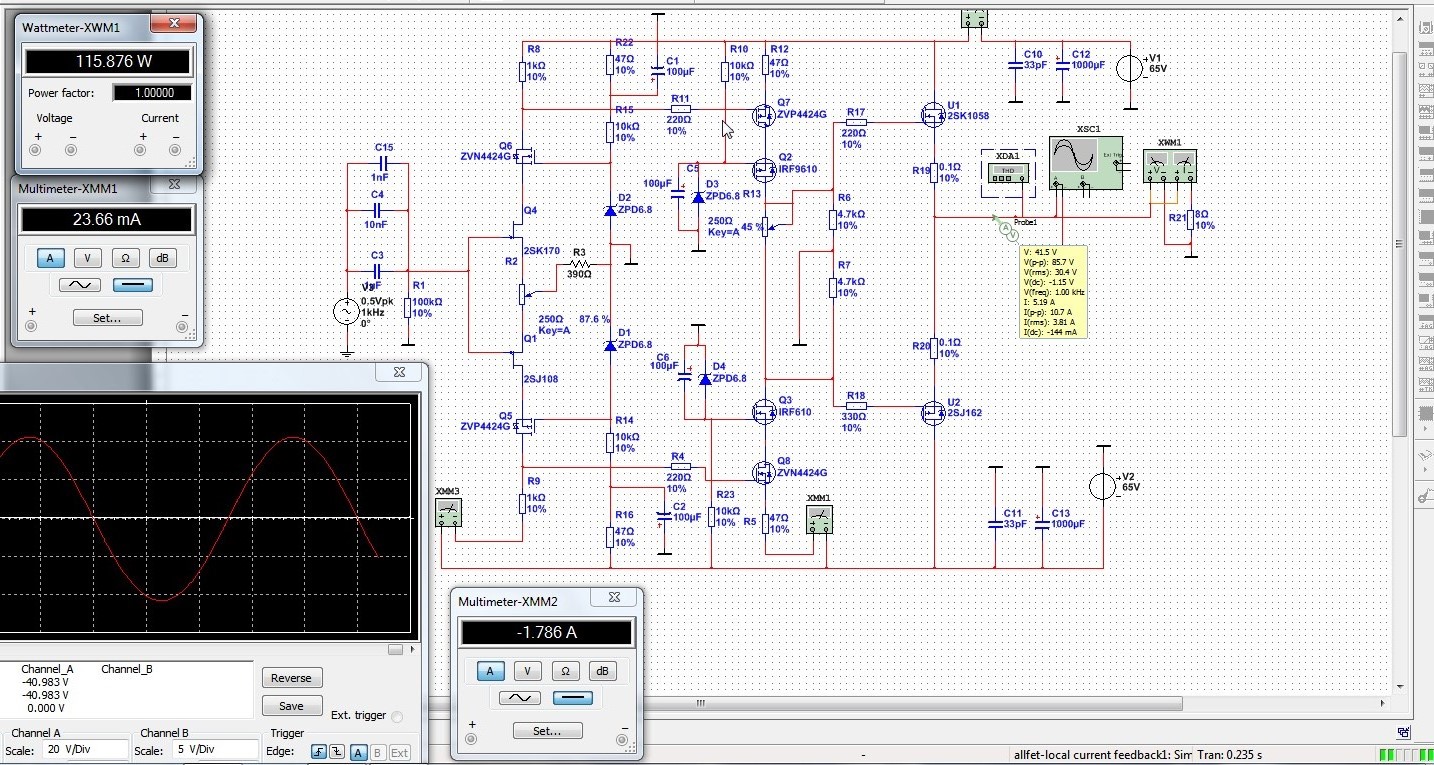

Oke thanks for the explaining I do agree i that also high end guys has to go smd, I have already a lot of restistors caps in smd form, now to go use them, but I am 58 so eyes get less good, but good glasses wil work, I do think by buy a pc camera who do magnify and so I can do make it.
The J-fets I ded understand was the problem?, I do use them in my amps, also I use tubes in it who do well.
Th alexander amp I have now simulated, this with a opam a integrated one haha, but it is a burr brown opa 627 because not al opamps can be used in this current feedback amp on picture left and a local feedback allfet amp on the right.. I do use here these Jfets, normal transistors are indeed enough to find.

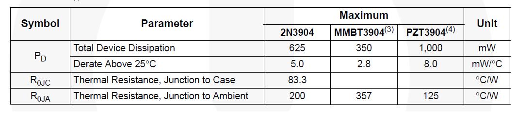

The one thing we still have to get use to is the 350 mW power limit as opposed to the 500 mW average for TO-92 devices. Also, coupling transistors together thermally is a little more difficult now.

Ya sure. Lots of magnifying stuff around for us old foggies.
So 1W isn't enough for you in a 3904. Just one example.
Since this is off topic I'll make this the last one.

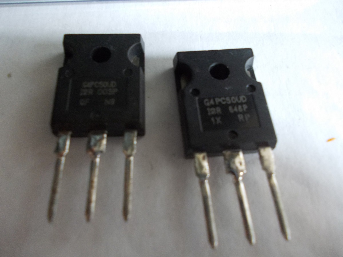

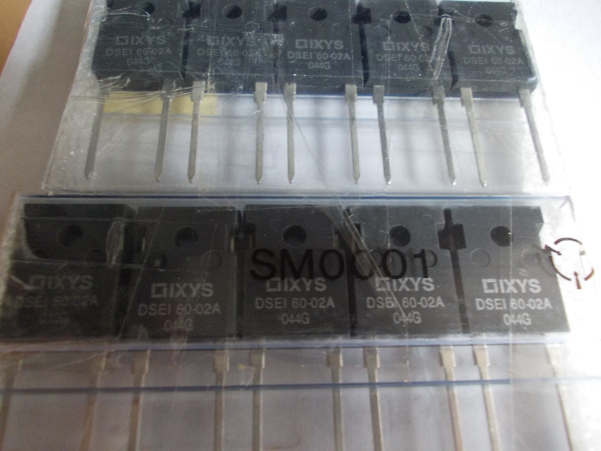

This is my transistors collection, some opinion about they ?
Original or counterfeit ?
The TIP3055 looks like original in my opinion, but the 2SC5200 and 2SA1943 looks like fake
The others I can't identify..

I believe some of the Toshiba 2SC5200/2SA1943 are the real deal. Look at the top edge, do they have two small rough areas like some tabs were removed. The print etching can be hard to read on these. There is a schematic on this site for a test fixture to test these at some serious power levels, don't remember which forum though.

Indeed, better looking at the first page pictures my 2sc5200 seem real. I'll test the hfe and I will tell the result later.
I suspected them because I paid a low price, while the "reals" are sold around R$ 15.00 I paid them around R$ 8.00 ( I don't remember the exact values, just an example)
For the other transistors, any thoughts?
