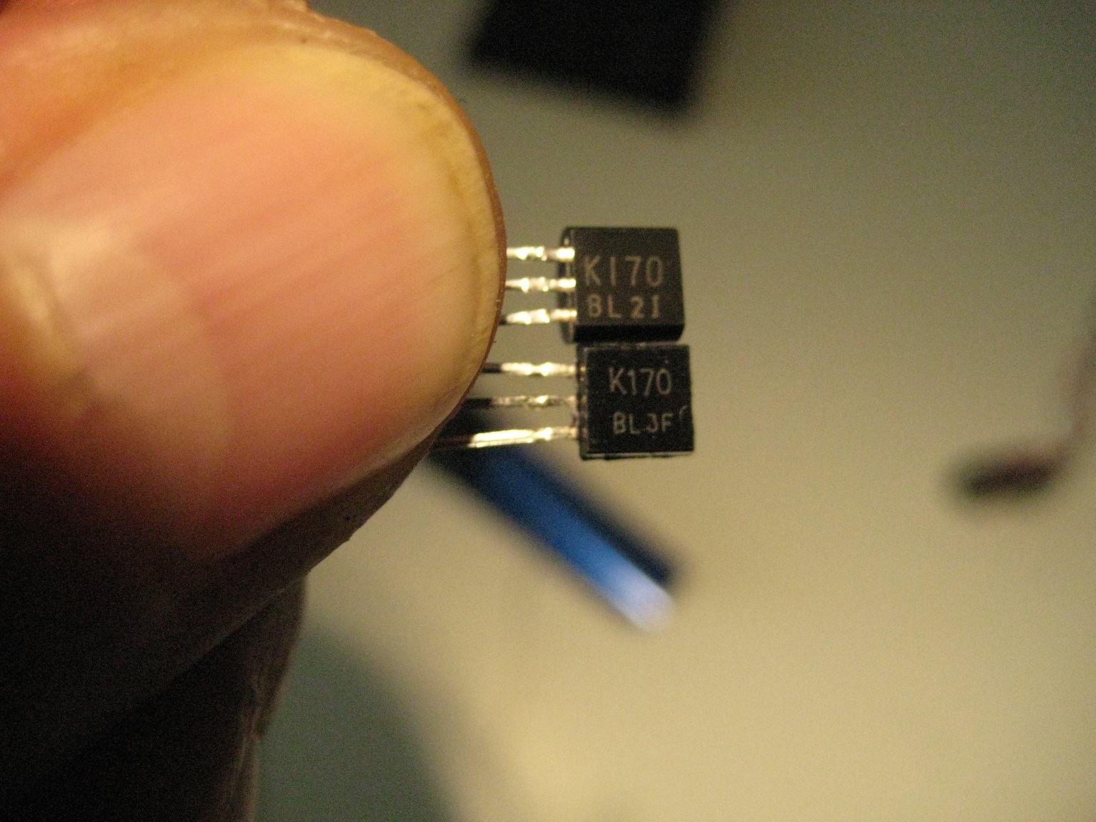

Oh, no bought fakes again.... 2SK170BL
First I ordered 10 pieces, they were the real stuff, so I bought another 100.....fakes.
Good fakes though, laserprinted, Yfs = 18 -19 mS, V ( pinch off) = -0.85V instead of max. -0.5V.
See picture... good one, fake one...

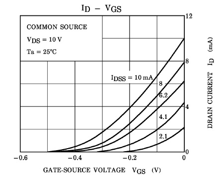

V pinch off varies with Idss.
A low Idss BL will have a low Vpinchoff.
A high Idss BL will have a high Vpinchoff.
Since BL varies from 6mA to 12mA (2:1) expect a similar range of Vpinchoff.
the 2sk170 datasheet shows typical Vgs off (0.1uA) of 700mV for 12mA Idss dropping to 550mV for 6mA Idss.
These being typical will have a tolerance.
I would expect at least 500mV to 750mV for the BL grade, but I have not measured many Vgs off, so I don't have reliable data.
But clearly your 500mVgsoff for a guide value for the BL grade is misleading.
I will first give the shop a chance to solve it (widerrufen), before I name and shame them ;)
It's a German shop who probably isn't aware they are fakes....

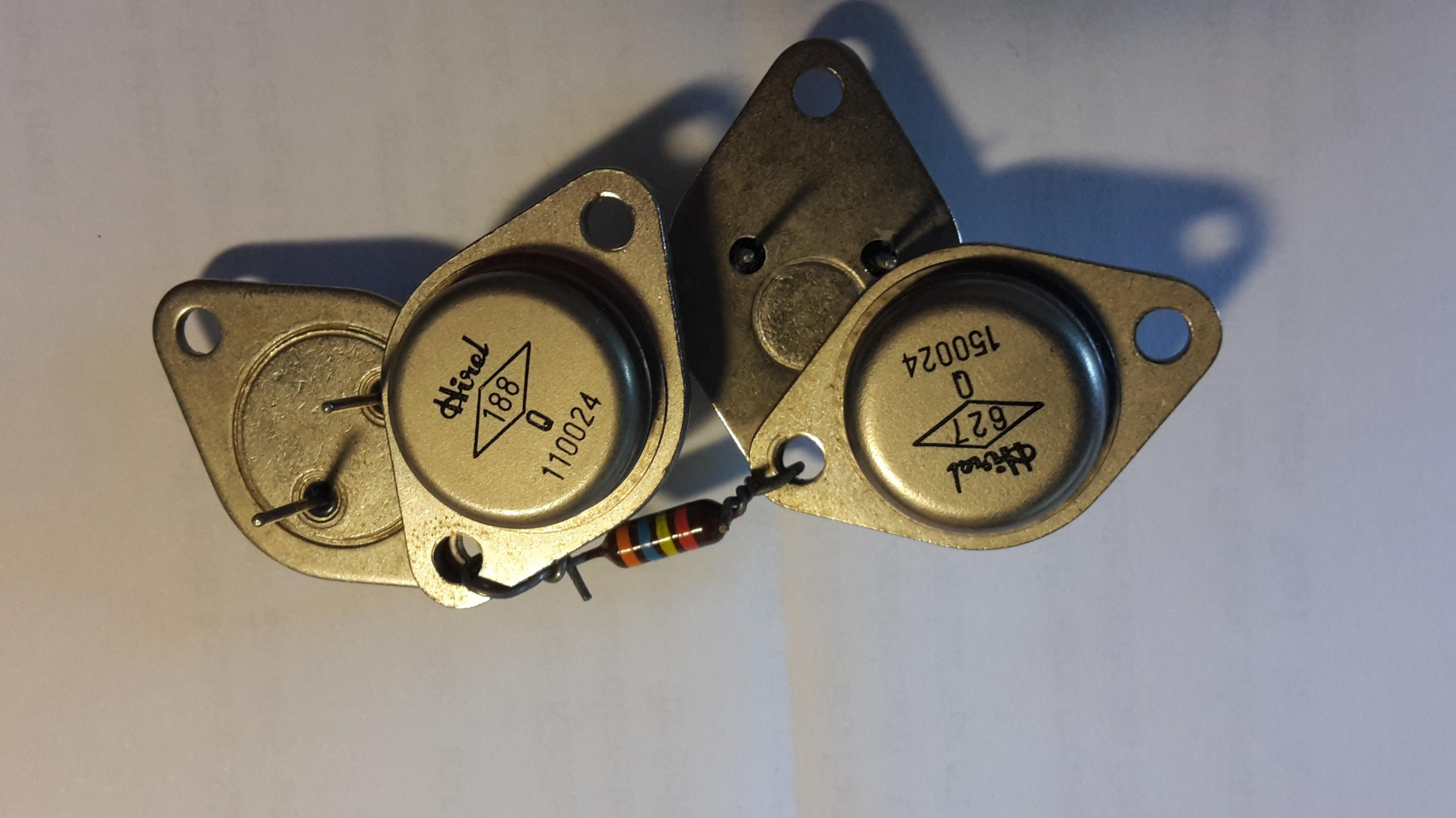

There isn't any "MJ150024". It's only supposed to have one zero. One is marked with a different number and that doesn't correspond to any known MJ, even if you take out the extra zero.
Oke thanks for clarity. I did search fir you but I think these are special made, as this company do work for army.
this sucks you have to measure, what is difficult I think to find out amps and voltage.
I did use the mje 15024 for audio did well.
