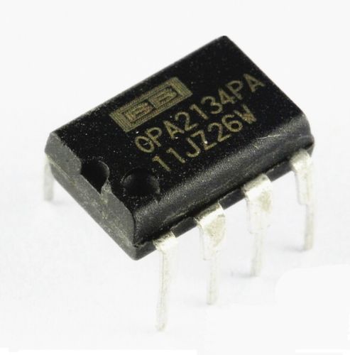

That looks like a file photo of the real thing.
You know how much these are worth, and they are not inexpensive at all. How much are you trying to buy them for, or how much did that one cost you?
Step number 1. Examine the data sheet to see if the markings look right.

I have to say that picture has from ebay, not the ones I have. My chip has not a dot on pin 1 like this one have.
I have no 4458 or tl072 chip, otherwise I had already now if it did work, have order some others.
regards
Well these chips will normally run in the $10 US range depending on authorized supplier. Not a chip you would use everywhere. I have used them, and they perform extremely well. If you don't have normal dual and single op amps on hand, perhaps you should pick a few up just to have them if needed? The basics would be things like the TL071 / TL072 (J-Fet input types), 4558 (standard bipolar input) and maybe some NE5532 and NE5534 chips (higher performance and very good for audio). Buy a few from authorized dealers first. This will allow you to compare your Ebay finds with the real deal. You could then test different parameters and compare that to your unknown chips.

I did found the error, I had the pol caps on input in wrong polarity, so thing go wrong, now it do work with the chips I have ordered.
