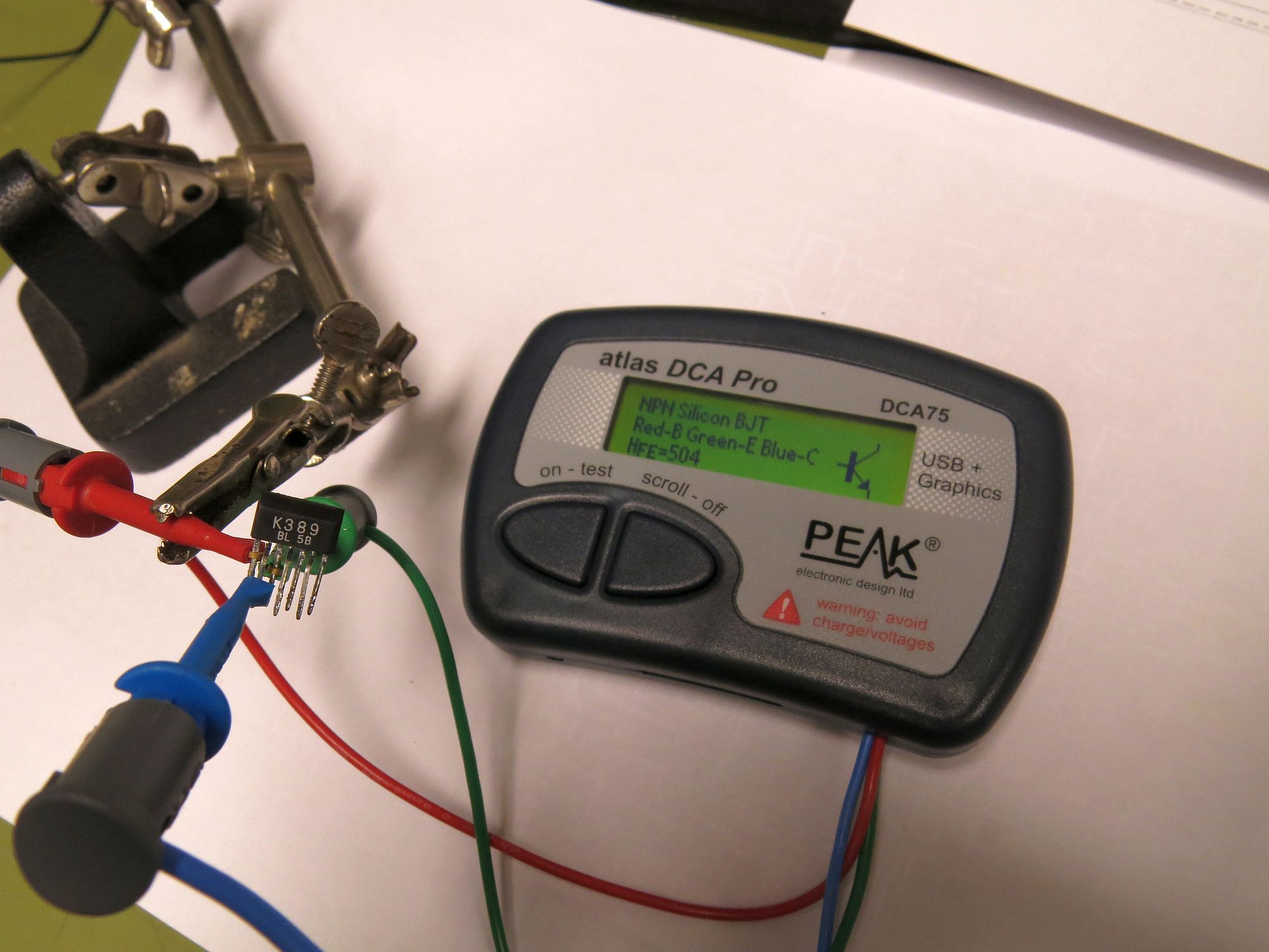

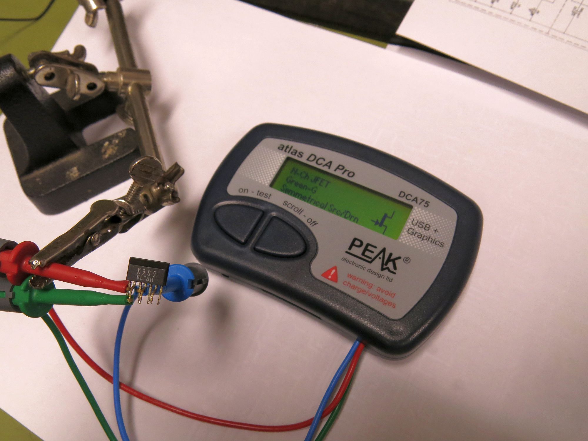

2SK389. One is from the working channel of a Yamaha Power Amp, the other one was supposed to replace the faulty one of the other channel. Any thoughts? 😛
Fake! Exactly what I have got from aquawayindustrial , a relabelled NPN. I sent eBay the pictures with the screen of the DCA and won the case. Received a full refund.
The other half is an NPN, too.
I did not order my part off eBay, but from ASWO. They once sent me fake Panasonic FC's, too. I called them up, but unfortunately they were'nt able to replicate my measurement. At least they brought two new parts on the way to me, so I hope they are genuine this time. They also told me they didn't have any such problems lately, so it's good to see that I'm not the first one to discover bipolars in disguise as JFETs.

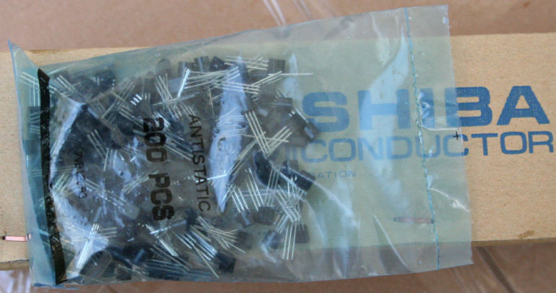

We had a group buy years back.
The purchaser distributed the items around the world to us Members, without checking what he had bought for the Group Buy.
It cost him a lot of money, since I don't think he got a full refund for the dual BJTs that had been relabeled.
