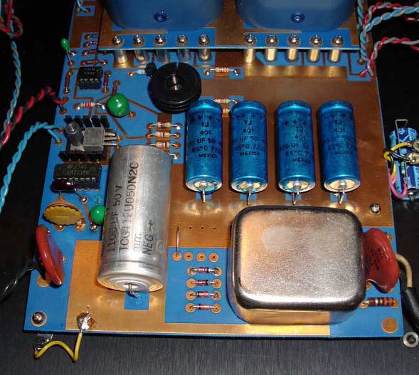

Hey Malotron, you have dissected the NS10. No more guesswork, no more back engineering
of course adding the schematic posted by R-K which was also a tremendous step forward.
For the line amp we only need to take away the RIAA feed back stuff and replace it with some regular FB components.
Great pics Malotron, excellent contribution, Thanks...

choky said:hehe-it's nice to see tht servo ,not for null but for Vcc/2 purpose.....
Choky,
Could you elaborate?... in plain english?

apassgear said:
Choky,
Could you elaborate?... in plain english?![]()
as I see it- positive input of LM307 (main actor in DC servo) is referenced to Vcc/2 via 1M-1M resistance divider........if word "tht" in mine post puzzles you-that is just "that" without "a".....typo.....

I wouldnt mind a pcb with the whole enchilada, including the RIAA. That would really be somethingOK PCB mods in progress.
BTW, Russ did you make a pdf of the shuntreg supply you posted earlier in this thread?
Steen
steenoe said:I wouldnt mind a pcb with the whole enchilada, including the RIAA. That would really be something![]()
Steen![]()
Hi Steen,
That's a very good idea. I suppose I could make the RIAA section so it can bypassed.
Can you post a link to the schematic you are referring to? I am not sure I ever got around to that PCB, now may be a good time to try.
I am pretty busy this week, but I hope to be able to work on this this weekend.
BTW Jacco, I am very happy to do this, it is actually partly very selfish (I love this stuff).
Cheers!
Russ
Hi, Russ. This is the psu: (I havent given up on it yet
http://www.diyaudio.com/forums/showthread.php?postid=786218#post786218
I am happy to see you are up to an updated design of this preamp. What we made wasnt an excact clone, but it sing's really pretty anyway. The real thing would be even nicer.
The Riaa part should be seperated from the line circuit and only connected when it is selected through the input selector. So there is no need to bypass the RIAA circuit, since its not part of the linelevel circuit.

steenoe said:Hi, Russ. This is the psu: (I havent given up on it yet)
Steen![]()
Ahhh yes... I have found it. I will make PDFs for you here shortly. The new "actual circuit" PCB will be single rail, so I will come up with a new PSU for it based on the same design.
I will show you what I have in mind for RIAA later.
Cheers!
Russ
Sounds great, RussAhhh yes... I have found it. I will make PDFs for you here shortly. The new "actual circuit" PCB will be single rail, so I will come up with a new PSU for it based on the same design.
Steen
