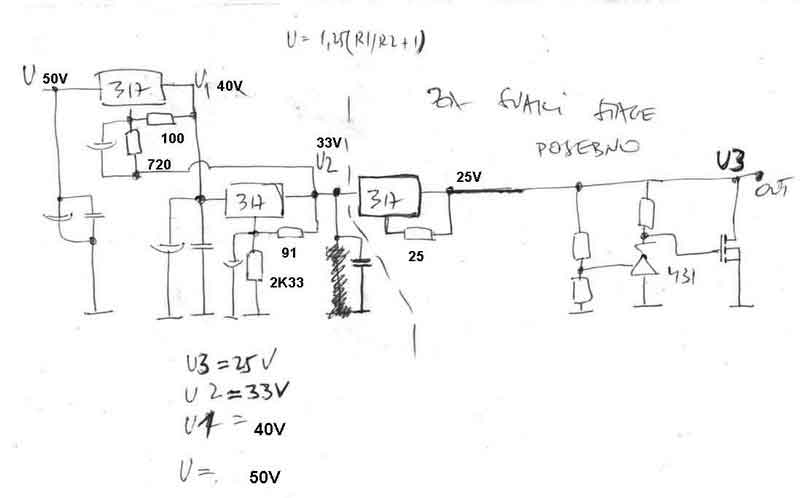

Did you calculate the resistor values for the 431 device? I am also curious how you would connect that device to the negative side.just half
Steen🙂

Which schematic did you use for your regulator?
choky said:just half
not tried yet
series reg part (left part from dotted line) shared between channels
317 CCS and shunt for each channel on chared pcb (reg+audio)
edit- 50mA per stage
Hmm - as a start I wanted to build similar version as your series reg part (double series regulator) with additional power resistors at the output to have constant load ...
but now - this seems tempty 🙂 (but I'll have to buy some parts ...)
Btw - trimer - if decided not to use it - do I just simply connect emittor of Q1 directly to -V?
I used this except I didnt use darlingtons (yet) I used BD139/BD140, and didnt use the diodes at the output. I tried with more capacitance also (2200uf's) and some other variations.

steenoe said:Did you calculate the resistor values for the 431 device? I am also curious how you would connect that device to the negative side.
Steen🙂
didn't calculated yet resistors
connecting?
like zenner-
exactly the same,just final resistor chaaaaaaaange place

Thats the kind of guidance I need allright🙂 I fiddled with the neg rail and the 431 device with no luck😀tip for steen:
Steen🙂
I would like to see a working schematic😉 I did connect the 431 as you say is the obvious way, but but but.......connecting?

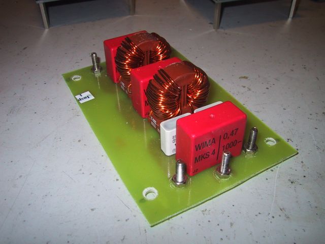

Well, I want to discuss the main supply a little more. I just went through some boxes of (big surprise!!) electronic stuff and found this. Take a look at the pic. Isnt that a mains filter of some sort?
Could I try that in front of the trafo? Ofcourse I could try, I know that😀 But would it be reasonable?? Any chance it would cancel out the darn buzz??🙂
Steen🙂

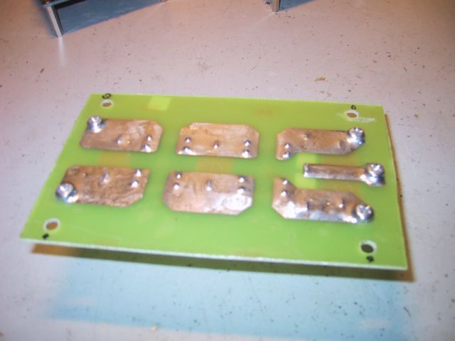

steenoe said:Here is another from the rearside. As you can see on the tracks, it was made for heavy duty🙂 I would appreciate it if someone could tune in on this.
Steen🙂
bingo!
nice one
side with three legs- one is line,middle is ground,other side is neutral (in my country line and neutral are interchangeable,meaning that wall outlets and device plugs are not .....hm...phased-if that is proper word.
other side-with two legs -is output to load ;one line,other neutral
try it,immediately

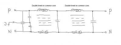

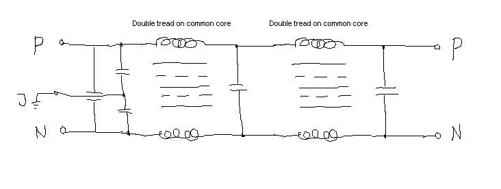

in a meantime ,one example
http://www.diyaudio.com/forums/attachment.php?s=&postid=766245&stamp=1131941055
Thanks Choky🙂 I thought this little circuit would come in handy some day😉 I will give it a shot🙂 I just love the simplicity of the shunt reg. Its kind of in the NP-spirit. Sooo the more complicated versions isnt excactly my kind of stuff!try it,immediately

Thanks Analogair🙂 Nice to have validation on this! I can see its a CLC filter of some sort, with the L's having a (presumably) ironcore! Other than that, I know not a thing about how it works??Jep, it's a Mains Filter.
Steen🙂

if you are in a hurry-you can try this "317 cascode+317CCS+.....) with BD shunt stage instead tl431+mosfet
for my liking,this will be even better
