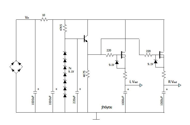

jh6you said:I am confused again - my bad habit.
Thanks for the reply, tube man Choky, and I believe yours must be good.
I was thinking to use NPN transistor and other components already in a junction box . . .
And, I was thinking that the arrangement of a zener regulation combined with an emitter follower will reduce zenner resistance, i.e. due to Rz/beta, so to reduce the ripple in a better way . . . In addition, the following source followers will purify the output voltage once again . . .
Could you give me a hint how yours reduces the noise?
Regards
jh
you don't need to reduce ripple from zenners,noise is what you need to reduce;
in Oly's PSU ,zenners are in colector leg of Q5 (generic BD PNP 100V min) and zenner noise can't be in any way amplified through that or any other transistor.besides that,with mentioned BD ,zenners are fed with CC,and consequences are simple and logical-less noise ,less voltage and temp variations
in your implementation,zenners are in base of NPN.....looks like no-no ?

After the bridge rectifier, CRC and zener regulator follow. By the way, there will be still some of ripple voltage at the enterance of the zener regulator. But this ripple will be once again reduced by a voltage divider formed by the 47K5 in series with the small internal zener resistance. Maybe, it is not enough yet, so the 220uF cap in parallel with the zeners will clean up the remaining ripple further.
Meanwhile, the Emmiter follower will reduce the output impedance of the zeners so that this can hold the load voltage almost constant because the voltage source looks stiff. Finally, the additional Source followers will increase the current handling capability of the zener follower regulator.
I hope I am not speaking on behalf of a lunkhead . . .
Any comment to the details . . . ?
Regards
jh
if we assume that your zenners are 1W3 each,then you must recalculate your resistor in series with zenner string;
1W3/9V1=142mA max per zenner and I recommend you to put some 5 to 10 mA through zenner chain;
in case that your input voltage is ,say,80V then we have :
80-(7x9,1)/0,01 =1K63 ,so you can use 1K6 ,not 47K as in your schematic.
with that value I doubt that zenners will be biased even slightly
gimme exact values for input voltage etc.......
I'm still for CCS-ed zenner string,hey-that's your reg,not mine 😉

Thanks for your calculation.
It should have been 4K7 instead of 47K5.
Sure it will be my reg . . . 😀
OK . . . I will try the CCSed zener regulator.
