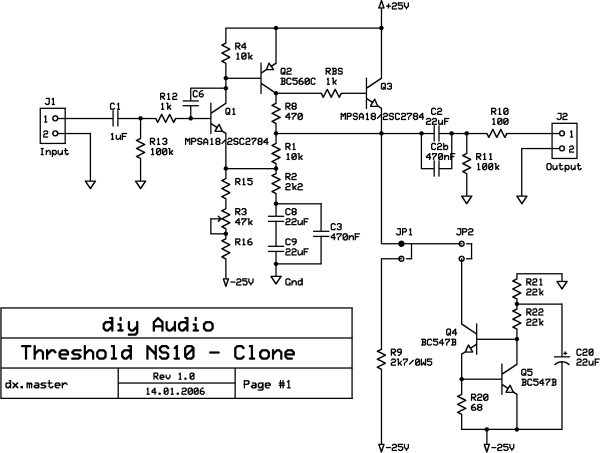

good enough?

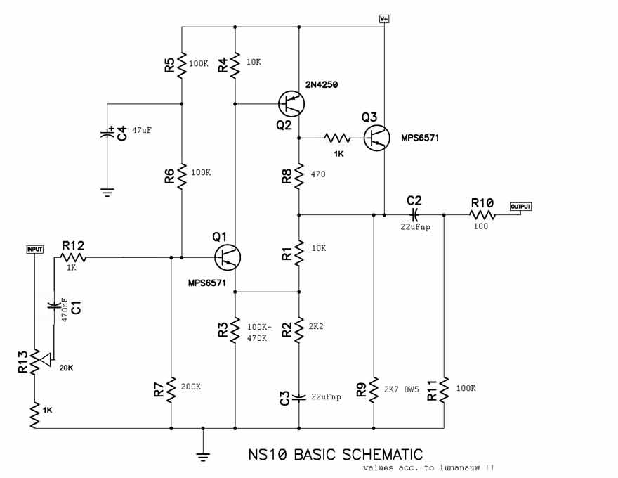

Nelson doesn't have values; schematics is his,from memory 😉
re-read threads,and in this thread you'll find schematic which,I believe ,we all tried........ seems that steen is best person to ask something (hehehe........)
just jokin'-feel free to ask ,and somebody will answer what you need....
I did do a single rail schematic based on suggestions found earlier in the thread. I will see if I can dig it up.... Pernally I prefer the split rails as you should get similar performance with less impedance(no voltage divider). That is really the only difference in the circuit is that with dual supplies you don't need to have the voltage divider.
Did you build the circuit with part values posted?
I did🙂 I used the excact values as in Russ's latest schematic. Works very good😉

Hmm - I do have BoZ and AL allready - but now I'm very very tempted to make NS10 🙂)
Just to clear some things:
PCB Steen had sucesfully used is the one in 2 pdf files in post#86 and"87 and in post#78
and the schematic used is the one in post#126
Correct?

Hi Stabist. The NS10 is a nice little preamp indeed. I am sure you will be happy with the sound of it, so go ahead and make one🙂
Its cheap enough to make with the low component count.
You found the correct PDF's and schematic allright.
I have had mine connected to my F2 clone, The ZenV4, OPA549 chipamp and my Zapsolute. It sounds good with all of them🙂
