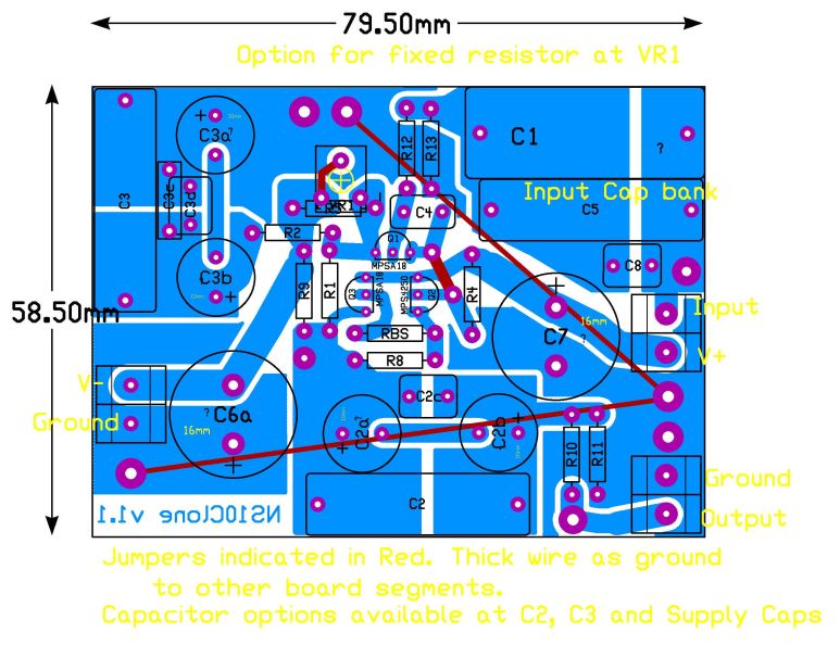

Hello team,
I have just built my version of the NS10 using BC549 and BC559. I only am getting a voltage gain of 2 (1V peak to peak on input: 2V peak to peak on output ... measured with a friend's scope.)
That doesn't seem like much to me. I would have guessed a voltage gain of about 2.5 to 3.
Is it the transistors I am using which are responsible for the low gain?
Haven't listened yet. Haven't put on bypass capacitors across supply capacitors yet either. I am just worried that I have done something wrong in the board or soldering.a
I put the transistors in using those individual little machined gold-plated thingies that you can mount IC's in if you don't want to solder in an IC. Another thing that amazed me was how different the output tracing is with different transistors of the same type ... asymmetrical output about zero volts. Plug in others, and everything is hunky dory! Makes me think that some of the transistors are just shot even when you buy them.
Here is a picture of my first (published) PCB. Be gentle please. I hope there are no errors of wiring which would explaing the low gain.

BTW, George, the NS10 I built is far more powerfull than I expected. It drives Zen-amps with ease and very dynamic sound. I didnt check your board, but something must be wrong somewhere in there. Please check it carefully against Russ's layout.

Hello Apass, Stenoe, and team.
1. I am using the schematic from Post#30 with added power supply caps 6 and 7. That schamatic labels C4 as the little bridging capacitor between the base and collector of Q1. Which schematic is everyone else using????
2. I completely re-drew the board using this schematic (as a check) and all the connections look the same as they did the first time, so I need another plan of action. I can see no solder bridges and all the joints look fine. I will compare connections, at your suggestion, with Russ's board too.
3. Today I plan to change all the transistors again and check they are all working. I have a sneaking suspicion that the ouputted waveform looked the same with and without transistor Q3 in place, which would indicate a major problem!! :eek:
4. I've got to get the "right" transistors from somewhere, even some BC550 and 560's might help. But how much measurable difference should having BC549's and BC559's make ... not much?
5. I am not using the ouput capacitor, so I will take up the suggestion in this thread to remove/short out R10 and R11 which are still currently connected and wasting a bit of voltage.
Looking at Lumanauw's first post, it appears that the gain should be 10k/2.2k from the resistors R1 and R2, i.e. 4+. I am not getting that.
Thanks for the advice so far. If I am not careful, I will be putting too much work into this pre-amp, which was just meant to be a stop-gap!! But it is worth persisting given its Nelson Pass pedigree! But it takes George to really stuff a good thing up though ...
George.
PS. I have built the power supply using CarlosFM's schematic for his (Re)-searched pre-amp which uses LM317s and LM337 regulators and just boosted the voltage to 24V, which was the "easy part"!
George,
Yes, you have been working with a different Schematic. We are using the one on post 126.
Even though both are the same thing there are some changes on component numbering.
So far it has already been built by Steen with no apparent problems and I'm sure that any problem with yours can be ironed out.
For start, Steen is not using C6 (C4 on the older schem) and I would suggest you leave it out of the circuit for the time being (value will depend on the transistor used).
Q3 is a buffer so no appreciable change will be found on output voltage. Leaving it out will only make a higher output impedance preamp and the feed back schem will be different, something that I would not recommend.
As we all know, different transistors have different pinouts so I would also suggest you make sure you have those connections right. Q1 and Q3 are NPN and Q2 is a PNP.
I think BC560 (B or C but not the A classification) is a good replacement for Q2.
I’ll check which BC will make a good replacement for Q1/Q3 and will also have a closer look to your board.
