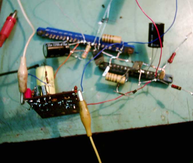

now we (steen and my humbleness) need "third opinion" regarding shunt reg etc,speaking of sort of "group project".
I'll go with this shunt reg (again-tnx to R.Elliot) ,without cap multiplier......
now I can try my BOZ,at last ...........

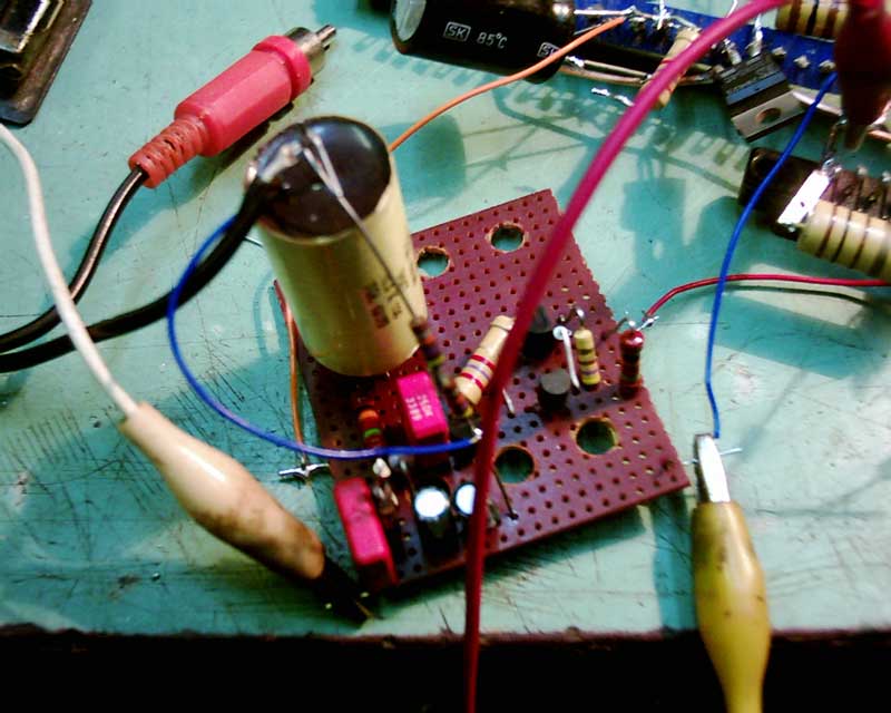

funny- NS10 ,at least with my test listenin' level (pretty low electrically,just because later connected SS Alnicos are more than 90db/W/m) worked flawessly even with just +- 3V5 supply

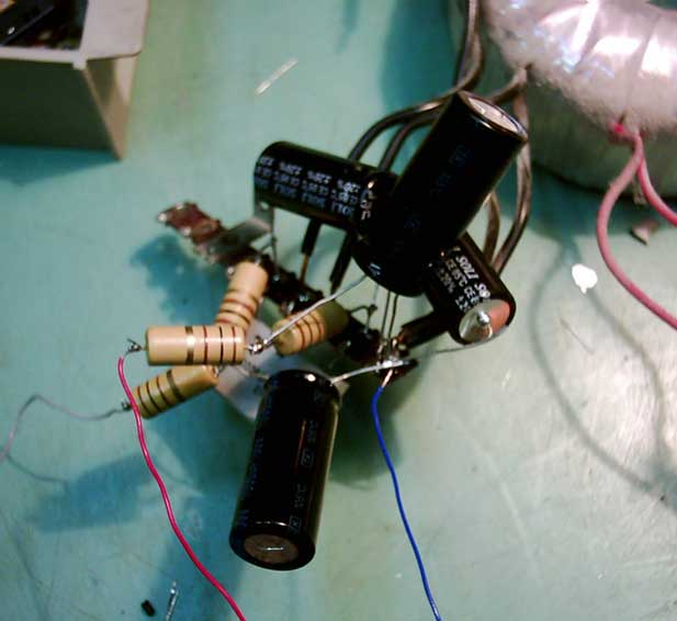

as I said-absolute minimum is STIFF 35 volts on input (first 100 ohm resistor)
with this ,current summ is easily solved- 35-25,7/200 ohms=46,5mA
~10 for preamp
~10 for zenners
rest for darlington lunch hehe
I tried today (ystrdy?) with 45 V input ,without any problem (heat ,hum ,buzz,anything)
in any case-if we presume some mains variations,I'll not go under 40-45 V on reg input
on case of stable mains feed,35V will do the job
just to be eeky peeky
one can increase base resistor to 220 Ohms and spare few more milliamps for active burning in transistor
in that case current through zenners will be under 5mA,so 5mA will be transferred to transistor.
I am not so used to spare on milliamps,even I'm primary tube oriented... my preamp use no less than 20mA per channel and also 25mA in shunt per channel.......

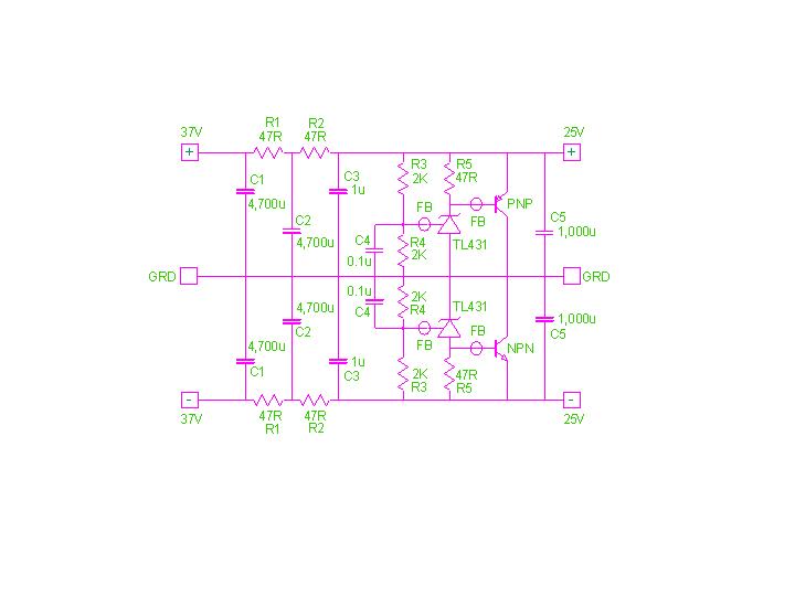

Well, here is an attempt to use the TL431 as a voltage ref.
Seems to be somewhat extreme in certain aspects but is not, remember that the PSU is in the signal path so whatever we can do to benefit it will be reflected sound wise. Myself will replace R1 with a choke when it’s my turn to do this extraordinary pre.
Please take in consideration that the circuit has not been tested, any suggestion is welcomed. Just don’t

apassgear said:Well, here is an attempt to use the TL431 as a voltage ref.
Please take in consideration that the circuit has not been tested, any suggestion is welcomed. Just don’t![]()
looks good;
as I said earlier-only ears can decide what is better-simple one transistor +zenner stack or TL431 (with or without transistor) route...
in any case-just remember-in case that you want to implement choke,resistor in series have role to burn excessive voltage;
if you calculated that you need 100 ohms for presumed and needed current (what you splitted in two 47) then you need again 100 ohm minus DCR of choke-no less....

Choky, great work on that NS10 proto🙂 Now thats what I call DIY. Now that you mention the mains noise; I can clearly hear my soldering iron making noise in the speakers when its turned on in my workroom! I can also hear a bit noise from the fridge and so on when it turns on and off. So it might be a good idea to look into that mains filtering as you suggest🙂

Looks good, Tony. Nice drawing😎Well, here is an attempt to use the TL431 as a voltage ref.

choky said:
looks good;

Your right Choky, in order to use a choke the voltage coming from the PSU has to be adjusted acordingly to the coil you will be using.
