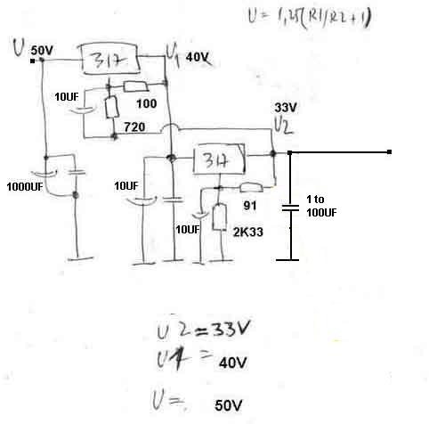

anyway-tis is my (old ) thinking about PS (this time for single rail version) :
prereg for all stages:
but0overall ,I'm not sure that origigi NS10 will sound better than NP's "from memory " version....
anyway-somebody can try this in vivo?
steen,AKA Lucky Luke ?
symetricall and twice 25V looks more promising than plain 25V version,with lotsa elcos in signal route.....
local reg for each stage:
I need also data for current consumption of servo IC-which one we will use?
741?
TL07x?
anyway- two servos can be in one chip (TL072 ?) and one dedicated shunt reg can be used for that chip,with adequate bigger resistor in 317 CCS.........
741?
TL07x?
Choky,
This pre needs the best PSU we can through to it. The servo needs a separate reg or sub reg to it (12 - 15 V).
Couldn't we try some of the nice shunt ideas from the BT thread?
