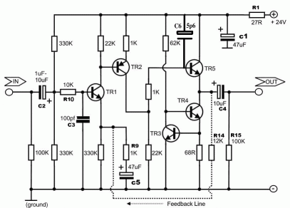

It still puzzles me how similar this is to the NAIM preamp gain stage, NAIM uses since the late 70ies (j. Vereker never denied that he did not develop it from several influences, as far as I heard or read) .
So many similarities: all single side classA, clever outputstage, single sided with active CCS load (no simple resistor), etc.
The main difference seems to me - besides very different component values - is the input stage biasing. Here the Pass circuit is more intelligent and self dependent, while the NAIM circuit is very much depending on the quality of the power supply, maybe that is also one reason while NAIM preamps profit so much from very good power supplies.
Hen and/or egg? Or just logical development?

hm,regarding "finding "everything" on the web" ...can you elaborate more what I found on net- about AH5012 and AH5020 for
For some of you that have not followed all the threads about the NS10.
The original circuit was in fact a single rail (24V) stage for this reason Q1 also needed biasing that was supplied by a nice and clever Opamp setup.
You can see a schematic of the original on this thread on a post by R-K some pages back (pdf file), or alternativly on the Threshold NS10 Lineamp PCB thread.🙂
http://www.diyaudio.com/forums/showthread.php?s=&threadid=76557

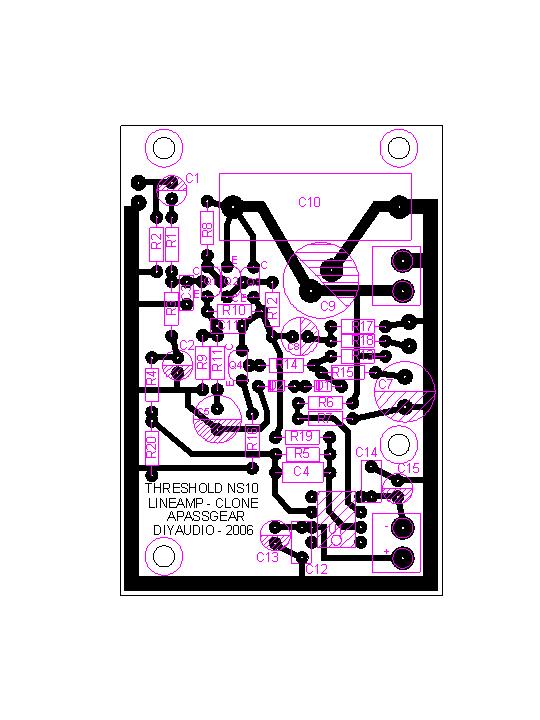

I have been so busy lately I have really had to shelve a lot of new projects for just a bit, but I have done a bit of research and testing here.
So, having worked up a prototype of both single and dual rail versions, I can honestly say that now that I have heard both (although only breifly so far) that the dual rail version seems to me slightly better. It of course is a variation on the original, and not the orginal NS10, but how is that bad? 😀 It is in fact "My Take on Threshold NS10" and not really a pure clone.
Now I am working on a new layout which I think will be better than this first single rail prototype.

Here is an updated version of the layout.
I have added R20 to test loading a bit the Opamp, which of course is optional. This ideas come from Walter Jung and John Curl.
R19 has change position to clean traces arround the Opamp.
All traces are now 1mm which would be easier to etch.
I will follow up with a corrected schematic 🙂
Sorry, this layout should have gone in the other thread.🙄
If a Moderator can delete the previous post will be fine.
apassgear said:Sorry, this layout should have gone in the other thread.🙄
I am actually happy to see it here. 🙂
Saves me from a whole lot of work. 😉
