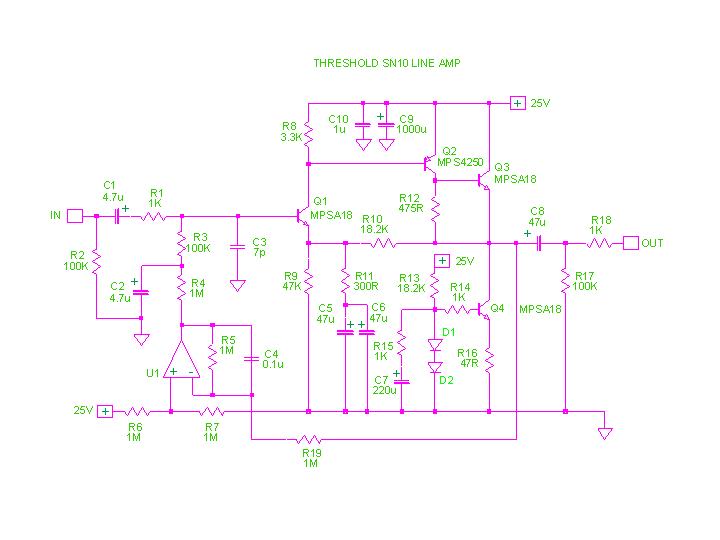

Seems that Steen still wants to build and “up to date version” of this classic NS10 preamp and since the nearest “original” topology we have is what R-K posted --as a RIAA pre-- we need to do some clean up and decide some component values.
For this I took R-K’s posted schematic and redraw it as a Line pre but we need to go over it to check values and topology, set FB values for needed gain plus decide on some enhancements to the circuit for an upgraded version.
There are some things that are easy to upgrade such as
- C1, replace with a 1u film cap
- C8, replace with a 10u film cap
- C5 & C6, replace it with a 100u plus a film bypass
- C9 + C10, bigger rail decoupling – included already
- D1 & D2 (MSD7000) replace with a couple of diodes (1N914?)
- Bypass D1/D2 as suggested on R-K’s Schem plus R15 resistor (John Curl suggestion to reduce noise)
- Active devices, to previous suggestions
- Other suggestions?
Now, which Opamp to use?
I know that Russ may be working on a nice PCB so this will help to set components and values for his work.

I think that's wort to try without local rail decoupling;
dedicated shunt stage will do that
in any case-it's convenient to make place for ,say,100UF cap and try without it
opamp
like NP sez somewhere-crummiest you find;
just look at RC constant on output of OP......
