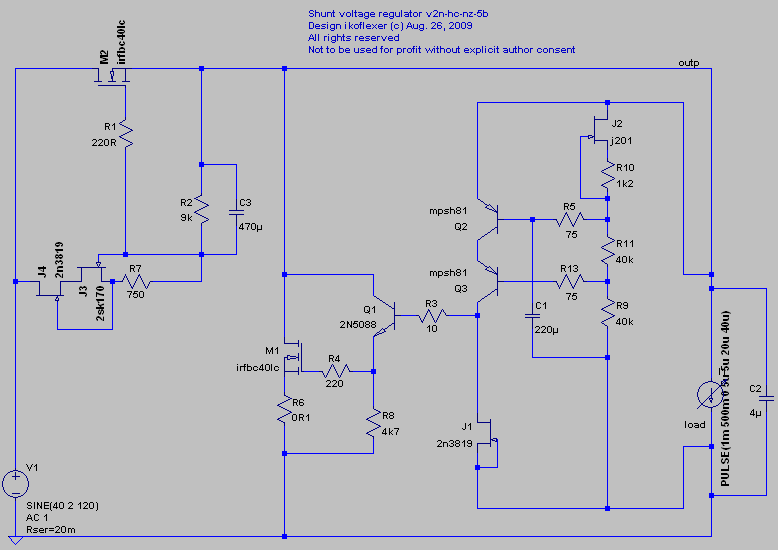

I don't think you are right to place all the blame on the local decoupling. It seems to me that some of the blame goes to the regulator design and some more of the blame goes to the builder and the haphazard way of playing with component values.
Andrew,
There is no blame! 🙂🙂🙂 No blame on the regulator. No blame on the local decoupling. No blame from myself on my bad build. No blame on any comments, positive or negative.
It is part of a learning process for me!
Bill
I see now that you're using a resistor in series with the output capacitor. I should say, on my prototype I always used a capacitor alone.
Regarding the large capacitor at the output. There might be a very large inrush current. You might want to use an ntc thermistor as inrush current limiter. I got a few out of some smps and use them in prototypes until I make sure things work as they should.
The resistor is to pad sufficient "ESR" to the cap. It is not in series with the output, or it defeats the purpose of the low impedance regulator.
Would the inrush current be limited by the CCS? I thought there is no worry on this. I could be wrong.
But to fill up 4,400uF (I guess that would be the maximum value required, and actually 1,000uF may do because it is to damp the resonance caused by parasitic capacitance, which is small, in the case of no local bypass) would take less than a few seconds. The MOSFETs can operate at 150 degree temporature so I guess the chance of blowing up the CCS MOSFET is remote. There should be no danger to any other components other than the CCS MOSFET. Correct me if I am wrong.
Yes, your current limit is pretty low, you should be fine. If your current limit was larger, at start-up, the CCS mosfet would get almost the entire voltage drop across it at that current.
A small update, revision 5b of v2. Moved C1 to attenuate the Vref noise better.

Did you do it in practice also? Some transistors can latch low when they see the cap directly. Seldomly but I have seen it happening.
I don't think it will over large enough resistors, but do it in practice to be certain too, it does filter better with RC constant. If you ever bump into something like that, either get the cap lower value or the stopper. There is nothing that indicates it here, just test for anti jinx's sake.

The resonance is now removed. The scope shows a thin flat line.
I have not had enough time to do the remote sensing stuff. Modelled with LTSpice that a super large cap + resistor won't damp the resonance in this case, or they had to be some ridiculous values that I won't trust LTSpice based on assumptions. However, a 22uF(ESR=0.34) local bypass would damp the resonance. I tried it. It worked.
So the resonance came mainly from the wire inductance and parasitic capacitance. It is not the regulator (by itself) that resonated.
The sound is overall clearer with the previous small degree of high frequency hash much reduced. But adding an electrolytic capacitor also added a tiny thin veil, not dramatic this time.
When I have the time, I will do the remote sensing stuff.
