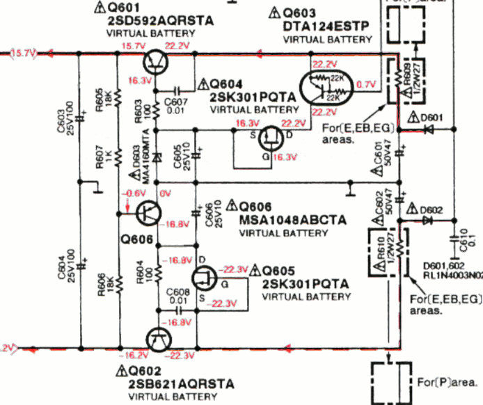

I think what we want, is a gyrator with a high Q. In an inductor, the higher the Q, the more ideal the inductor is. Similarly, a gyrator has a Q, and, the higher it is, the better. What is wanted, I think, in a gyrator, is a really high impedance, in a wide as possible bandwidth.
Q = X_L / R
Where R is the internal resistance of the inductor (just like you measure it in a choke with the ohmmeter), and X_L is the inductive reactance. The higher the X_L is, and the lower R is, the higher and more ideal the inductor is.
Since a gyrator is trying to emulate an inductor, I think the same principles should hold.
In summary, I think that low output impedance is not what we want.
But, if that circuit sounds nice to people, I have nothing against it.
I'll see what we can cook up around here that makes sense technically too.
Q = X_L / R

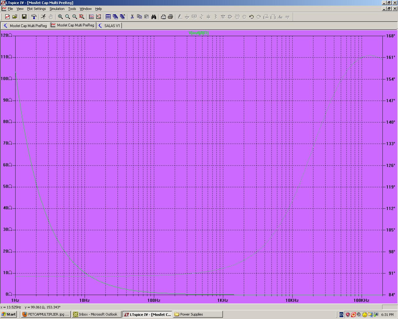

Just some more info.
Apparrently we need to get the ripple at the output of cap multiplier to around 1mV or better
The more I am thinking about this, the more I think a CLC with some large polypropylene motor run caps at the output would be better.
The other option might be two salas regs in series, the first one acting as the pre-regulator.
For some reason the quality of the caps may play a bigger role than the simulated performance shows.
It is very easy to get the output impedance down on the mosfet cap multi you just need to put 15000uF electrolytic and 40uF film (paralleled) at the output.

The cap multiplier will work better if R15 is moved to be parallel to C6 and the former location of R15 filled with an extra capacitor.Some people use capacitor multipliers before the regulator. Something like this can improve the psrr even more, at the cost of a few parts and a voltage drop of a few volts. I haven't tried it yet in a real circuit, it's just to throw the idea in for discussion.
