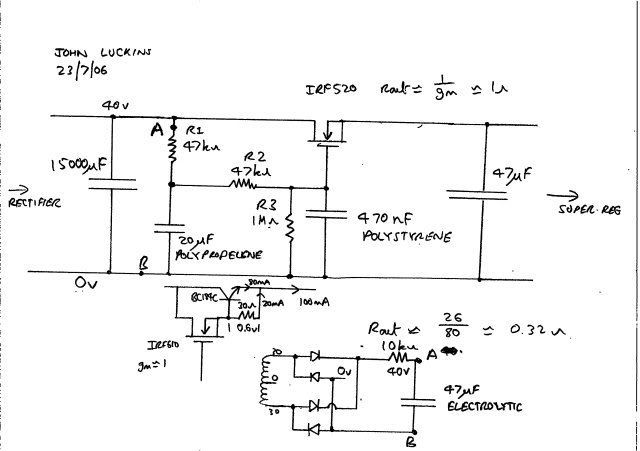

I built some fet cap multipliers before, it's an easy circuit conceptually. The only reason why I showed the bjt was because it was handy in ltspice (didn't need to search for it). In reality I'd use a mosfet for the pass element because, among other reasons, it's so much easier to get drive when high current is needed.
http://i27.photobucket.com/albums/c156/princesnuggles/FETCAPMULTIPLIER.jpg
Must use polymer caps to get the ultimate performance (except for the 15000uF cap of course).
Thanks. Hmm I think I have seen that before in the past somewhere. Sure it's an option for not to overcook the main ccs for psrr. Pre filtering keeps things simpler.

Maybe that IRF520 cct before v1.1 is something to listen too. Must be droping 4 Volt? I have some IRF820s. Low crss.
