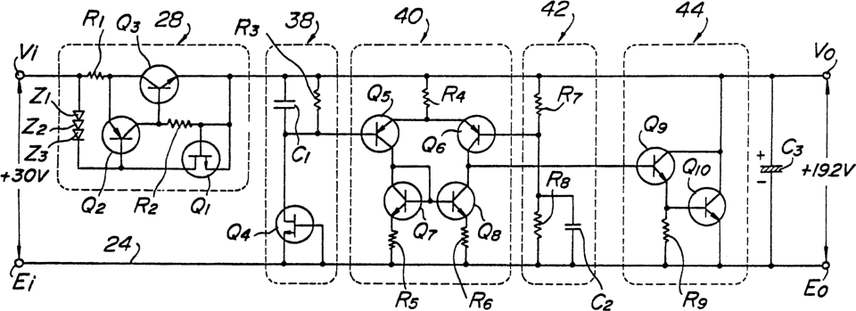

As far as I know this is the original patent
Highly stable constant-voltage power source device
US Patent 4366432 Noro, Masao Stax Ind Ltd
Regards
James
Regards
James
Very nice indeed, thanks a bunch James! I've looked quite hard for the originator of the ccs->shunt regulator but didn't come across this one. Not that anyone wouldn't have done it with tubes before, but still, I can see now how we differ from the original, for instance, he uses an explicit differential amp.

Maybe its Japanese in origin, I think the older that I have seen is the Stax one.
Regards
James
