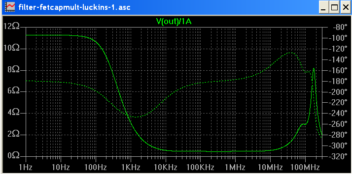

The biggest message that came out was that, the mosfet gave ultra-flat wide bandwidth output impedance, compared to bipolar darlington which is up and down with frequency.
He felt that by going for higher Gm mosfet he could lower the output impedance.
But again the biggest benefit comes from flat wide bandwidth output impedance espescially important at low frequencies.

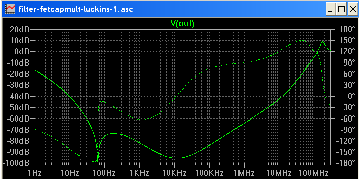

I'd be really surprised to see a gyrator with outstandingly low output impedance. A good shunt regulator following the gyrator would provide that.
Than, if you could please point me to the particular gyrator that ended up with the wide bandwidth output impedance it'd be great. I'd like to do some analysis on it.
See Post 116.
I never said the output impedance was low (I think it might have been around 1 Ohm or less). I said it was flat with frequency compared to the bipolar darlington.
The absolute output impedance (while still important) does not seem as important as having flat output impedance for the pre-regulator stage. The bipolar darlington didn't have flat output impedance.
