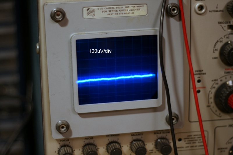

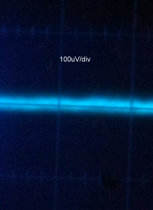

Not sure, the total noise is below what I can measure in microvolts. 🙂 The C1 mod makes sense though theoretically and if the rest of the regulator is built properly it should be beneficial.
At this point even moving the oscilloscope probe puts more noise on the screen.
The whole thing is so sensitive. I tried measuring the noise with the HP3581A wave analizer (also a microvolt RMS voltmeter) but as soon as the probes touched the output it infused about a 100uV noise from creating a ground loop, because now both the scope and the HP3851A were grounded.
I built a battery powered noise preamp last week or so which I used for testing the noise of different Vrefs but I forgot to hook it up to have a look tonight. Honestly, it's hard for me to worry about the regulator noise after in theory and in practice it show as you see.

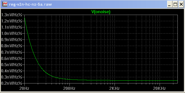

BTW, since I don't think I posted yet the simulated total noise at the output of the regulator, here it is, up to 50kHz.
I know its academic, that is why I asked if you could see a hair thiner noise line. Maybe it does something when the ref isn't a big enough Norton, and the cap does see a difference between across a low impedance and with RC constant. Maybe with an LM ref Z diode for example.
I did some tests an hour ago. I connected my CD player to my preamp (opamp buffer) and played some music while using the oscilloscope to measure the preamp input and the regulator rails.
When the scope probe was at the preamp input, the screen displayed all those wonderful dancing lines.
When the scope probe was at the rails, whether at the regulator output end or at the load end, the screen displayed a thin, flat, straight, static line.
I thought I had to be careful so I checked very carefully and did it many times. The result was confirmed.
