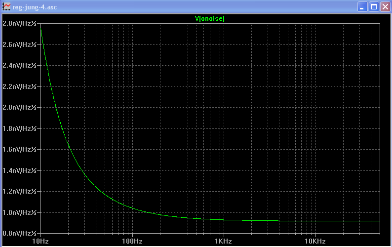

BTW, since I don't think I posted yet the simulated total noise at the output of the regulator, here it is, up to 50kHz.
Very excellent noise figures. This confirms what is stated in the Noro patent, i.e. that shunt regs should by much quieter than conventional regulators. It would be intersting to confirm this thru simulations of a good series regulator design, and if possible thru actual noise measurements, though I acknowledge that the latter is not trivial.
Thanks Martin. I happen to have the Jung SR file handy from the time I built it. Here's the noise simulation. I'm reluctant to take seriously any noise simulation, hence, I'd consider the noise simulation only for its entertainment value.
Regarding actual noise measurements, I agree, sub microvolt measurements are tough to do with any degree of confidence.
