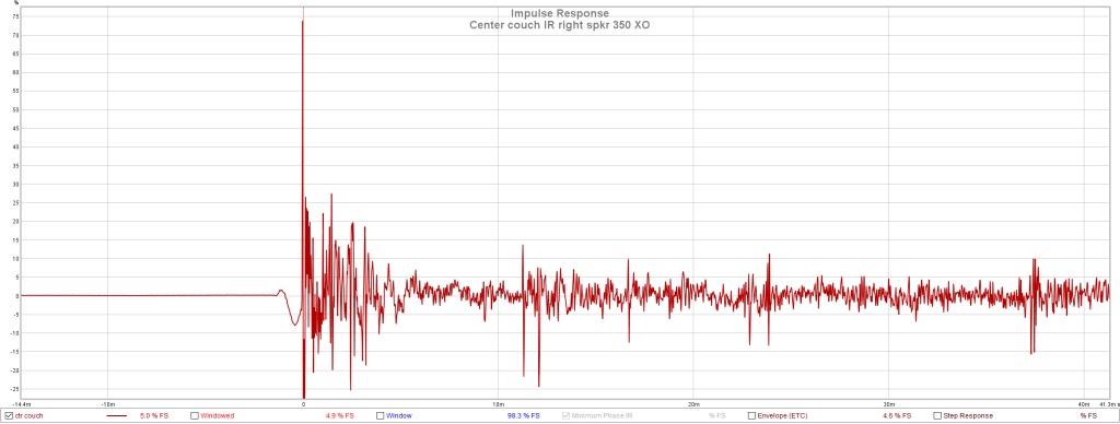

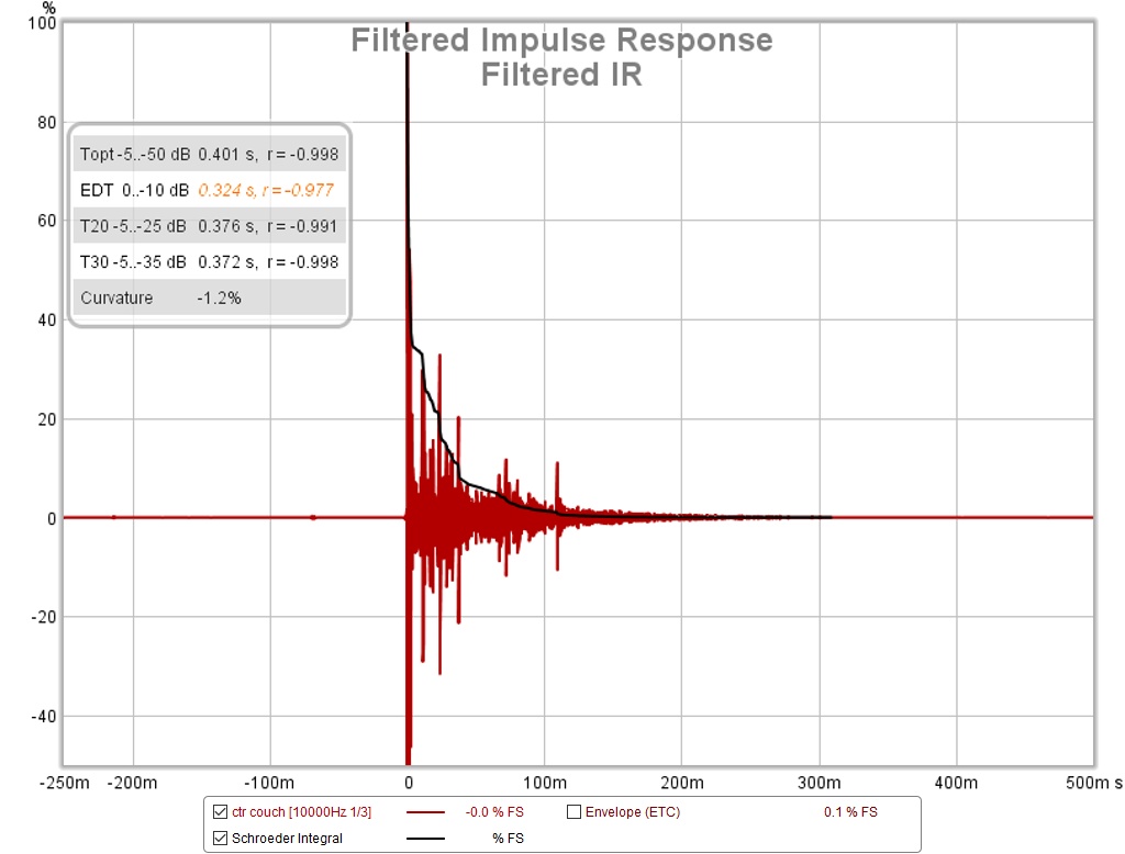

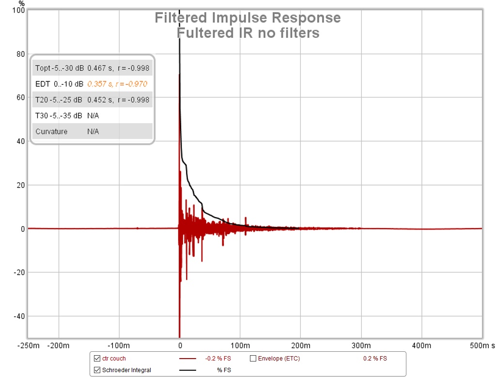

Due to the scale (your signal starts at 15 ms) we only see 5 ms worth of the IR.
I expect to see something at 11 ms (after the initial peak, so at ~26 ms, a big reflection) But also something earlier
The Filtered IR should also show some peaks with high SPL. After the initial peak I mean.
Look into the area after the initial peak, there should be some clear peaks, at least one at ~11 ms.
Should look something like this (only with bigger peaks following the initial signal)
My quest was to get them all down by at least -20 dB after the initial peak. That still doesn't tell you much
about lower frequencies though, even this graph is a combined representation of all frequencies. But it usually
shows the bigger reflections (so you know at what time they arrive and how loud they are, sort of anyway)

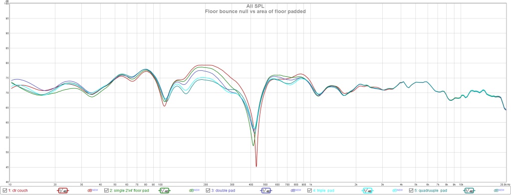

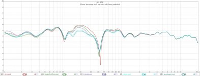

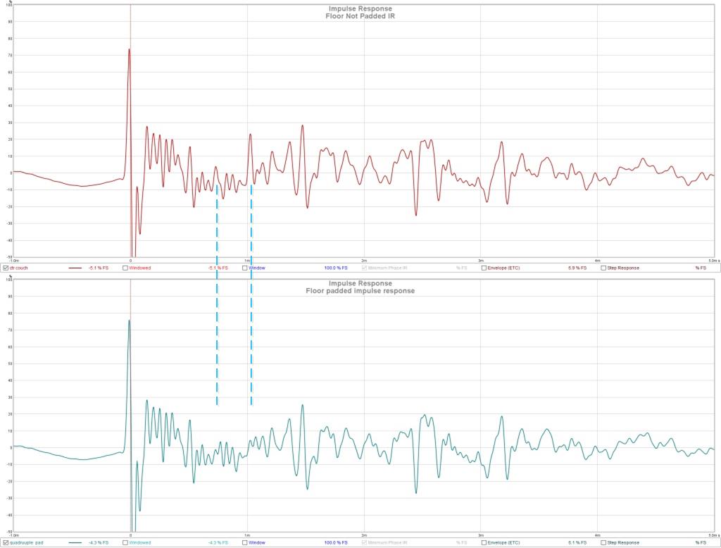

The delta path length for the floor bounce is .8 to .9 ms across the couch. 2.65 ms for ceiling bounce.
The floor bounce really widens the mid bass trace. I'm hoping that a carpet and pad upgrade will clean up the upper midbass part of this and building the 2nd set of bass bins will take care of the first octave and half below woofer XO. Perhaps I could push the woofer XO up even higher and then make it steeper.

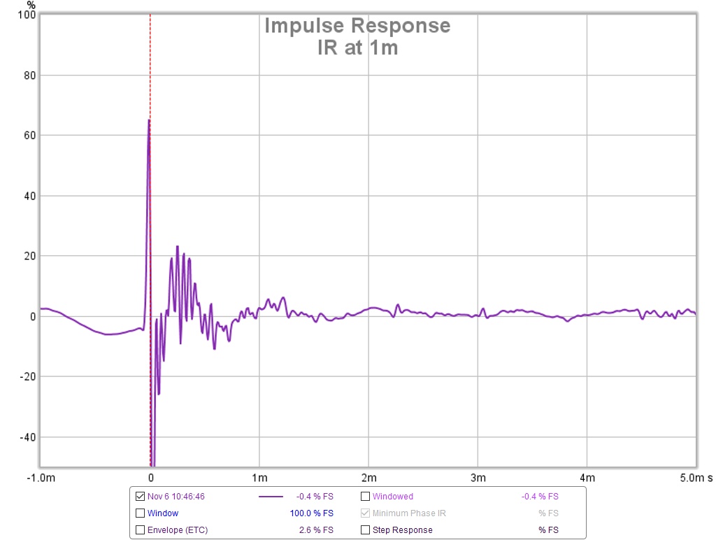

That's better (to read). How does the IR look at 1 m on the same scale (the cleaner APL plot shows way less reflections). Just for reference...
We've got to figure out where the reflections are coming from, but also how many of those wavy lines between 0 and 4 ms are reflections. A cleaner IR (without reflections) should teach us that.

Set it to "dB FS" instead of "%FS", zoom in on the first ~100 or 50 ms.
To switch to SPL instead of %FS, just hoover the graph and it should be at the top left.
That should give you the initial peak reaching 0 dB, followed by the reflections.
No filters (yet)...
Don't forget, everything close to the microphone can give you reflections too! If you have a leather couch,
drop a folded blanket over it... look for stuff closely behind the microphone. (not being there at 1 m)

I've been around the room padding various surfaces. The most telling though is what happens when I pad more and more of the floor area between the speaker and mic. I've got two 4" thick fiberglass panels and 2 2.5'x6.5' foam futon mattresses that I spread out on the floor and measured successively
The more area I cover, the less deep the notch at 430 Hz and the lower the bump between 100 and 300 Hz. Clearly, I'm not getting as much vertical directivity as I hoped in that band, maybe I can get more by playing with the XO or perhaps it will have to wait for the 2nd pair of bass bins. Its clear however that the issue is floor reflection in this range.

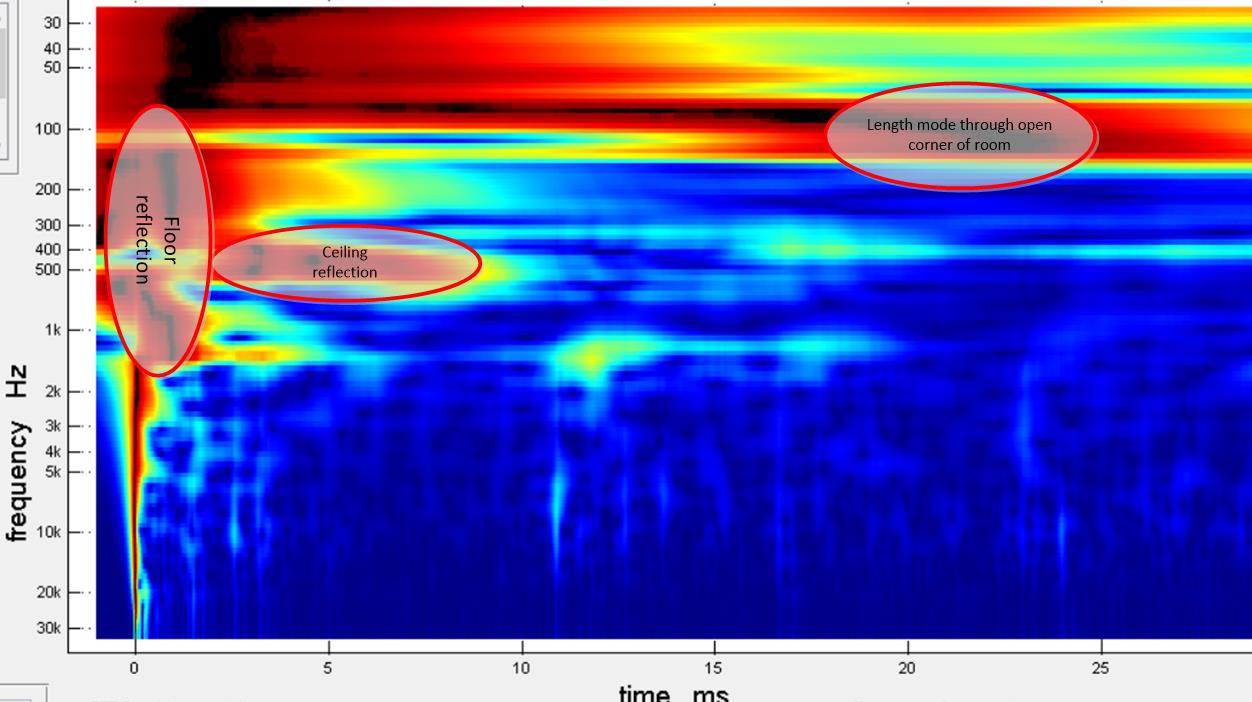

Here is the TDA graph with all the floor pads in place
Given that the floor pads are in place, the reflections delayed 2.6 ms - 5 ms are from the ceiling. I have confirmed this to some extent with an absorber pad balanced on top of a step ladder, but not while the floor was padded.
Its like peeling an onion, you have to get rid of one layer of reflections to get visibility into the next.
Wesayso: you and RA7 sidestepped these pesky floor and ceiling reflections with your tall line arrays. Walls are much easier to treat than floor and ceiling.

Compare the IRs with and without floor pads below. I've put dashed blue lines to highlight spikes taken out by the floor pads. The calculated path length distance for floor reflection is .91 ms (just remeasured) and 3.09 for the ceiling bounce. The 2nd dashed blue line is right where you would expect a floor reflection to come from. The spike lined up with the first dashed blue line is early, but the spike was eliminated by the floor pads.
This floor padding experiment shows that floor reflections come from the entire floor area, not a single spot; must be some scattering going on.

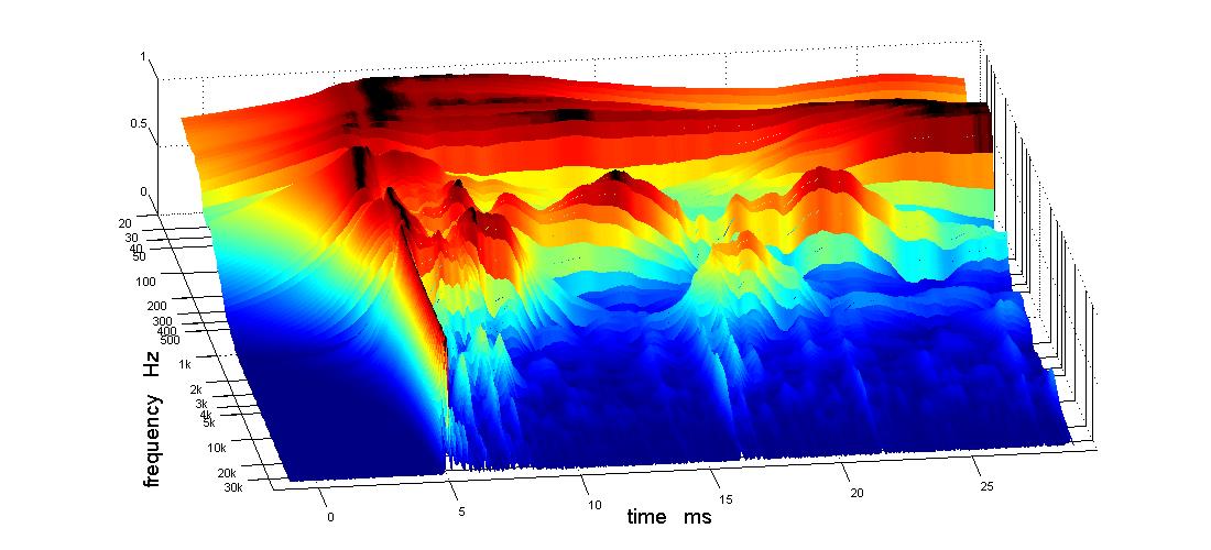

Here is where I think the major reflections are coming from
This was taken with the floor pads in place so it doesn't show the worst of the floor reflections but masking them allows us to see the ceiling reflections in the 400-500 hz range.
Notice how the floor reflection fuzz goes away around 1300 Hz where the horn gains vertical pattern control.

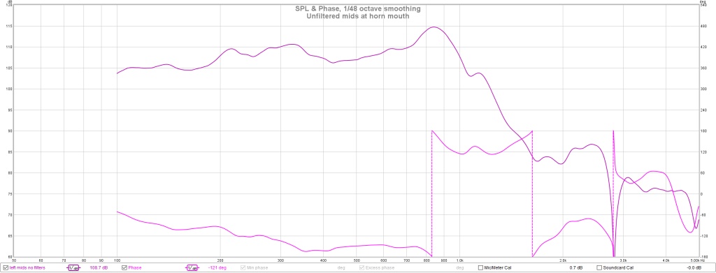

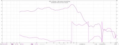

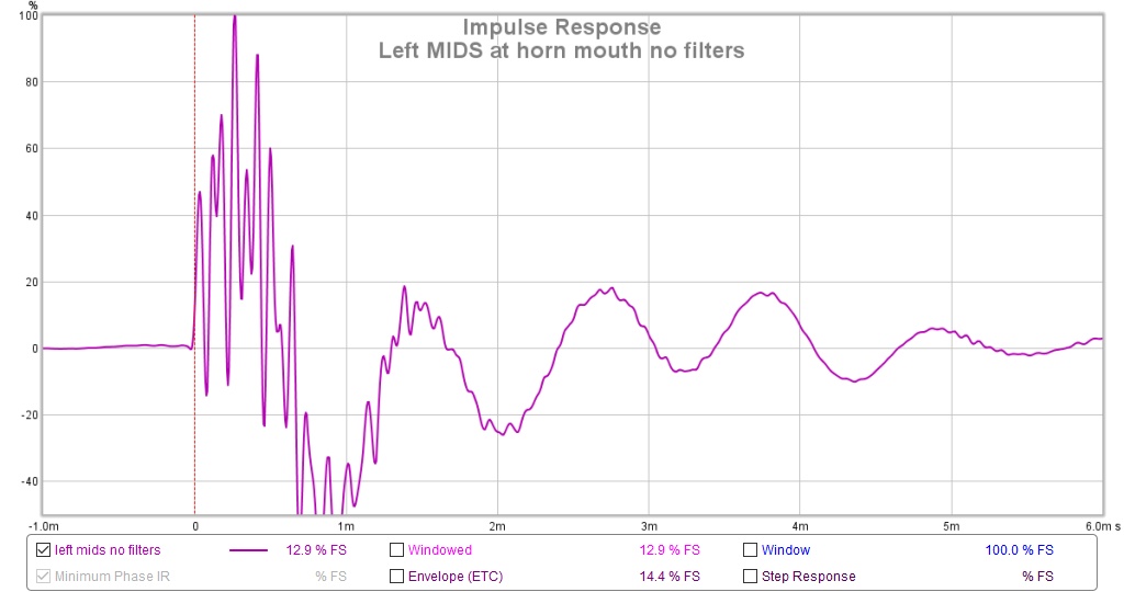

Something wrong with the mids
The mid frequency response looked so much like the simulation that I never looked at their impulse response. When I finally looked, I saw something wrong but I can't imagine what it is.
I remeasured these this morning with the mic at the horn mouth to keep the room out. I get the same picture dee[ inside at the mid ports, just higher amplitude.
I have two 4fe35 mids on each side wired in series-parallel using color coded wire which should preclude the possibility of getting some of them out of phase. The drivers themselves have different shape terminals for + and -, in addition to a red dot on the plus side. The long shallow chambers, just 1/2" deeper than the drivers are stuffed with polyester. They are sized to have no standing waves in the passband, except for the long dimension where there is enough absorption to absorb such a wave.
Fortunately, the covers are removable so I can check without too much trouble. Any ideas as to what to look for other than wiring errors?

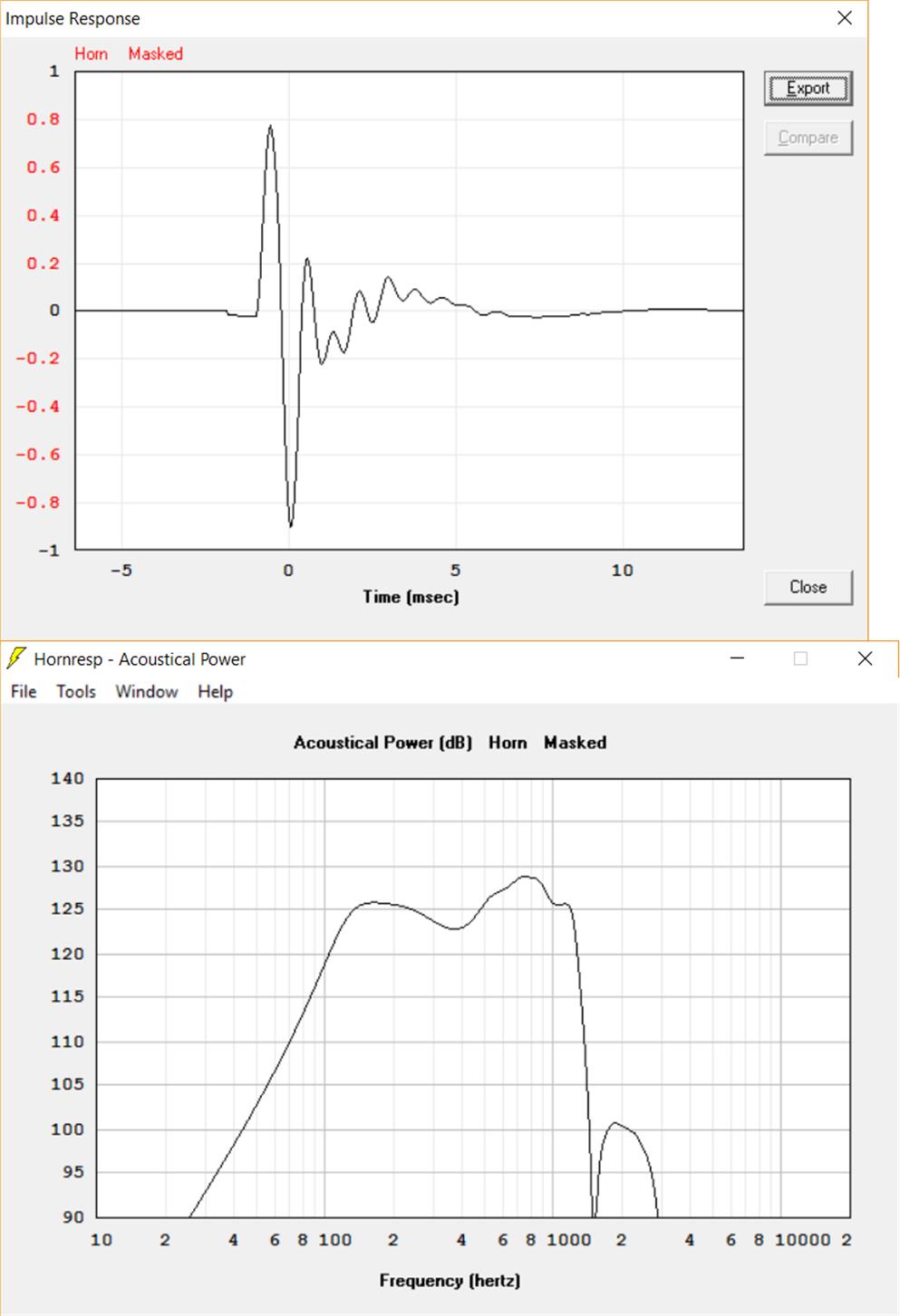

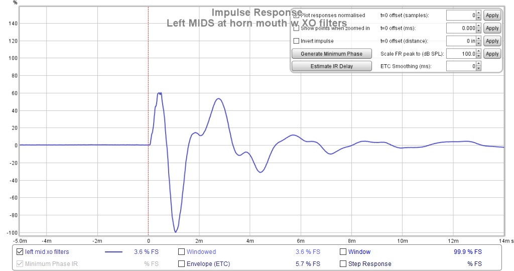

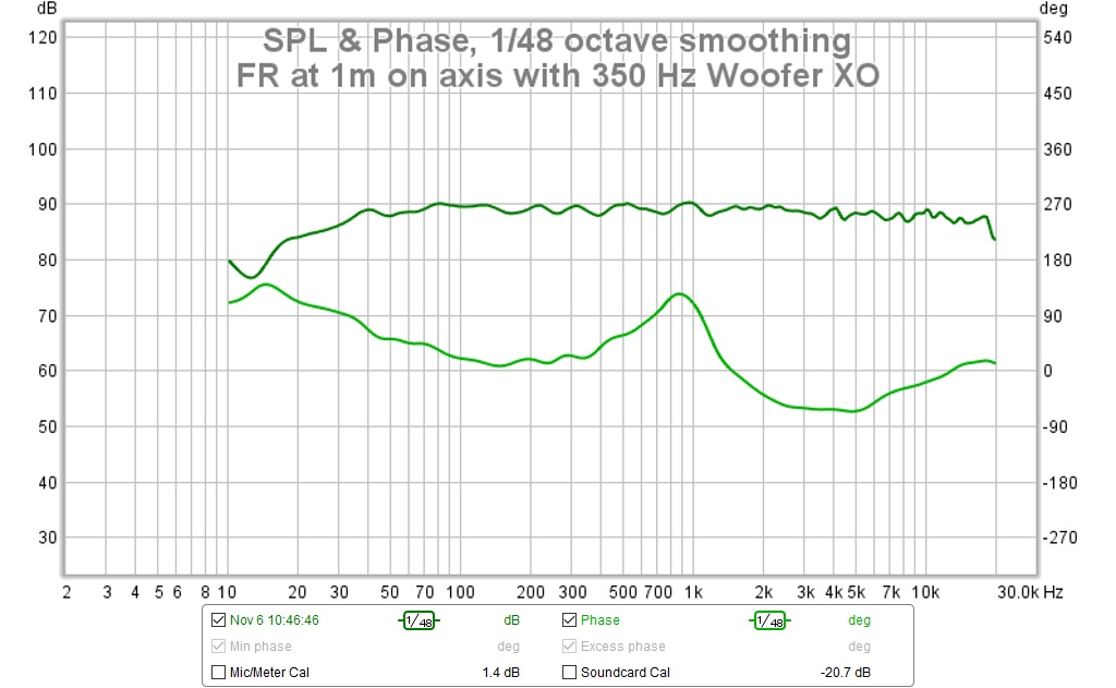

What kind of XO filter are you using? Theory (Hornresp) follows practice (REW measurement) pretty closely. Or the other way around 😉.
But I wouldn't want to slap on a named XO to get the desired crossover result. I'd want a filter that puts the real acoustic measurement into shape. That will change the IR and phase so we can have a better hand-off to the tweeter.
Don't be too misled by the IR without any filter at all. It probably shows some extra ringing at higher frequencies that (hopefully) gets filtered out with a desired crossover slope.
