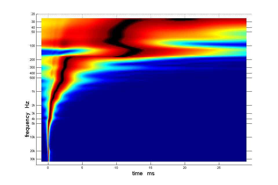

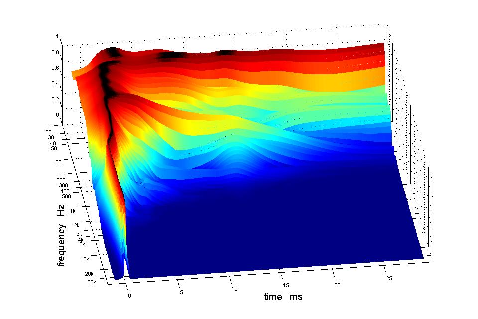

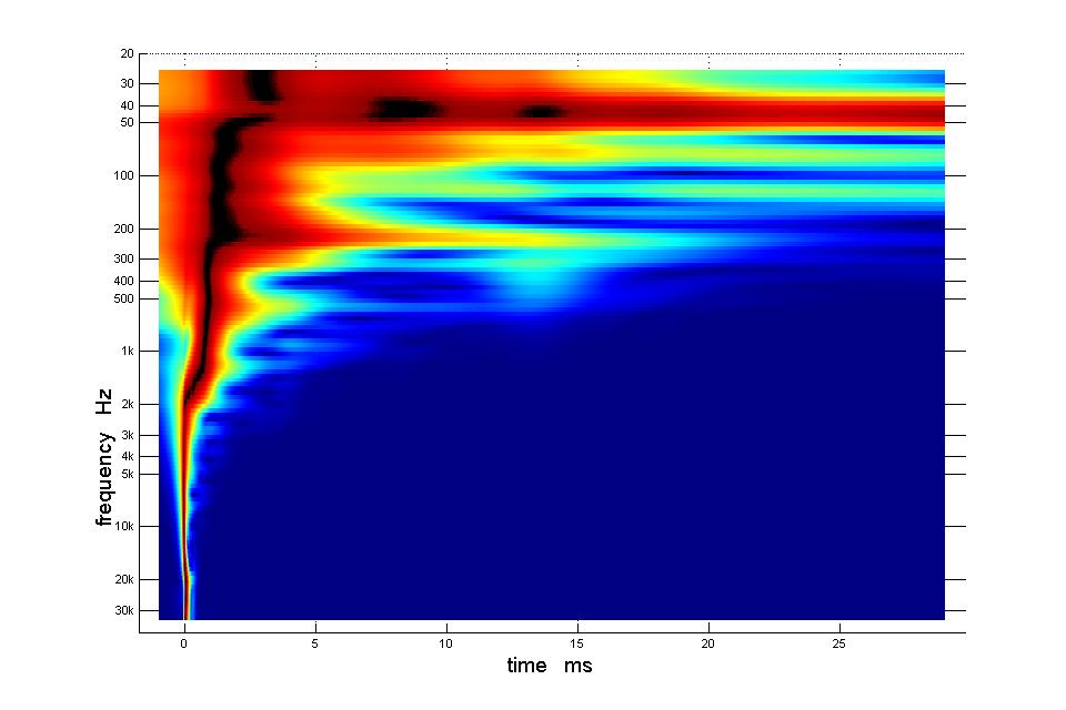

From the measurement, I get the familiar 3D graph, now a composite of multiple sweeps:
You can see the direct response standing out down into the midbass where it begins to bend due to the early reflections until its overwhelmed by a room mode lower down. The frequencies where this occurs is more readily seen in the "pl" chart:
There is that pesky dominant room resonance between 100 and 200 hz.

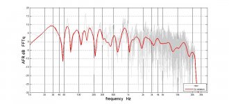

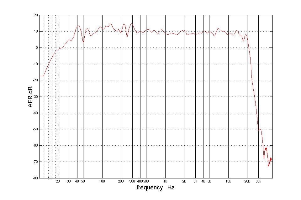

We also get the AFR and DFR curves, all pre-EQ:
There is also a more detailed AFRi to view:

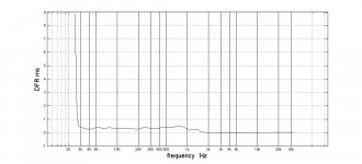

and then the GDR

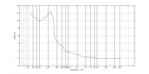

This GDR is very different from what you see in TDA measurements at 1m. THe delay curve is apparently being distorted by the early reflections as well as the room resonances.

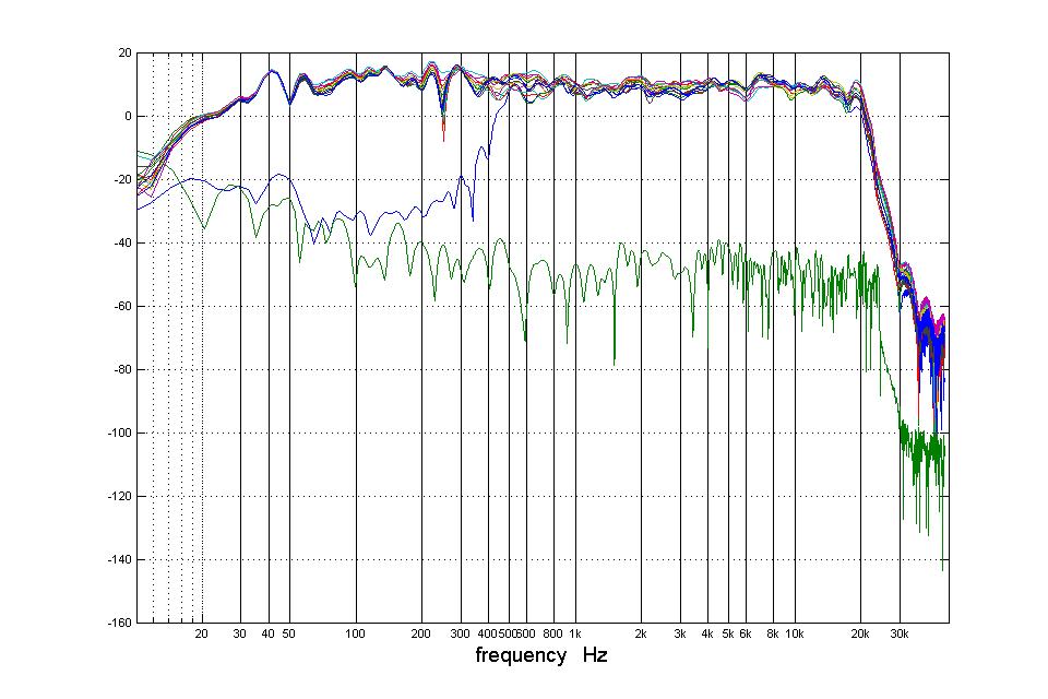

The "all AFRs" curve superimposes measurements from all the sweeps. The extent to which they line up on top of each other gives an indication of how successfull the EQ will be.
(every set of TDA_EQ measurements I've done has a "straggler" or two, IRs and corresponding afr curve that is anomalous. I'm not sure why.)

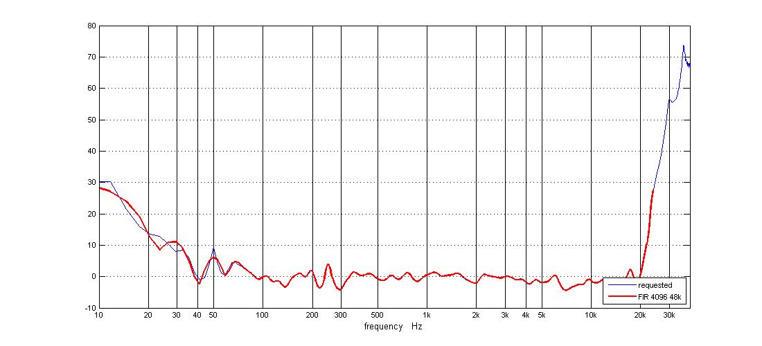

and then the correction filter itself:
I didn't set limits for this run so it is boosting bass all the way down to 10 Hz and treble up to 24 Khz. (sample rate was 48k) The correction looks like an inverse of the detailed AFR. The target/house curve isn't apparent in it but I recall Raimonds telling me that applying the target curve is a final post-processing step and doesn't show up in the graphs.

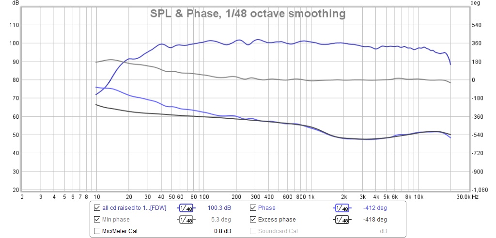

We also get post equalization graphs of "pl", AFR and DFR.
That clearly isn't as flat or as smooth as we'd like. How did it sound? Not much better or worse than the unFIRred sound. (There should be a Hippocratic oath for equalization software) I didn't like the sound with unlimited filter correction. When I set the limits it was much nicer. I wasn't driving the low bass into distortion or boosting the treble unreasonably.
My conclusion though was that there was too much room in the measurement for the software to deal with. Aside from treating the room more completely, my choices were to either measure closer to the speaker or restrict the measurement window. I did both but I'm out of time for now so will resume the story later.

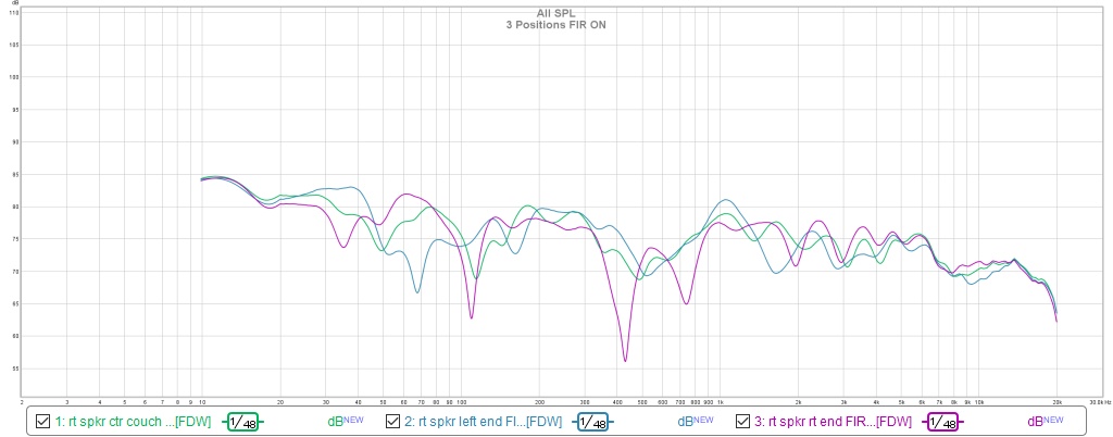

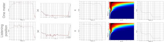

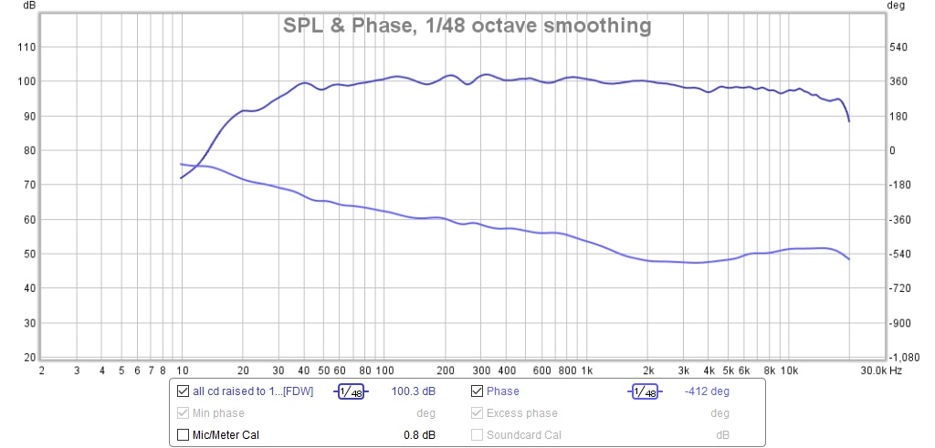

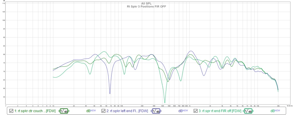

Here is what REW shows before and after the EQ:
At the couch, FIR OFF:
and FIR ON:
In the FIR ON picture, you can see my downward tilting target curve and bass boost but still a lot of room induced ripple. (Recall how smooth the earlier posted 1m measurement curves were.) The floor nulls are reduced but still present.
No I don't really want that boost below 20 Hz but it was there when I saved the picture. Listening, I liked the FIR ON a little better than off, probably responding more to the target curve than anything else.
and FIR ON:

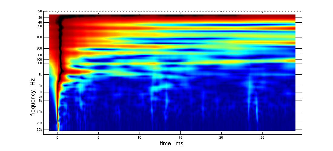

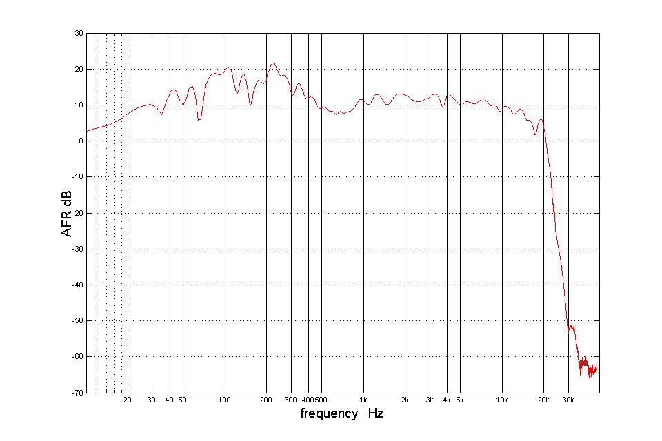

Let's now try at 1m from the speaker. I tried to confine the moving mic to the window that included the entire listening couch but excluded the rest of the room. Perhaps 8 degrees to 20 degrees off axis but just eyeballed.
The 3d at 1m is pretty much like what TDA showed with perhaps a little better discrimination against reflections due to the multiple measurements.
We don't really need the pl to see where the room shows up:

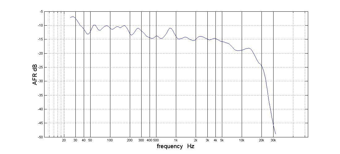

The AFR shows I did a decent job on the frequency response in the IIR XO
There are room induced ripples in the response but they don't down to zero so the response should be correctable.

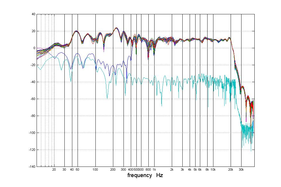

The all AFR chart is very encouraging:
but nevertheless has two outlier curves.
Here is the post EQ pl. Compare it to pre-EQ and you see it is sharper.

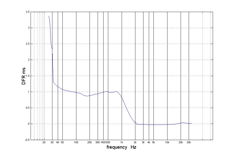

Here is the post EQ AFR. Its nicely flat, except for the dip around 1 Khz. There is an XO there but also some room effect. In the all AFRs, you see a horizontal band through that region rather than a thin line. Recall that the target curve doesn't show up in the AFR.

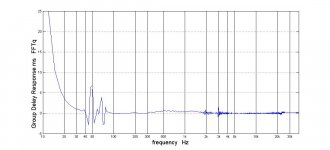

Finally the GDR. The delay hasn't been completely flattened but the shelf is only 1 ms high.

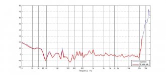

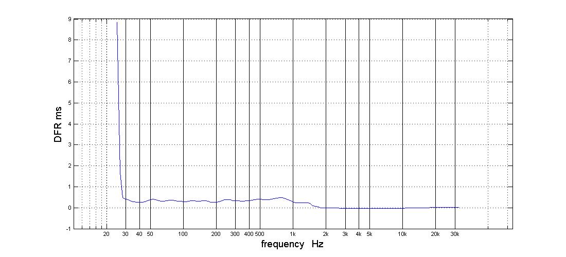

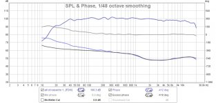

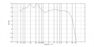

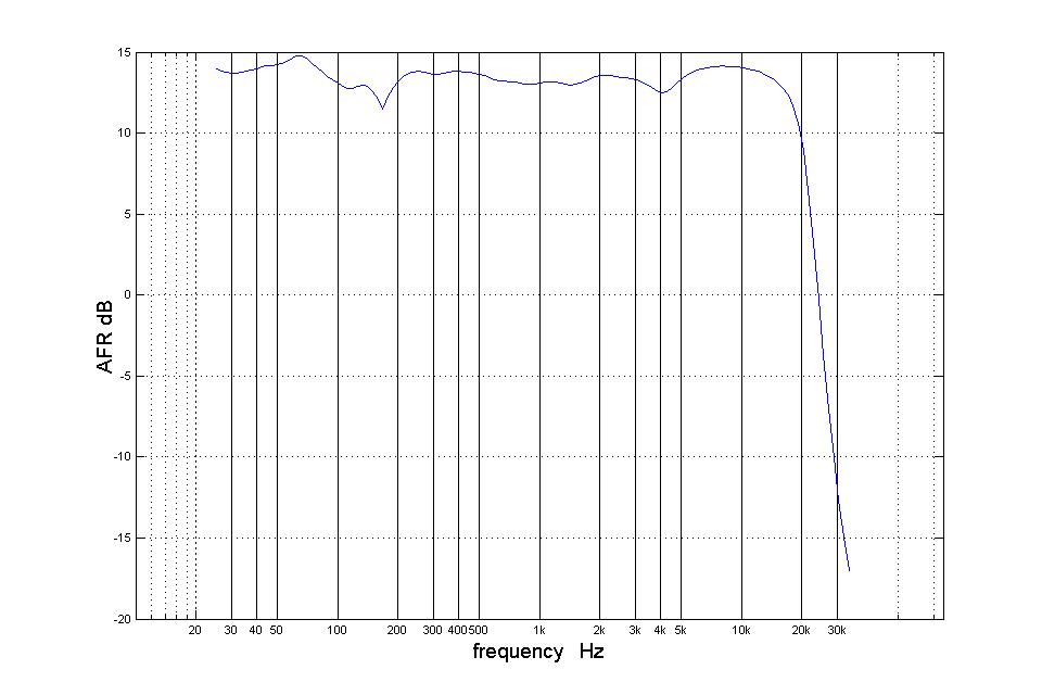

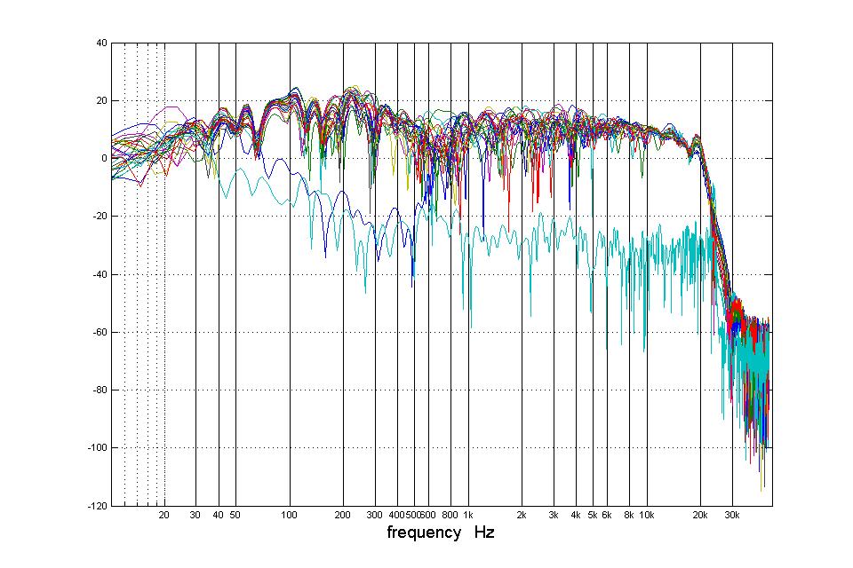

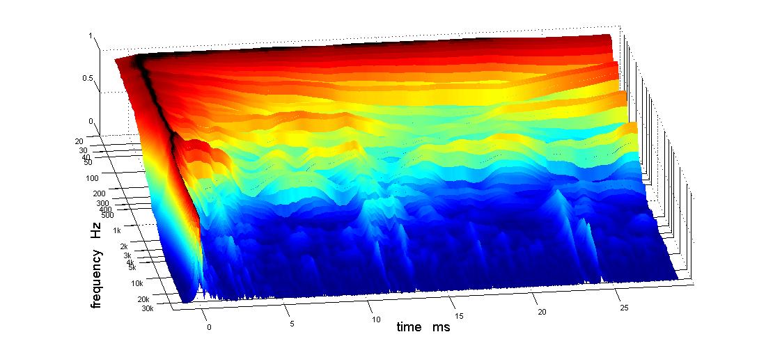

For my third try, I elected to restrict the measurement window to an approximately 2' square region at seated head height at the front edge of the center of my couch. The reason for moving forward was that the back of the couch is apparently in a null of the 150 Hz room mode and 2' forward gets out of the null, improving the signal to room ratio.

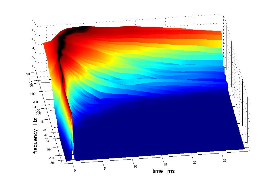

The 3d display was encouragingly clean with the direct signal separated from reflections down into the bass:
The pl
The AFR init:

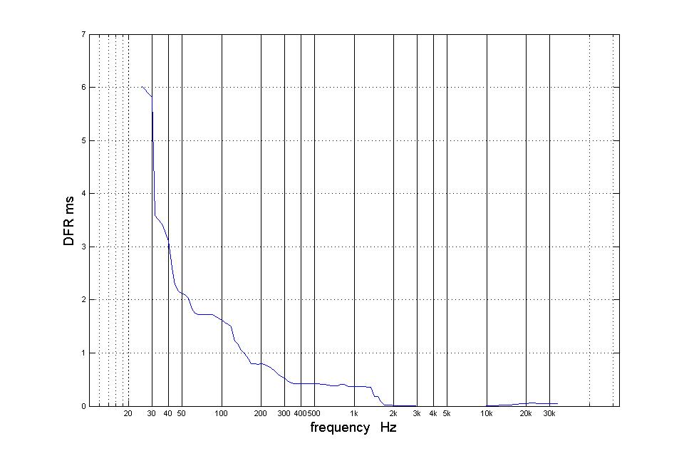

The DFR init:
And the post equalization graphs:
pl
afr
DFR
all AFRs
and the FIR itself
These post eq graphs look pretty much the same as the 1m graphs. That is one reason I didn't listen to the 1m correction. The other reason is that as soon as I started to listen to this one, I was hooked. Fortunately, I don't have to perch on the edge of my couch to appreciate it. It sounds good sitting on the floor in front of the couch and sitting all the way back at center. Its only slightly less good at the two end seating positions and that is more due to the image being pulled slightly off center there than the correction being audibly less correct.

yeah you got that right. My wife remarked that yesterday was my longest listening session ever.
The XOs use 12 db electrical filters to hit a 24 acoustical target slope.

Good plan Jack, we've got to keep in mind that the multiple measurement technique drops the room influence in these plots. But a single TDA measurement (or REW for that matter) will still show more room in the plots. If you're able to reduce that it will bring even better results out at the listening spot.
The more very early reflections you can avoid, the better the imaging. The later reflections will still alter what you hear but it isn't that negative of an effect in a lot of cases.
You might want to start with a normal ungated REW measurement at the LP (just in front of that couch) to see if the slight dip get filled in by room reflections.
There can be quite a perceptive difference with a dip at 1-2 KHz, depending if later reflections fill it in or not. Usually we suffer from Stereo cross talk creating a dip right there. Fill it in and you gain in "the sense of depth" department. With some reflections present (hopefully diffused enough) it could have the added benefit of perceiving that depth. But ideally at least the first ~5 ms should be real clean. That gives you a more focussed image.
Basically you fixed the speaker with TDA EQ, but you're still listening to speaker + room. Your brain is well trained (all your life) to ignore the room. If you want to listen to the room, record a song at the LP. Play it back on headphones. That will make it clear what your brain drops/ignores while listening at the LP. You could also listen to that recording played back on the speakers, but after that you'll have a much harder time to "not hear" the room. I should know, I've been there 😉.

BRYTT:
Thanks for pointing this out.
I originally EQed each driver in the XO to conform to the 24 db target acoustical roll off with the mic on axis at 1m. But later I realized that I wasn't listening on axis and so I re-EQed to be visually flat at the off axis angle corresponding to the center of my couch. In doing this I didn't pay any attention to the target curves for individual drivers; I simply EQed the result using a mix of input PEQs and output PEQs depending on resources remaining available in the MiniDSP. So yes, I'm guilty of hacking. I will take the lesson of your methodology to heart; its not one I haven't long known so much as one seemingly set aside when I retired.
However, looking at the REW measurement taken during the XO tuning, I see a small peak at 1 khz rather than a dip.
Just for the record, here is the same plot with a min phase trace added:
Jack
PS: REW says 1/48th octave smoothing but there is also 5 cycle FDW
The issue about the response at 1 Khz is still open. Is that the XO's group delay we are seeing there or due to the room?
Instead of waving my hands, I made a single point TDA measurement out at the favorable listening position. We are used to looking at TDA graphs so this is somewhat of an apples to apples comparison.
Here are the graphs.
3D with nearly a straight line direct response
"pl" showing a couple of resonances
The AFR
The DFR, mostly corrected
and the GDR with min phase subtracted, which should leave the XO's group delay (+non min phase room effects)
The AFR

TDA GDR min ph subtr measured ctr couch forward 2 ft with FIR ON.jpg54.6 KB · Views: 376
The TDA 3D out at the LP looks pretty good and shows better delay characteristics than predicted by TDA_EQ. It is a single point measurement, as opposed to the average of multi-point measurements presented by TDA EQ, and it was taken in the center of the sweet spot.
Looking at the "pl", I see quite a lot of room resonances. It seems to me I would get the best ROI on time spent cleaning them up rather than spending more time on equalization. After all, its the room effects that limit the equalizer.
I guess the next question is what does REW see there but I'm afraid to turn the system back on. In my haste to shut it off to go to lunch, I turned off the minidsp first and instead of last and got such a "CRAAACK!" that I fear for my CD/tweeter.
