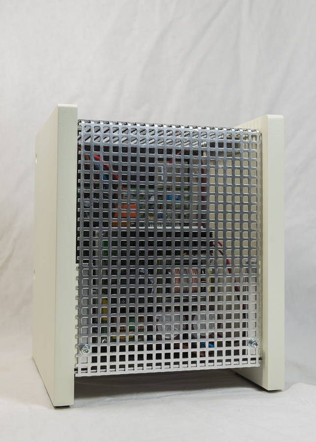

Calpe, don't be afraid of excessive heat. Your setup has plenty of natural cooling available. Some people are chasing ghosts...
And I would avoid using a fan since that make too much noise for domestic listening environments.

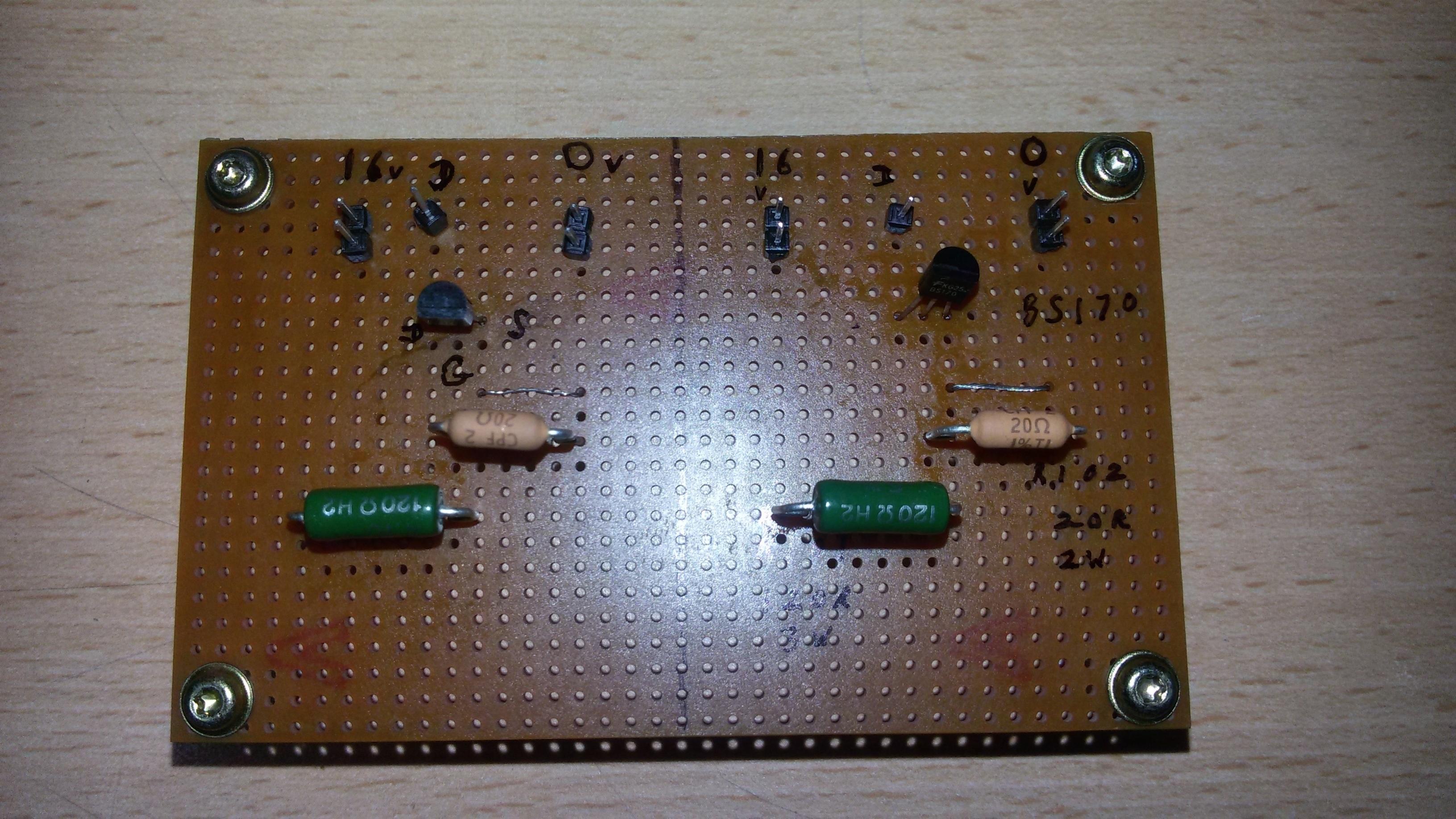

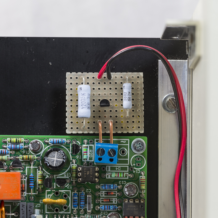

A small update in my project for the speaker relay switch off if using a SMPS.

I'm not sure I understand exactly how the old circuit and the new circuit are supposed to work.
But I try to explain what I see.
Old circuit.
40V arrives at K7. Flows through either diode to leave ~39.3V at R19.
assume 1.5Vf through the LED. That creates a current of 1.25mA through R28.
Current through R19 = {39.3-1.5} / 27k = 1.4mA
Therefore current through LED ~ 1.4-1.25 = ~0.15mA
That seems a bit low
New circuit.
16+16Vdc arrives at K7 after the FET switches ON.
assuming the same 1.5Vf for the LED, the current flow through the two 1k5 resistors will be ~ {32-1.5} / 3k = 10.17mA
Current through LED will be 10.17-1.25 = ~8.92mA
That seems high. Why such a big change from 0.15mA to 8.92mA?
Current through the new resistor R101 & R102
32V/140r = 228.6mA
WHY?
Pdis in R102 = 0.2286²*20 = ~1W
Pdis in R101 = 0.2286²*120 = ~6W
Why?

16+16Vdc ????
I'm using +16 volts of the AUX output. So your calculations are incorrect.
I do however use a quite high current (about 100 mA) in the voltage divider. As mentioned previoulsy, I do that to discharge the power supply's output caps fast. That will also help disengage the speaker relay faster when power is removed.
9 mA to drive a LED is not high at all... Moreover, according to the datasheet of the 4N25, the LED current can be as high as 50mA (which is high)... But in the above case, the LED current is about half of what you calculated (16 volts supply, not 16 + 16); in other words about 16 - 1.2 / 3000 = 4,9 mA.

If that 40V is 40Vac, then the peak current will be ~ 50% higher than the calculated 0.15mA I gave. ~ 0.2mA
New circuit
for a 16V supply it is much better than half.
{16V-1.5V}/3k = ~4.83mA
Subtract ~1.25mA through the byapss resistor gives ~3.6mA through the LED. That seems much more sensible. I'm glad you were awake and corrected my mistakes.

What a pleasure to see the experts with the calculations, which has now been settled, with thanks to delange for the Cct.

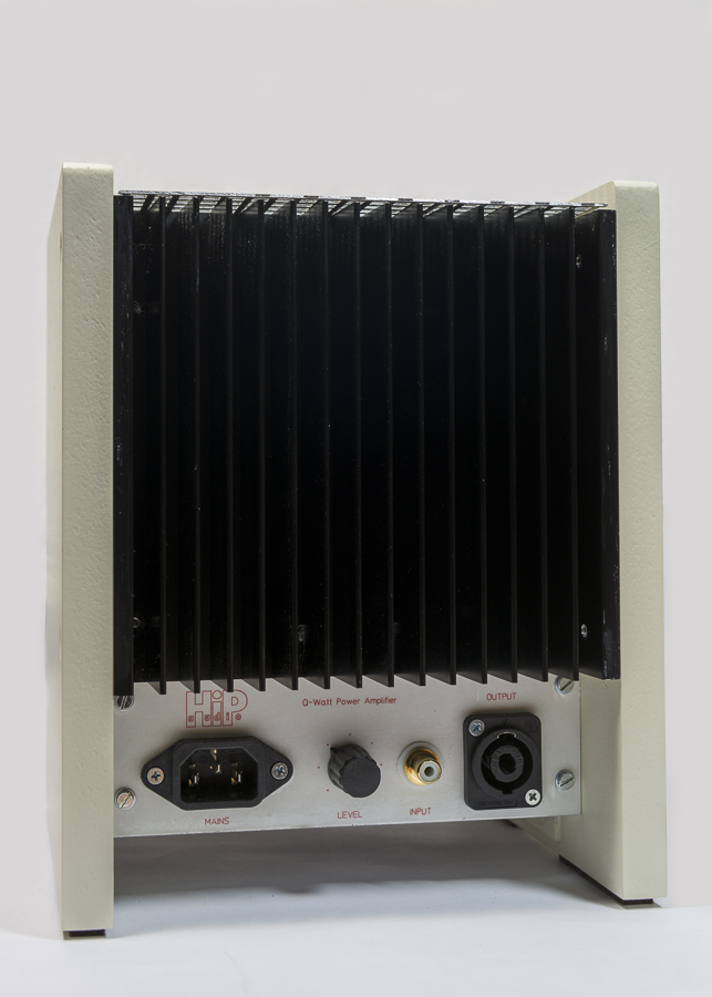

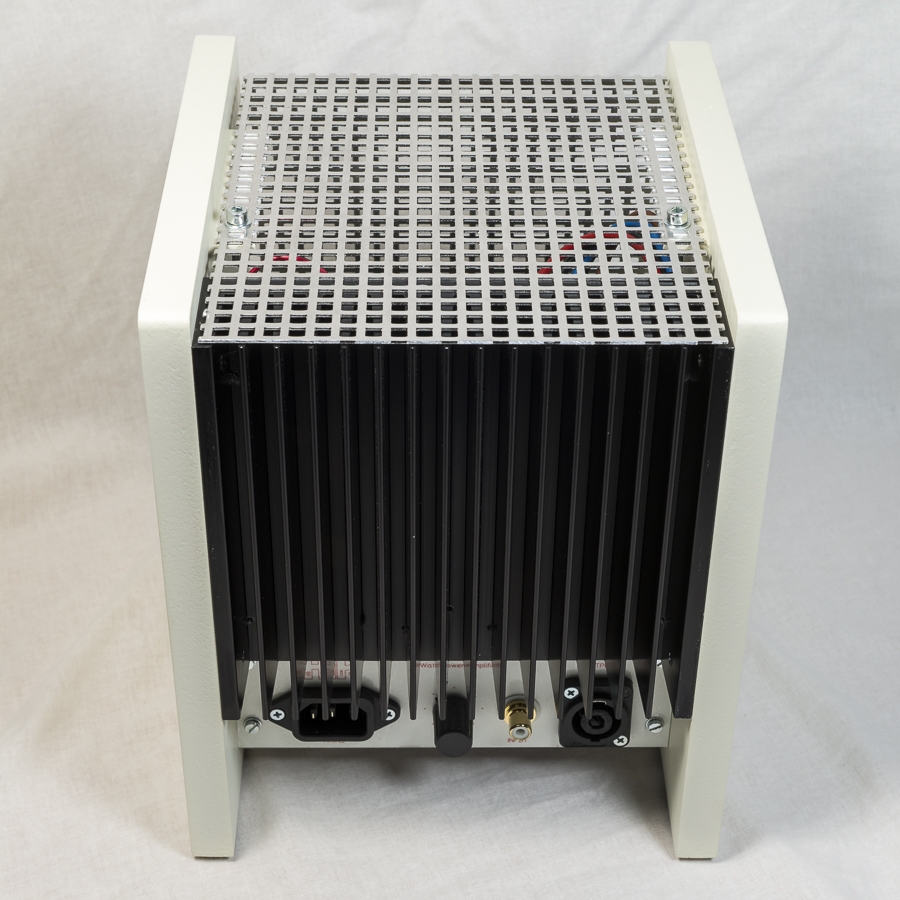

Finished the enclosure of my first channel this week. I have been debating what kind of finish to use; I've considered carbon fiber, aluminum and wood. I finally decided to use wood and paint it in a light color. Since the amplifier will be sitting behind the speaker, the idea is to be "incognito" as possible.
During my testing I've use the amplifier on the floor and against the wall behind the speaker. The heatsink is facing the speaker so that the connectors and volume pot is easy accessible.
Using the amplifier showed that I would like a power LED to indicate it's powered on. I will be modifying this channel during the course of next week.

I see you have a level control at the rear, could you explain a little?
I'm delayed, but hope to mount transistors on heatsinks this week and wire up etc.
Many devices use a very high output signal today. The "standard" seems to have evolved to 2 volts for 0 dB. As you have seen in the specs, the Q-Watt amplifier input sensitivity is 0,88 volts for 137 watts (0.1% THD+N).
This means that you would need to use an attenuator in the chain in order to keep the amp in its safe area. That's why I have built in a potmeter to adjust the level (volume if you like).
delange, that was my thought when I questioned the Elektor techs about the levels and I was more or less told to keep the volume low!
