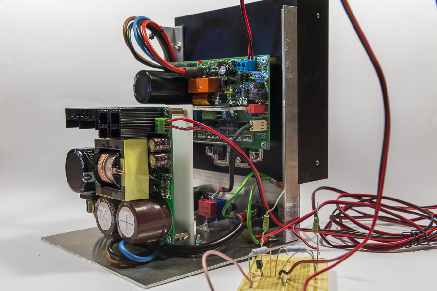

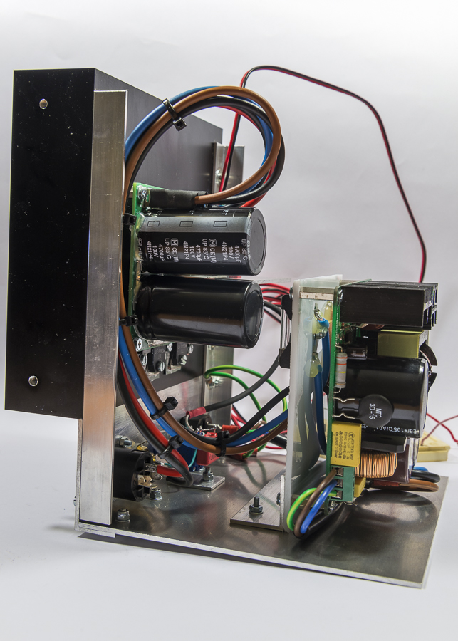

Another update on the project.

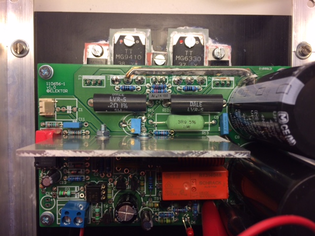

It is all slowly coming together. Yesterday I replaced the potmeter by a 12 turn potmeter from Vishay. Adjusting the idle current is a breeze now.
I did some testing with a FET switch in order to switch off the relay immediately when the amp is switched off. Since I'm using an SMPS I needed to modify the circuitry around the voltage guard. I'm using the SMPS's aux output for that but the buffer caps fitted on there are quite large and kept the relay on too long. The FET switch solves that. I need to find a nice way to install the circuitry in the amp. A part of the FET switch circuitry is on the test board in the attached pictures.
I put the enclosure together and finished the cabling in the amp. The enclosure is not finished yet though. I still need to build the rest of the enclosure. But I'm still toying with a few options for that in my mind.
Up until now I've been testing the amp with some cheap speakers I use for testing. The amp sure sounds promising and I'm thinking of connecting the amp to better speakers tomorrow to have a listen.

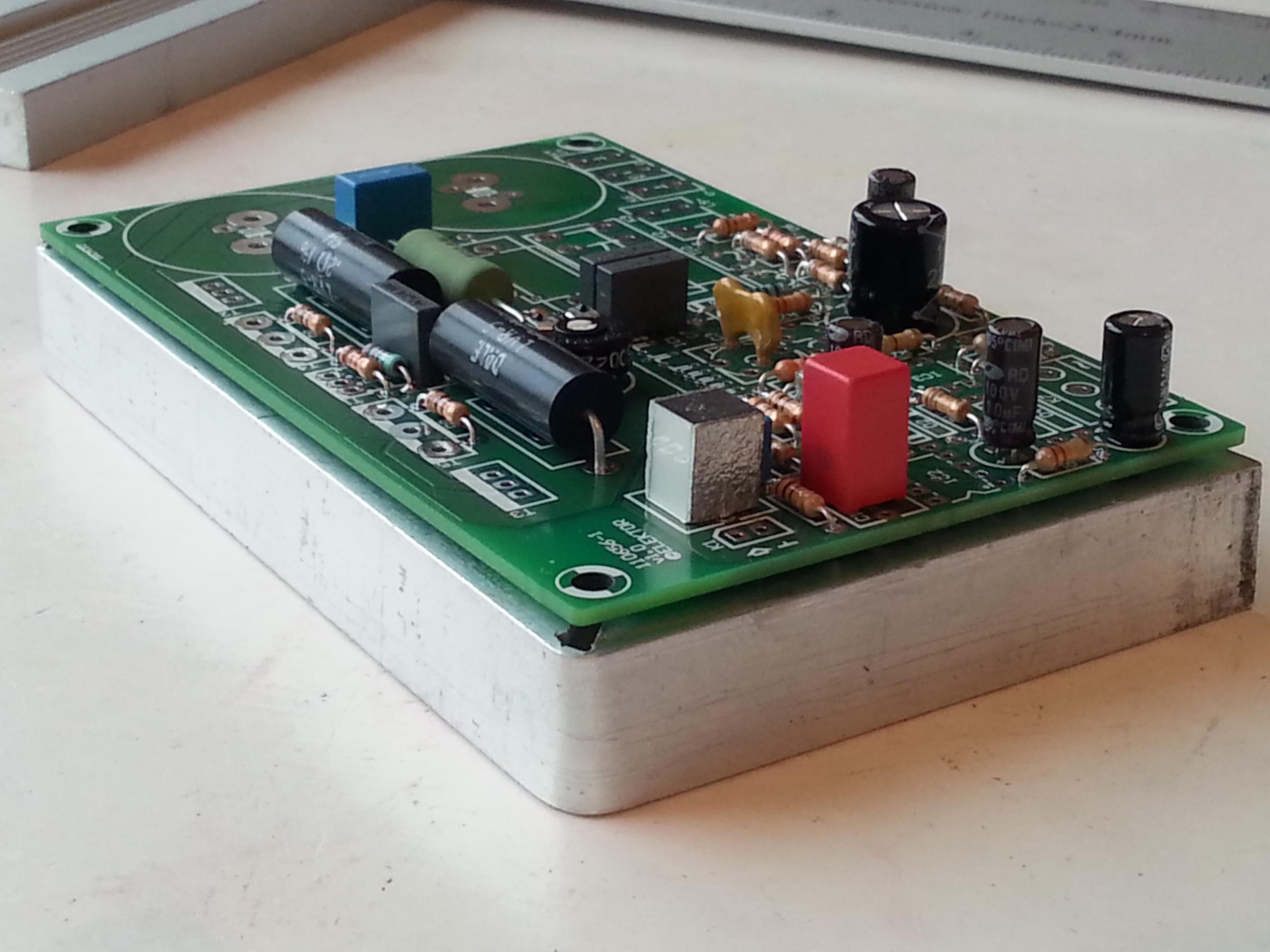

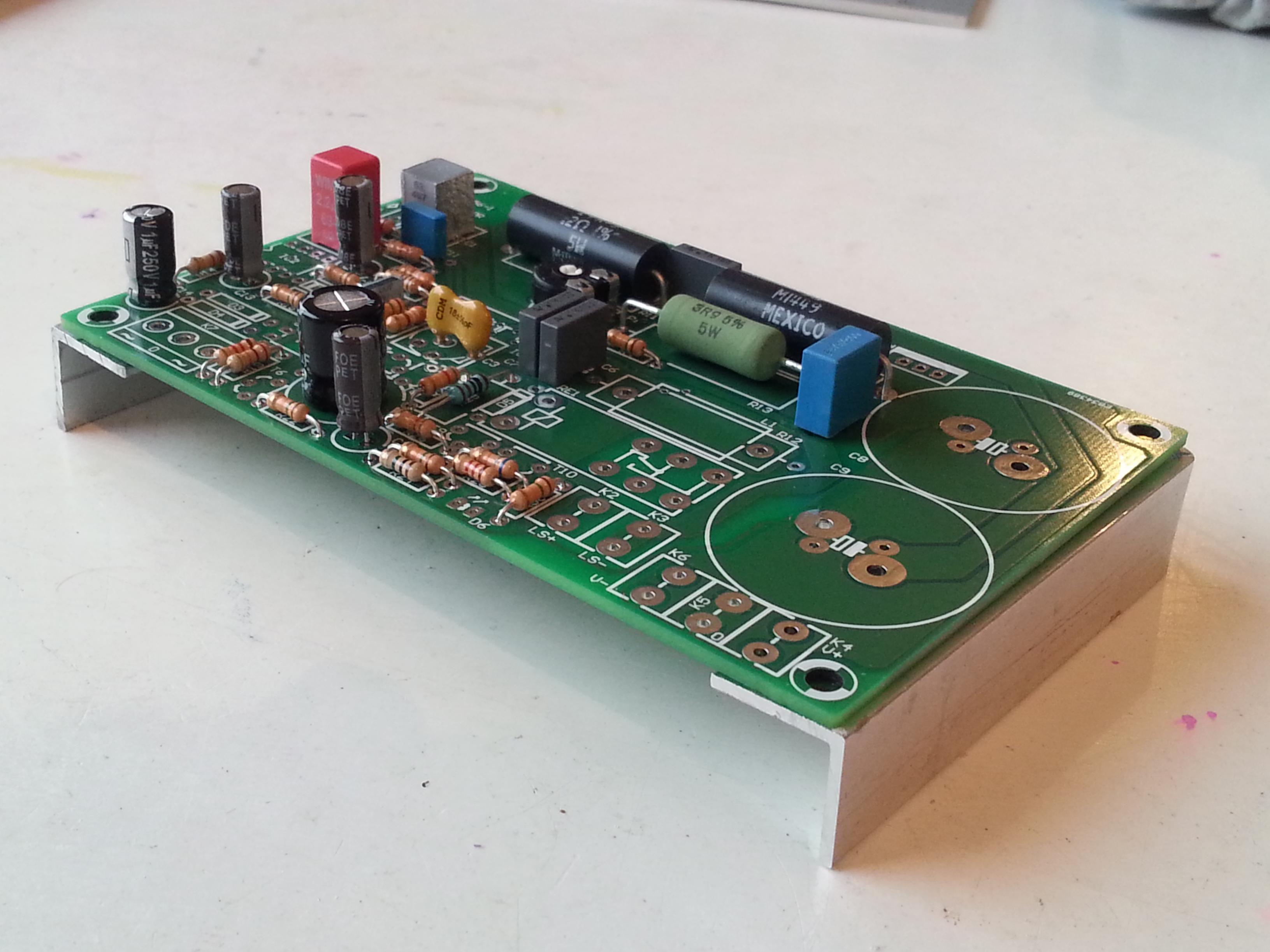

PCB mounting to heatsink

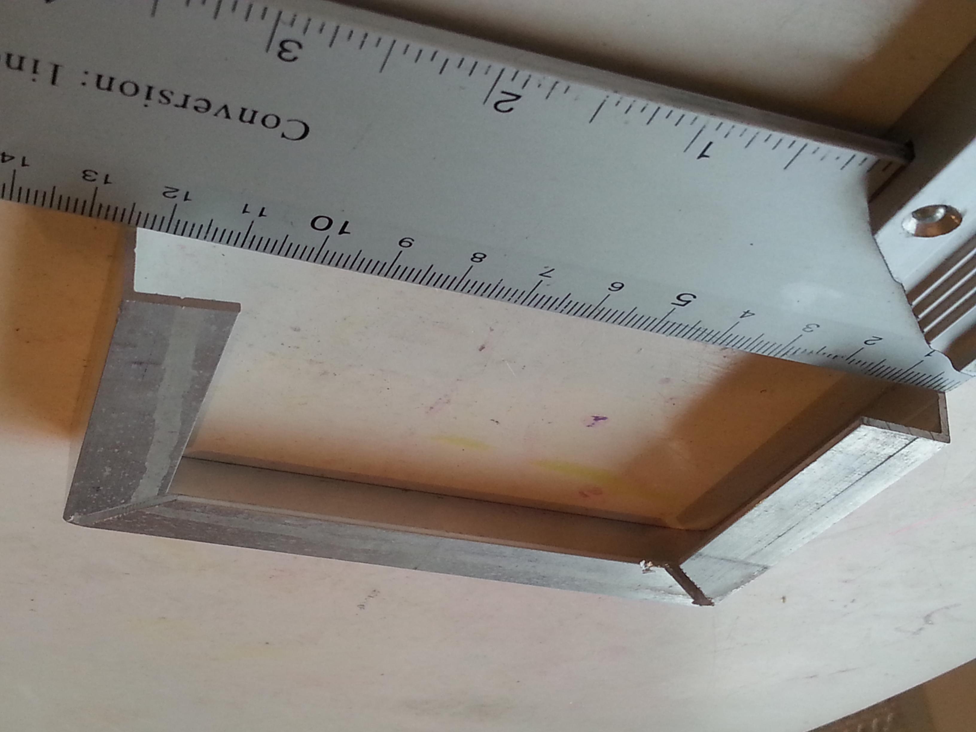

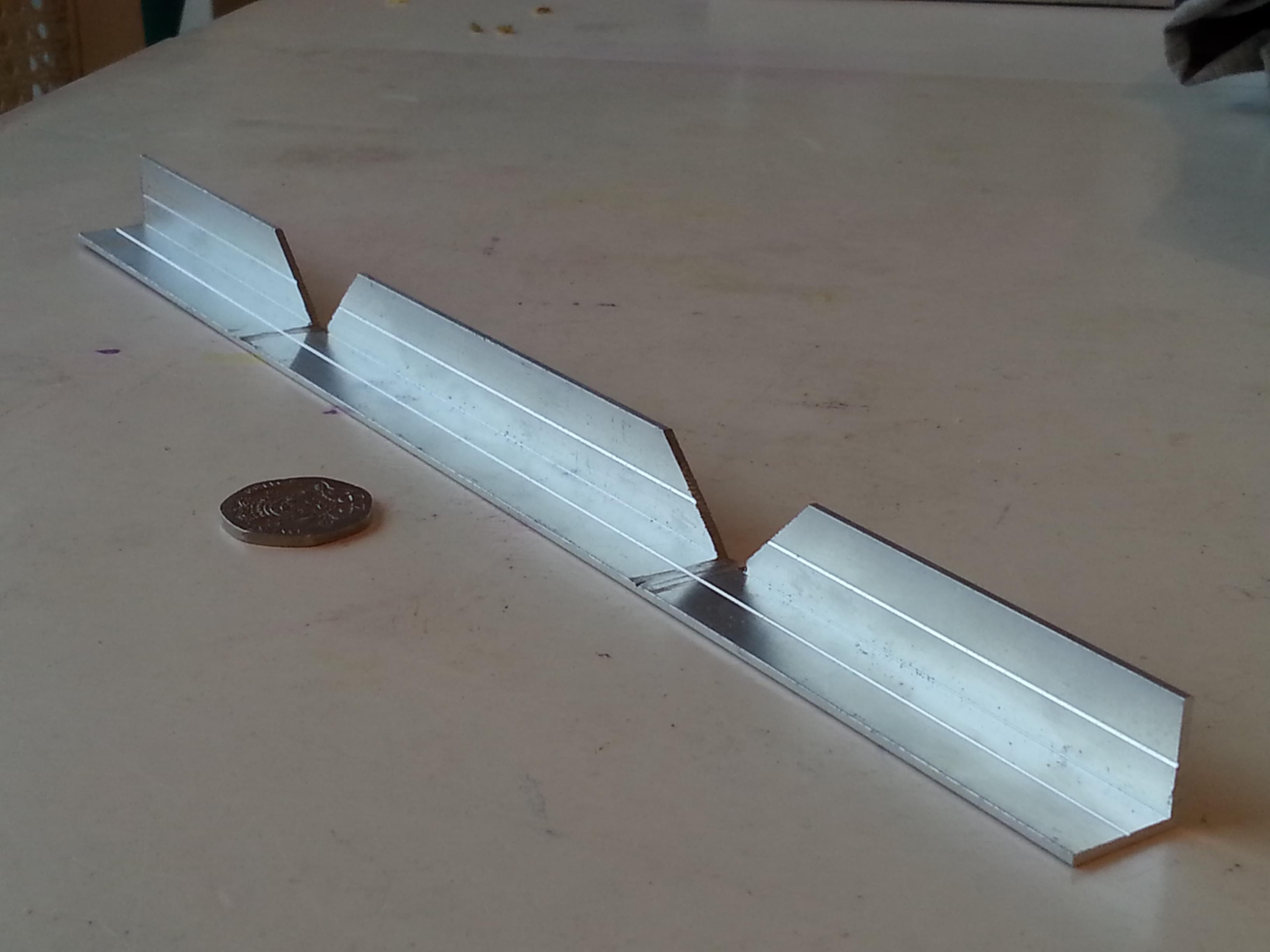

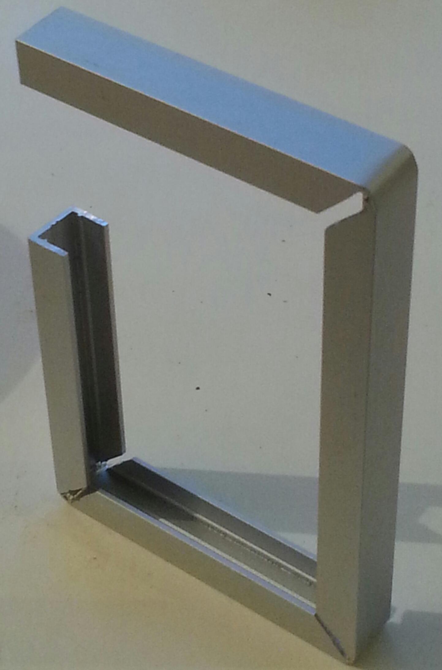

I tried cutting 45deg slots in 15x15mm angled aluminium to form the pcb holder. Was quite successful, but the one - sided angled stiffener tends to warp the top surface when bending by hand. U - section aluminium would work better. Might try that after a few shandies later.
Delange - Which part number? Sorry if you already said, but I could not find one with same pin spacing. Did you have to bend it around much?
I used a 12 turn Vishay potmeter. It is quite a bit smaller than the original potmeter but it is very easy to mount it.
Vishay 74W 500R Spindeltrimmer 12-slagen Lineair 0.25 W 500 ? 4320 ° 1 stuks in de Conrad online shop | 423947
You actually would only need to bend the middle pin. The other two pins fit directly in the holes on the pcb. However, I did bend all three pins to move the potmeter a bit to the left. This is easier for adjusting reasons. The adjust screw would otherwise be directly underneath the screw that holds the heat sink to the LME49811. I have attached a (crappy) picture of my pcb.
Nice work.
From looking at the pictures I think you might have some trouble with the two mounting screws on the back (on the transistors side). These holes seem to fall right into the cut in the aluminium bracket.

Calpe, the cap trimmer has nothing to do with the idle current.
I replaced potmeter P1 with a Vishay multi turn potmeter. It is P1 who is responsible for setting the idle current.
You are right... I haven't really decided what to do about that. I am working on neater cuts with u - section ally, but still one bolt will fall in the crack. I might just put a big washer on each side and use nut and bolt.

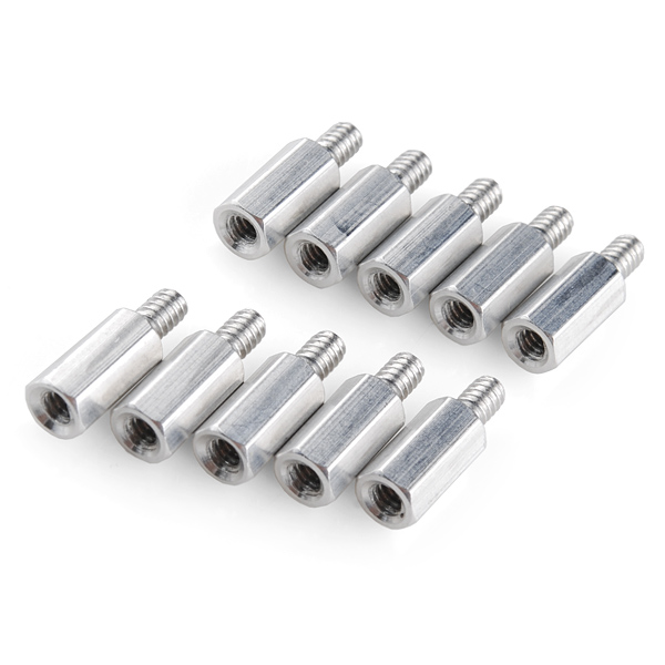

I have never mounted a PCB: what kind of spacers should be used to lift up the PCB off the bracket and to insulate?
I typically use metal standoffs with M3 thread. Depending on the situation, these are either female - female or sometimes male - female.
