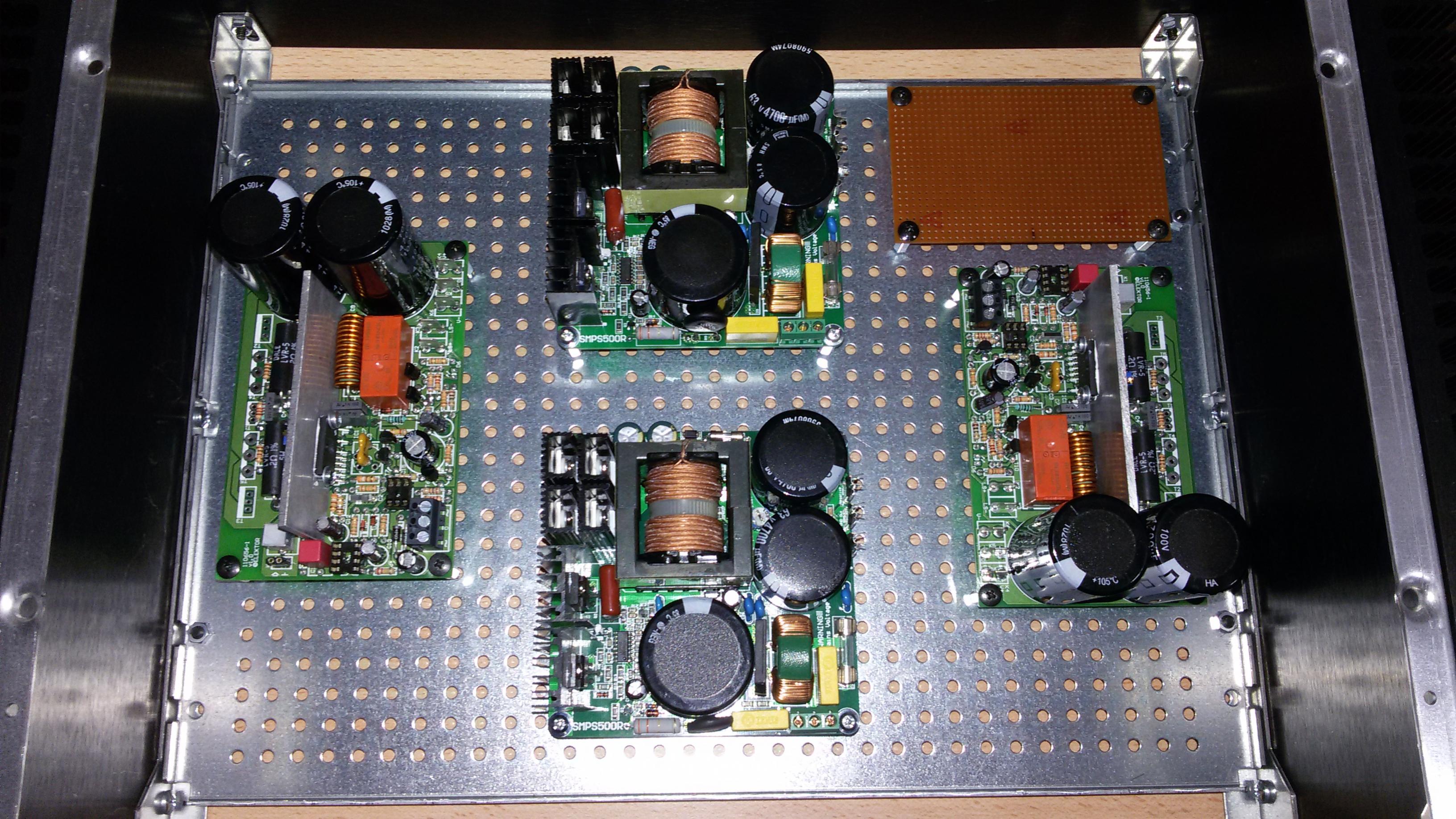

Hi Calpe. No SMPS here... just oldskool screwcap caps joined by a copper ground plane. Would love to fit in a 10mH 5A inductor between the caps, but values would have to change for some and there is the risk of a voltage surge (above 60V) during the inductor settling time so I just don't have the confidence to do it. Shame though... simulations show the 100 Hz ripple reduced to 0.3V at full load, and nothing would survive at higher frequency. Effectively forces the final reservoir cap to charge continuously instead of in tiny 100 Hz zaps.
Too expensive and too big. I'm completely over it as you can see.
I'm going to print off and scale check the drilling template, mark the centres for 5 holes and use a mates drill to drill them. Will then test fit with standoffs and then drill the support holes. Then finally solder with supports in place.
I'm undecided about multi-turn trimmer. Costs about €13? I'm tempted to get the linear power supply up on an old (35 years...?) 35V 625VA tranny I've been gifted just to check my losses. Then I'll order 2x 37V probably or 37.5V maybe. With my scrap tranny I will check out the first channel and if it's as bad as people say then I'll fork out for the multiturn trimmer for the second channel.
The first Q-Watt channel I've build has been running for over a week in my main set. It is running on the right channel of my set. The left channel is driven by another power amplifier. The Q-Watt sounds very good and I'm happy with the SMPS. I can't hear any noticeable difference in sound quality between the two amps.
I still need to finish the enclosure. There's still a debate going on in my head about that... 🙂
I will probably do something like in the attached picture although I'm not sure what material I will end up using (and what finish). I will probably close the enclosure with a piece of aluminium plate with square holes in it (don't know the correct name).

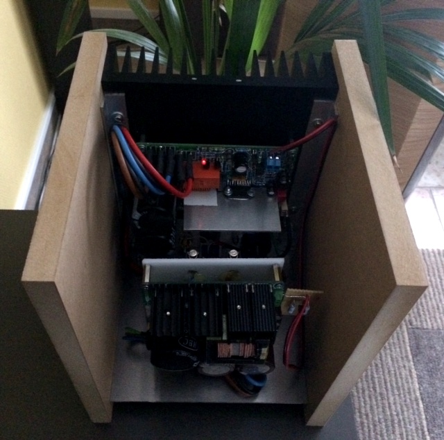

I put the enclosure together and finished the cabling in the amp. The enclosure is not finished yet though. I still need to build the rest of the enclosure. But I'm still toying with a few options for that in my mind.
If the bottom plate marks the dimensions of the amp, then your SMPS won't be happy in this position in the enclosure. The back will block more than half of the airflow of the heatsinks.
Hi Calpe. I think you have no fan right? So just convection cooling of the SMPS? It's a shame that it's not easier to mount the whole SMPS on your main heatsink.
Are you using 2x 500VA power supplies? So I guess for domestic use you won't normally use more than 10% of this.
Is there any way to make a thermal link from the SMPS to the steel base plate? From memory, the SMPS is 90% efficient right?
The bottomplate indeed markes the diamensions. However. The front and top of the final enclosure will be "open"; I'm going to use a perforated aluminium cover (square holes) to cover the front and top. This will allow more than enough airflow inside the enclosure.

I'm sure it's not needed for the low duty cycle with Q-Watt.
Would need to think again if using the SMPS at full rated output. Would need forced cooling.
I'm not worried; I have used my first channel for over a week in my system. During the whole period the Q-Watt amp and the power supply stayed very, very, very cool. Even at higher listening levels.
As you say, in domestic systems the amp will never run at high levels continously and as a result willl never develop high temperature. Regular airflow cooling is sufiecient; even in my "small" custom build enclosure.
