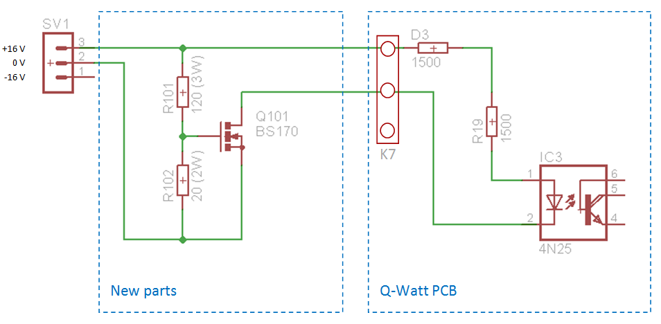

For those of us using a switched mode power supply instead of a traditional power supply with transformer, bridge and caps will need a slight modification to the way the "voltage guard" is implemented on the Q-Watt. The original design uses the dual 40 volts AC from the transformer to feed a 4N25. When this voltage is not present then the speaker relay will not be switched on.
The idea is that the relay is switched off as soon as the power is removed to the amp.
With the SMPS there is no dual 40 volts AC. Instead I'm using the aux output of the SMPS for this purpose (dual 16 volts). In order to make the relay switch off immediately when the power is switched off I used a FET as a switch together with a voltage divider. The divider is set to draw about 100 mA so that the buffer caps discharge relatively fast when the power is removed.
On the Q-Watt PCB you do not need to solder the parts D3, D4, R19, R20 and C14. I used a 1k5 resistor for D3 and R19 on the Q-Watt PCB. The voltage devider and the FET are external to the Q-Watt PCB (on a breadboard). The simple schematic is attached.

Why such high wattage resistors for R101, 120R 3W (RS Code
485-1903?) and R102, 20R 2W (RS Code 850-5512?) ?
The BS170 can be found here BS170 | Fairchild BS170 N-channel MOSFET Transistor, 0.5 A, 60 V, 3-Pin TO-92 | Fairchild Semiconductor
That resistor is dissipating 1.5 watts. It is good practice to double the resistor power rating. Notice that the 20 ohms resistor is a 2 watt version.That one is dissipating a lot less.

The 1K5 resistors i assume are 0.25W?

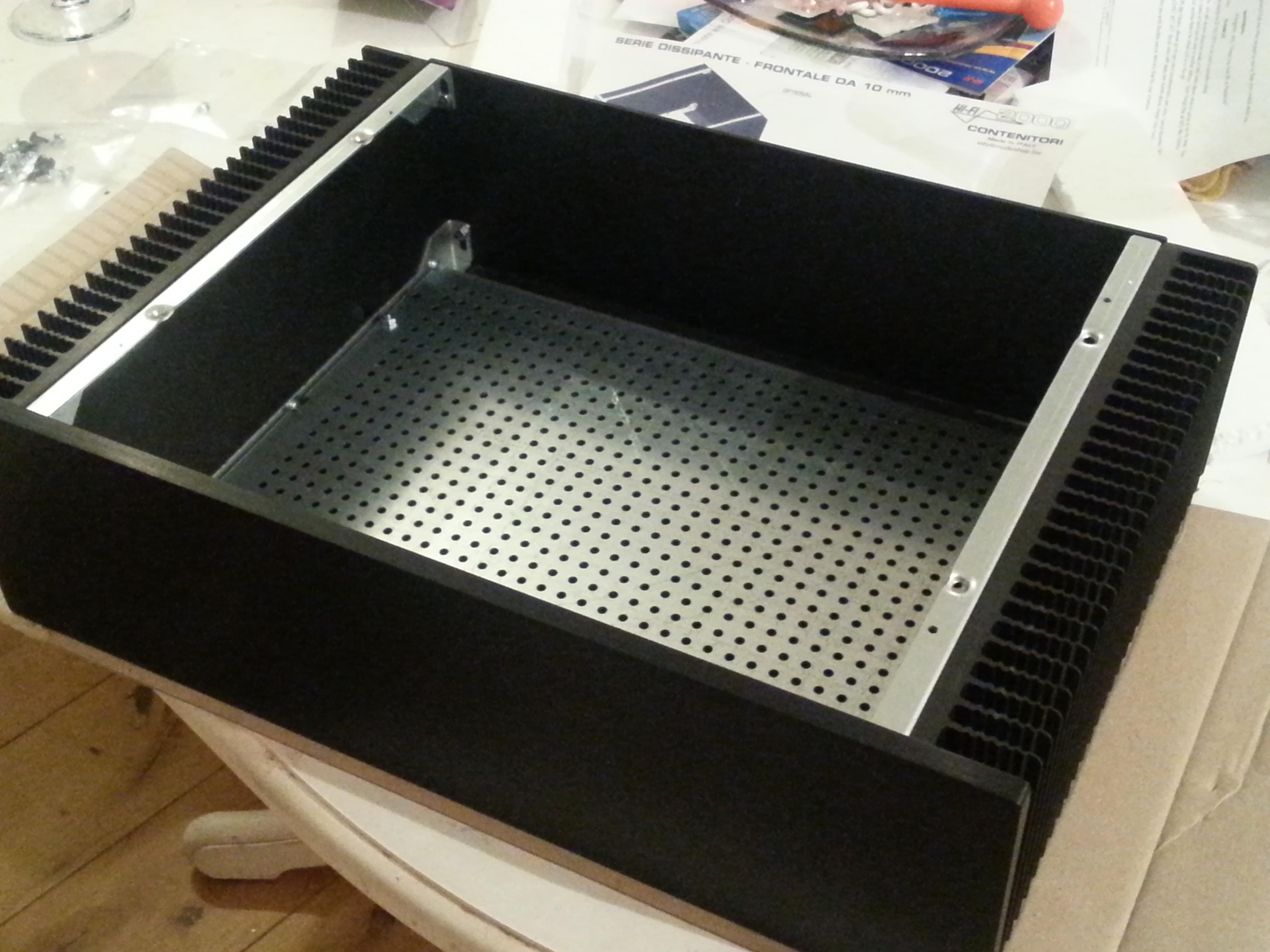

Popchops, can you tell me what heatsinks you purchased from Modushop for the U3 Dissipante case?
As you know the original ones in the Elektor article were '0.7 °C/W, 40 mm, 200 mm, 100 mm Farnell Code no. 4621890'.
Hi Calpe,
Yep the 300mm x 3U Dissipante case includes two 300x120x40mm heatsinks that form the case walls. Far exceeds the spec because I need the depth.

Popchops, thanks immensely for the case dimensions etc.
Popchops, as you have probably seen the heatsink in Elektors project is listed as '0.7 °C/W' - height 40 mm, width 200 mm and depth 100 mm.
Not sure if i'm looking at the correct Modshop case, as i thought the temperature coefficient was fractionally lower at 0,5 C°/W?
To make sure i order the correct one have you please got the Modshop order no. for the 300mm x 3U Dissipante case?
And also the rear/front plate, please.

Hi Calpe! The dissipation coefficient of my heatsinks I would expect to be about 0.5 deg C per Watt. This is better than the 0.7 required by Elektor I.e. lower temperature at the same power.
The 3U case is the one with internal dimensions 360 (w) x 300 (d) x 120 (h) in millimetres. See Modushop part numbers below:
Dissipante 3U 300mm 10mm BLACK front panel - 3mm aluminium covers and rear panel: 1NPDA03300N
Inner baseplate for Dissipante 300mm: 1BASEPD300
Kit of 4 antivibrations feet: KITPDAMM

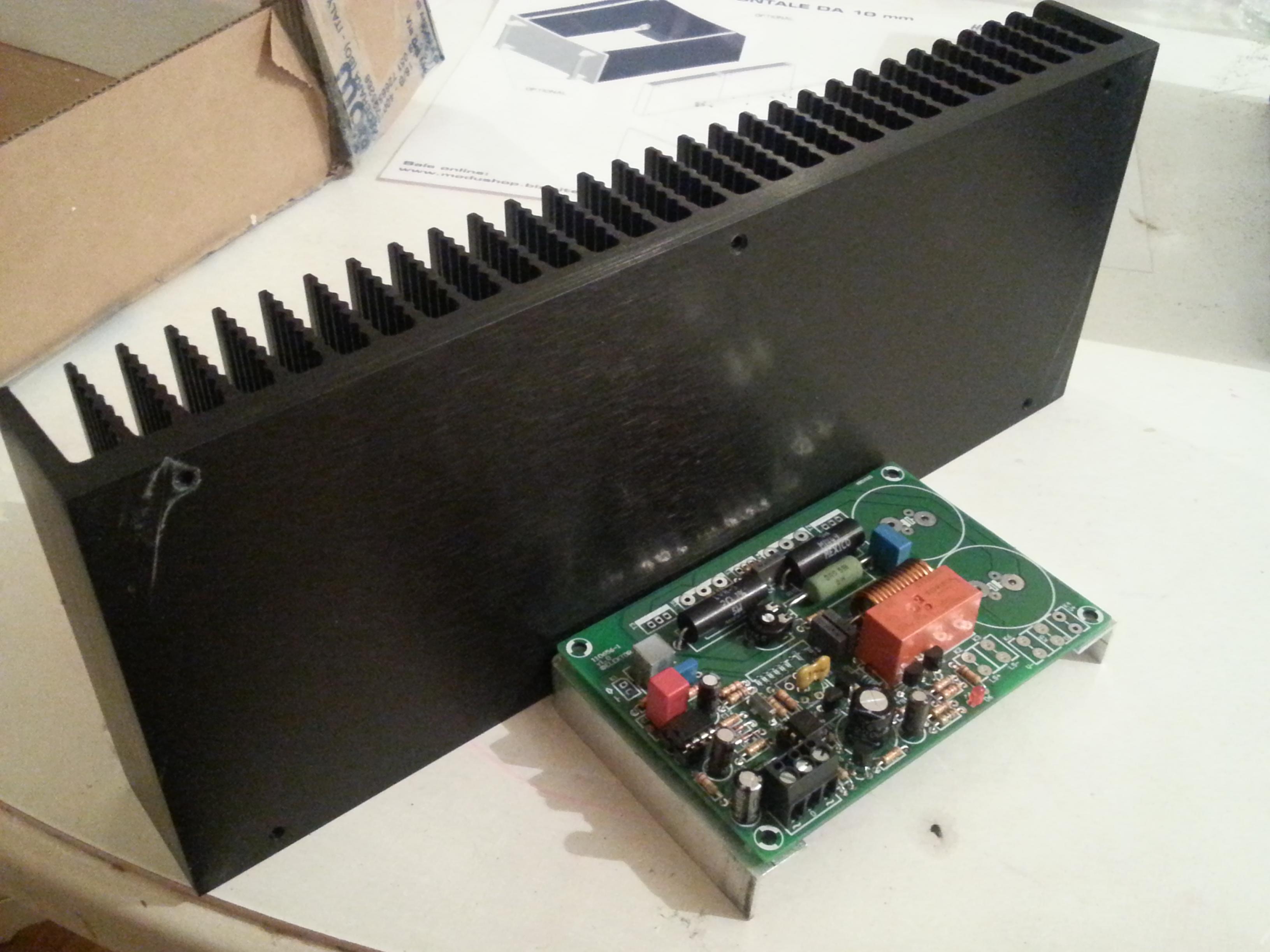

Hi popchops. Many thanks for your help with the case.
Order will be sent today.
Here's a quick photo of the 3U 300mm deep case. The 2U case I think has adequate cooling but my caps won't fit so I went for 3U.
I was a bit disappointed with the feet. Poor quality.
