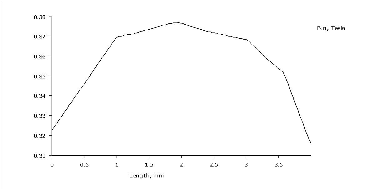

the sort of sinus you see is not the membrane but the flux. i pull a line between top plate and then bot plate. where the membrane would be in the neutral position from left to right. then the graph you see is the fieldstrength. you must read it from left to right. starting with the first magnet row, then the gap where the coil will be then a magnet row etc.
since poles are reversed every row the strength goes up in the gap lets say north, then drops down to neutral or 0 in the middle of the magnet and then strength goes up in the next gap to the south south. this might be not completely correct how i explain it. but the fact is you want the strenght there as high and even as possible, and poles switch every row🙂 if the fields is uneven then you will have more distortion. since its not moving evenly
also because you put north facing north on the stator the field is gone run between these and the next row.
sorry my explanation is not helpful neither is it correct 🙂
bottom line field strength is strongest in between rows of magmets, this is what you see in the spikes, either upward or the downward spike.
you want this spike as wide as possible ash high as possible and as smooth as possible. all things that wont fit together verry well as usual. wider means less strength and not smooth. to sloce mean strong field not really flat, and not wide enough to put a few traces of coil in between
Yes then I have the same understanding and my drawings are ok. In post #91 the red line represents an (exaggerated?) view of the membrane as a result of (the uneven) magnetic field and the position of the traces on the membrane moving through the 0 crossing.
("the sort of sinus you see is not the membrane but the flux." - yes but the flux drives the membrane so it will have a direct correspondence to what happen to the membrane - take or give how the traces are layed out - rigth?)
...where the membrane would be in the neutral position from left to right. then the graph you see is the fieldstrength.
What does a graph of the fieldstrength look like if the line was drawn away form the "neutral" position? Say much closer to the magnets - e.g. near max.
Or draw a line 90 deg to see how it changes as the membrane swings between 0 and xmax (say in the middle of the peak - it now docent matter where on the peak as it is now so flat).

ideal it should be equal since its a push pull system. will take a look later this day will measure it 0.5 mm from front plate. so at 1.5 mm excursion
that is already pretty ok, could tweak it a little by increasing the gap ever so sligtl. or play with the distance between rows. so you got 2 parameter and 2 goals. to meet
good even horizontal field strength
good even vertical field strength along the excursion
but both are affected by the 2 parameters. so there should be a compromise somewhere in between.

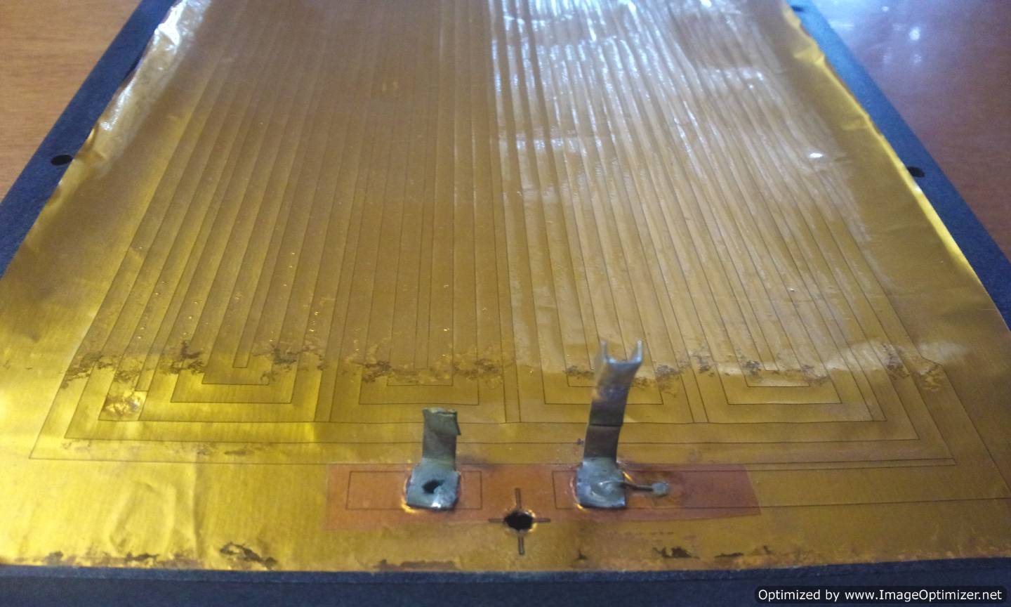

First to escape something like pictured in humid environments...where humidity is sucked in the foams surrounding the foil...slowly eating away the aluminum trace.
Second to protect it from fine metallic dust and small flying objects.
Third it enhances thermal stability as the Kapton dissipates heat evenly in it's entire body.
My friend has told me that it's something they use for pro drivers that get really abused...
Plus, anything "composite" has inherent damping abilities...as already described
in the Epsilon white paper...
