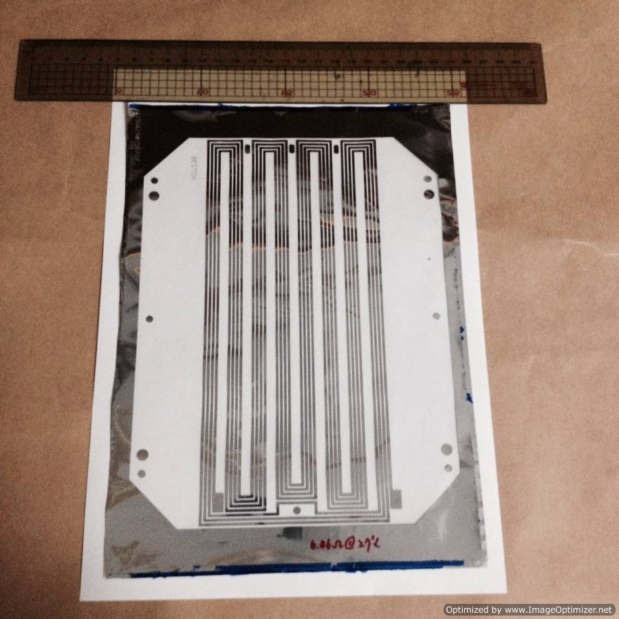

I just received a photo:
I said that the test foils are going to be in PE that is a bit cheaper. I have asked for four foils for my tests.
These will be 22X17 (a bit short) ...hence the lower impendace (6.5 Ohms).
Probably the final version will be a bit longer so that the 6.5 Ohms will rise to 8 Ohms...

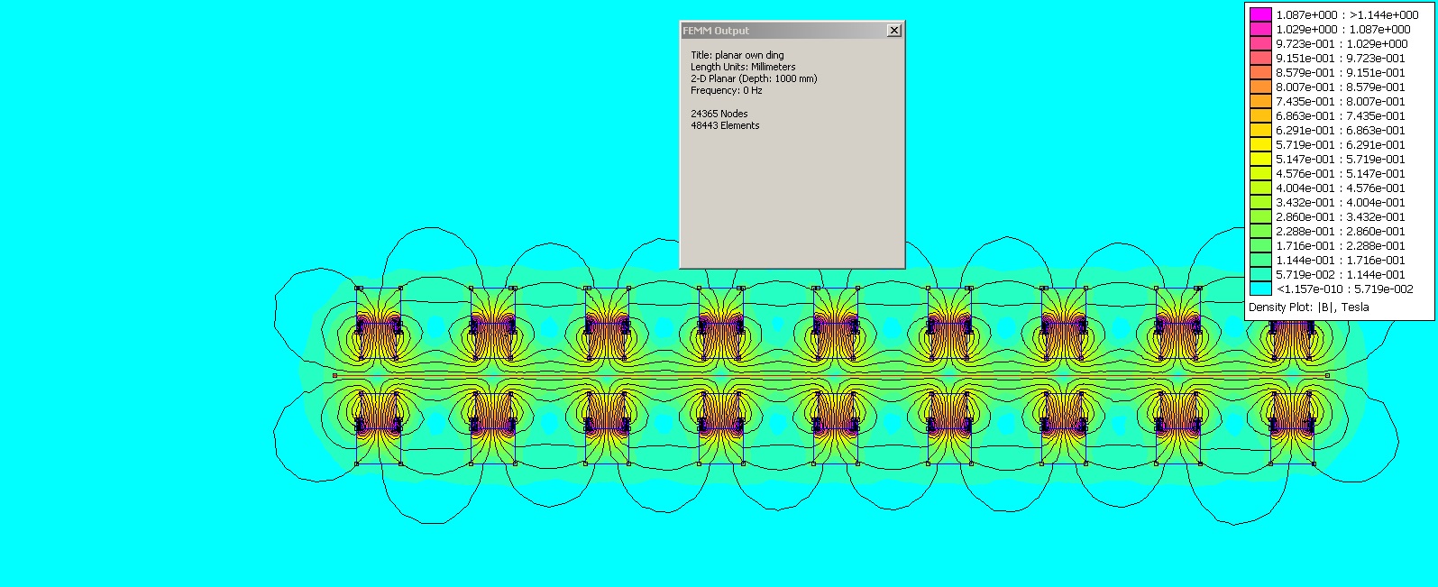

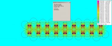

Here i made a sim. You can see the concern i had with the width of the rows(and thus open area) the gap is not very even.
my advice would be decrease space between magnets you get higher and more even field strength. this means either making it less wide or add more magnets.
this is a model with Neo40's
metal is thick enough not even close to saturation.
just my 2 cents
btw it will work as it is, just something you can think about if its not to late to change small things in the design?

I see your point...although i would like to see a description of what the ideal would be (and how much is this feasible in the real world!).
Perhaps you could shed some light in the subject.
You say this is calculated with N40 Neos.
As i mentioned i have on order up to N50. How much would this change the picture?
The same goes with the spacing between opposing magnets.
I have provision for 5mm(+/-2.5mm) and 4mm(+/-2mm).
Can you make a FEMM study with this scenario (N50s AND 4mm distance between opposing magnets) for comparison?
At the moment the magnets are spaced out at 9mm.
If i was forced i could bring them closer by 1mm (down to 8mm)
i would need a set of 5mm wide X 4mm deep magnets.
How much better the picture would be?

N50 wil make it a bit better but its not the distance from magnet to magnet (from front to back) that is the problem. it is more the magnet to magnet on the same plate distance. when you think of it its pretty obious, you got square magnets, and the opposing distance is 4 mm and from row to row, its more then double that. using neos 50 will results in the same uneven field as fas as i know but stronger 🙂 i would get them closer together lets say from 9 to 6 or 7. ofc best way is to model it ofc. but i hardly model this stuff for myself since its a pain in the *** to work with femm.
