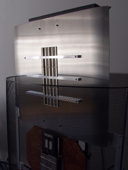

I've made some calculations.
According to the calculator the repelling force between two of the 4X4X4.5mm magnets at N50 and at 4mm apart is 3.27 Kgs.
Multiply X 4 at each row = 13.08 Kgs
Multiply X 9 rows of magnets = 117 Kgs.

5mm plate with all those slots will never hold 117 kg im afraid. without bending. if it does bend you might have problems with the patend of BG 😉 haha they patented the fact there structure bend 🙂
Ooops mistake: At N50 and 4mm apart the force is 29.5 Kgs.
At N50 and 5mm apart it's 23.9 Kgs.
At N42 and 4mm apart it's 24.6 Kgs
At N42 and 5mm apart it's 20 Kgs.
At N35 and 4mm aprt it's 20.6 Kgs
and at N35 and 5mm apart it's 16.7 Kgs...
I think there will be no problem with steel bending...
You have to think that it's widely distributed and most of the problem is at the middle of the rows...that's why i have them connected together.
If that won't be enough i have provision for an extra cross steel bar at the middle reinforcing the metal exactly where it counts.

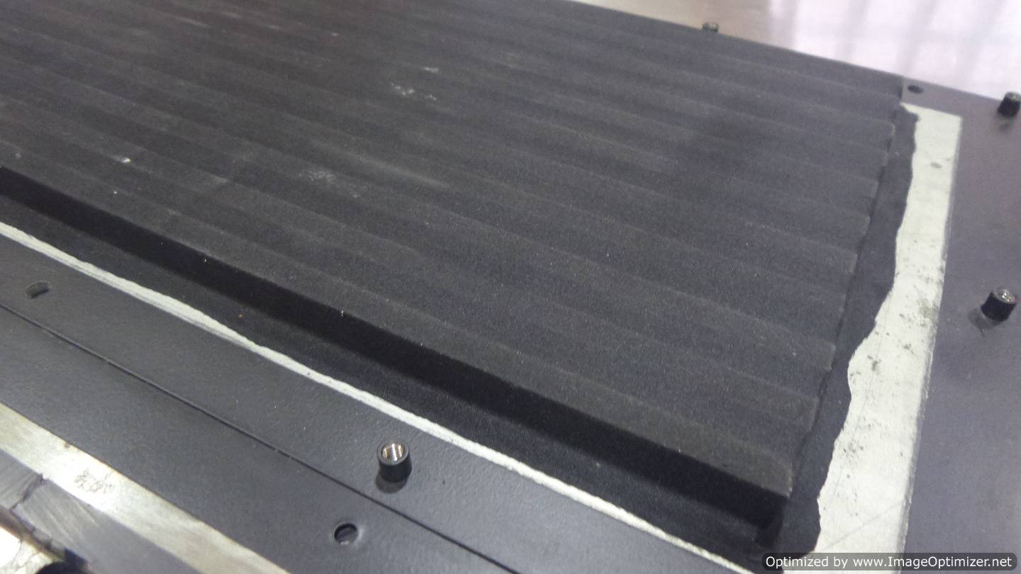

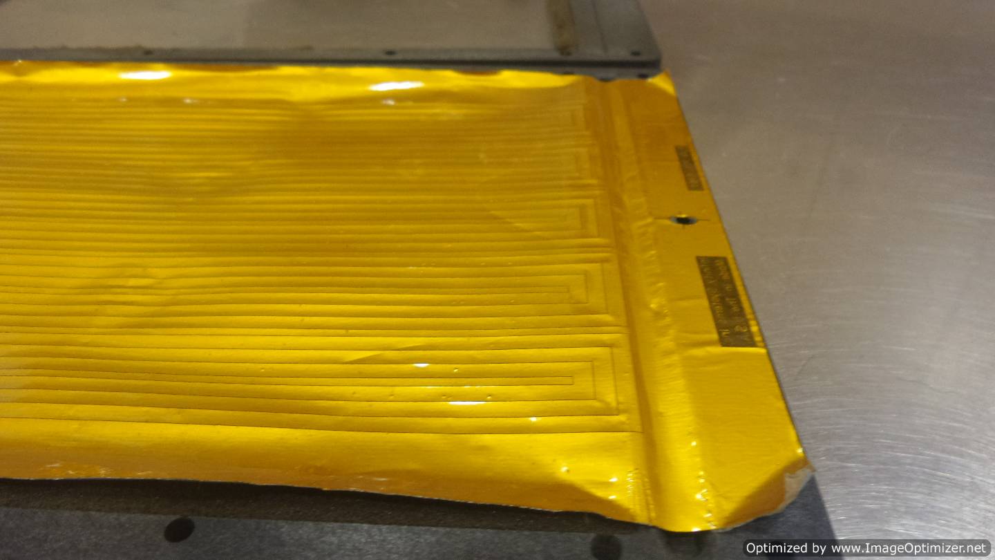

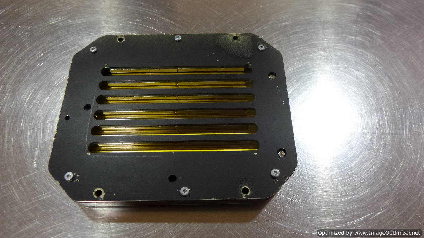

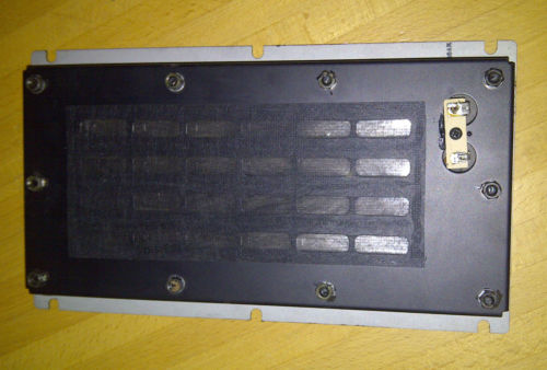

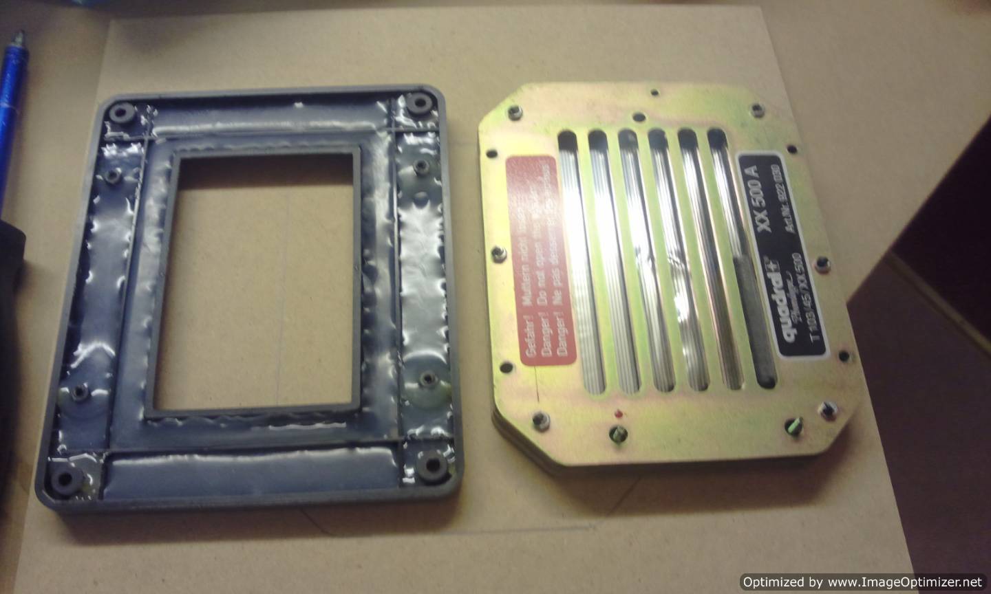

I have promised to talk about the Quadral XX-500 that has been my absolute favorite so far for a midrange driver.
Dimensions of the frame are 13X16cm whereas the visible part of the vibrating area is 6.8X11.2cm.
The steel plates are 3mm thick of treated steel (galvanized?) that have 6 slits each.
The slit openings are 7.5mm wide and the solid steel bars are 4.5mm wide.
They support N42 neo magnets (3.5X3.5X50mm) that have been double nickel coated.
The first production run was with N40 neo magnets with a PU coating that unfortunately didn't last.
As a result the magnets deteriorated, producing fine magnetic dust and finally dislocated from the steel plate ripping off the foils.
The foil is from 20 micron Kapton (later with Kadalex?)with a 20 micron aluminum trace (1mm wide) on it.
The trace runs on a 6 lanes pattern having about 50% coverage of the vibrating area (11X13 cm).
The plastic frames have a thickness of 5mm (leaving the foil a +/- 1.5mm of travel), employing a clever system of tensioning with a worm screw.

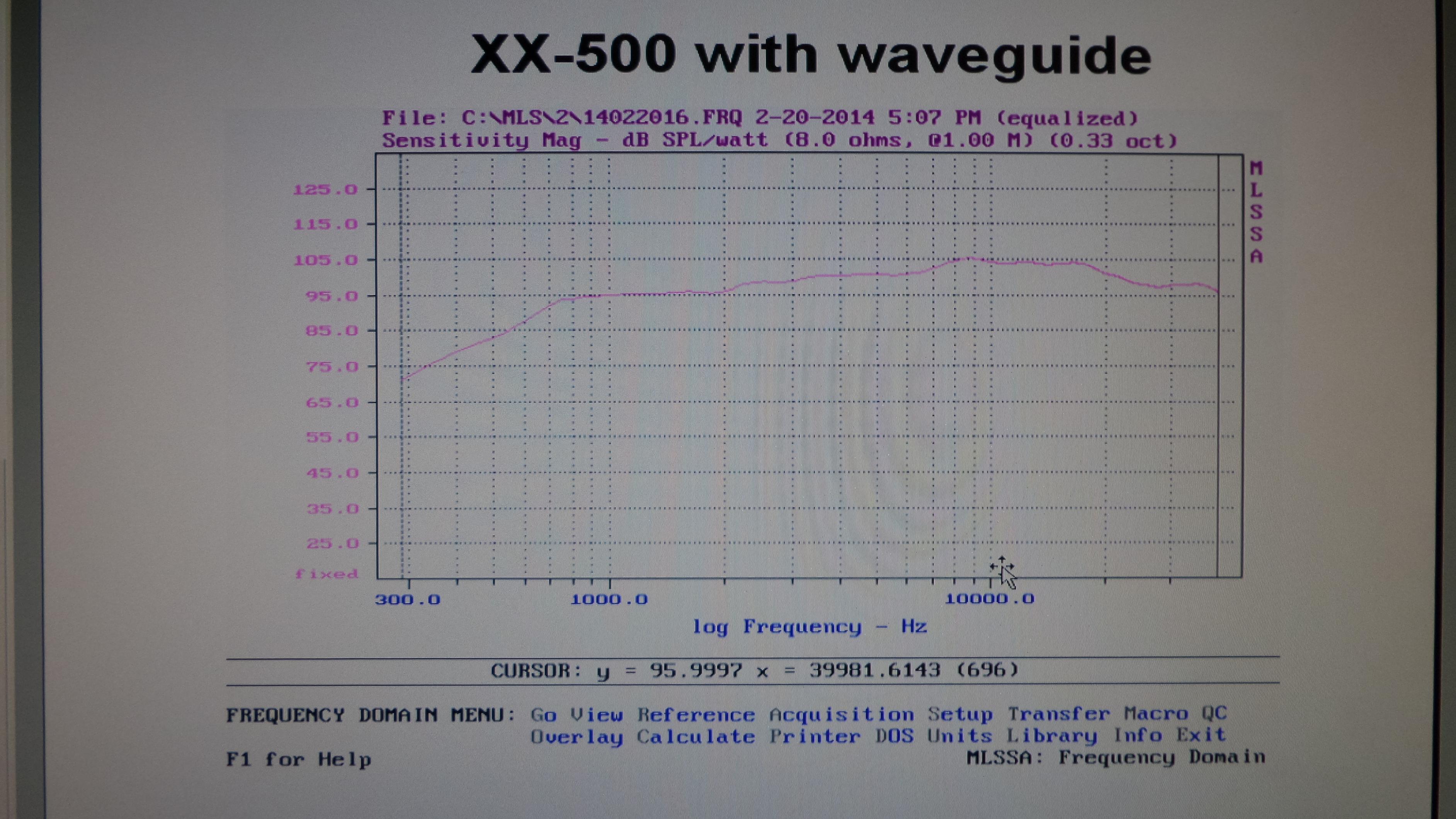

The impedance is an exact 8 Ohms having an SPL of more than 90db...
A wild guess is it can take about 80 Watts before melting!
It sounds FABULOUS! Open detailed and fast...
It has no back loading with cloth or any other means as it was used with a back chamber loaded with acrylic foam.
I have CNC cut a slightly deeper aluminum frame instead of the flimsy plastic one to provide a better support and to boost slightly the output.

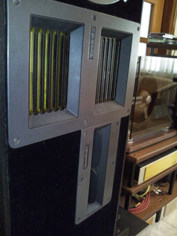

In the process of modifying my speaker (VULKAN MKV) i have added a second mid and a second tweeter (XX-1000) to even the original somewhat bass heavy character of sound.
Then added a second smaller woofer (in acoustic suspension) to make the coupling with the 10" TL loaded main woofer even faster and easier.
Of course with external passive Xover...
Anyway the subgect is the XX-500...
Here are some photos...

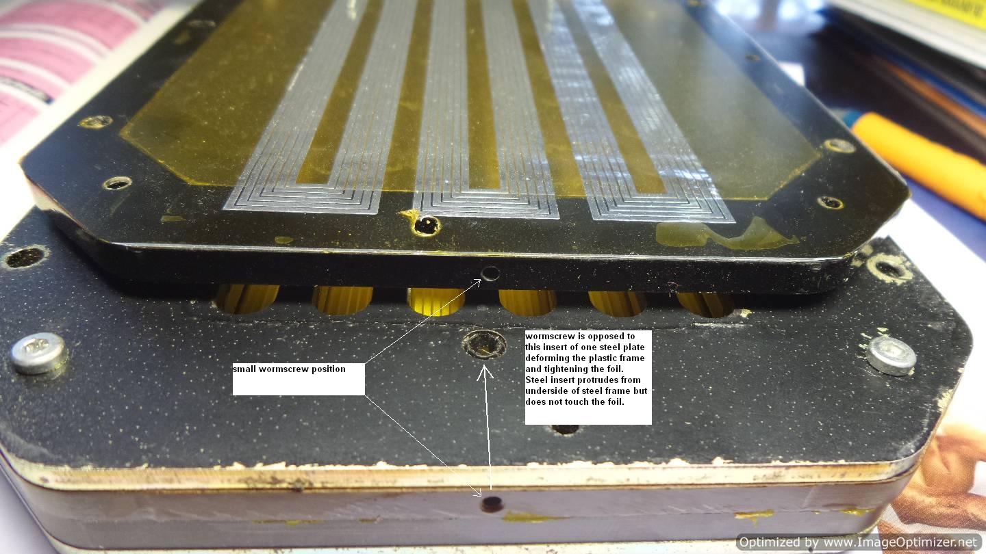

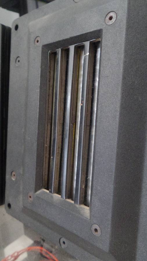

Procedure:Loosen up the clamping screws in this area only.
One worm screw is "pulling" out the plastic frame (the one that has the foil attached) as it is screwing against an inert metal insert protruding from the adjacent steel plate.
When foil looks free of wrinkles re-tighten the clamping screws...
Presto!
Presto!
