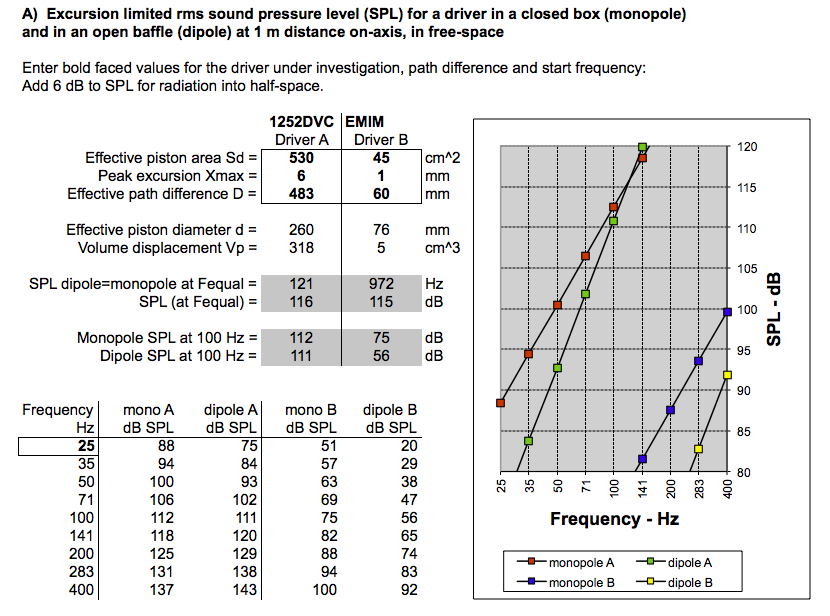

Using this: http://www.linkwitzlab.com/spl_max1.xls gives for EMIM 4,5x10cm and max 1mm (?)- no baffle (D iscenter driver to baffle edge):
The horizontal pattern of the Neo10 seem good. I'd say keep the width and make it a bit longer for some extra ompfh in the lower region?

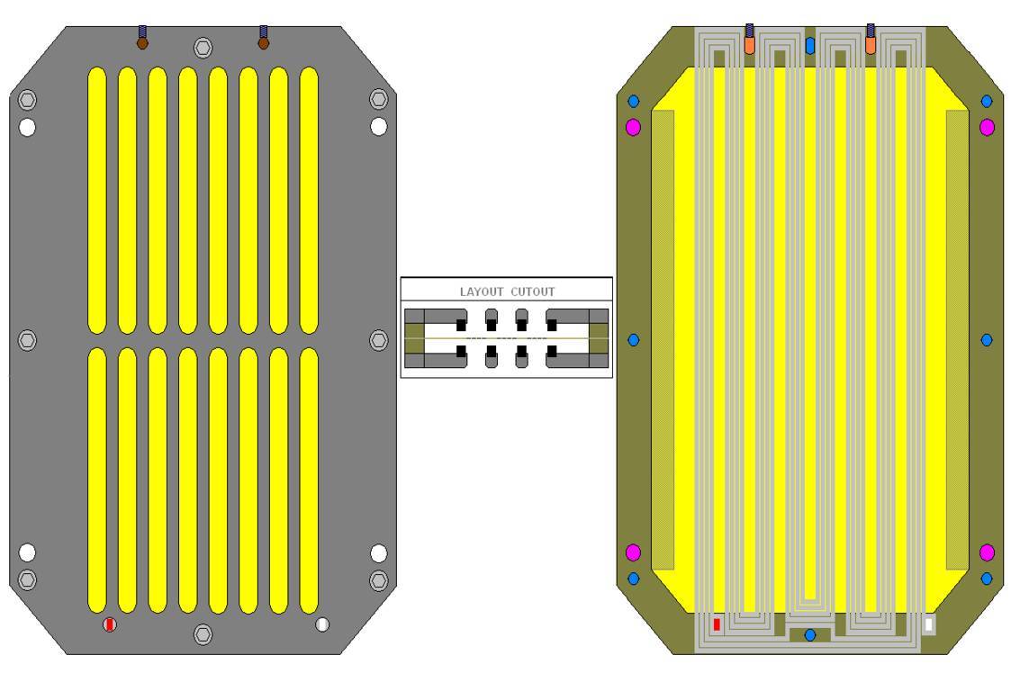

I didn't have the dimension specs for this Piega driver.
From the article photos and from careful on screen scale calculations it seems that the true mid element is 14.5 wide to 13 high placed in a roughly 20X22 frame (if someone has the actual specs feel free to correct me).
It is an unusual speaker in many ways...
1) It is wider than it is tall (!) in contrast to the general consensus...remember IRS Gamma?
2) The magnetic force is not symmetrical because it uses bigger magnets in the back!
3) The slits on the back are much smaller...i suspect not only because the rear magnets
are bigger but also to provide the "loading" for the foil...not having to use cloth or any other damping agent (clever, but you can't tamper with it).
That's an interesting calculation about the EMIM.
Proves that all things being equal (400Hz dipole VS 250Hz monopole) you can go roughly an octave lower with the same driver if you work it as a monopole, keeping the SPL in respectable levels...
I will go monopole. I need to cross with a very healthy output (90+ db) at 250Hz max.
The NEO-10 in a frame of 12.5cm X 25.5cm has a radiating area of 6X20cm.
There is no way to get healthy output at 150 Hz from something so small.

point 3. my guess is they wanted these bigger magnets on the front as well for better efficiency etc. but did not want to lose the open area at the front. another reason can be that spreading out cavity resonances make them less obvious.
still a very weird decision if you have a pusch pull that is not symmetrical. are they even the same type of magnets >? maybe they used stronger smaller ones in front and weaker /cheaper bigger ones in the back to still have true push pull, and as well skim on the costs, and spread there cavity resonances?
think it would be hard to get it complete symmetrical. ...

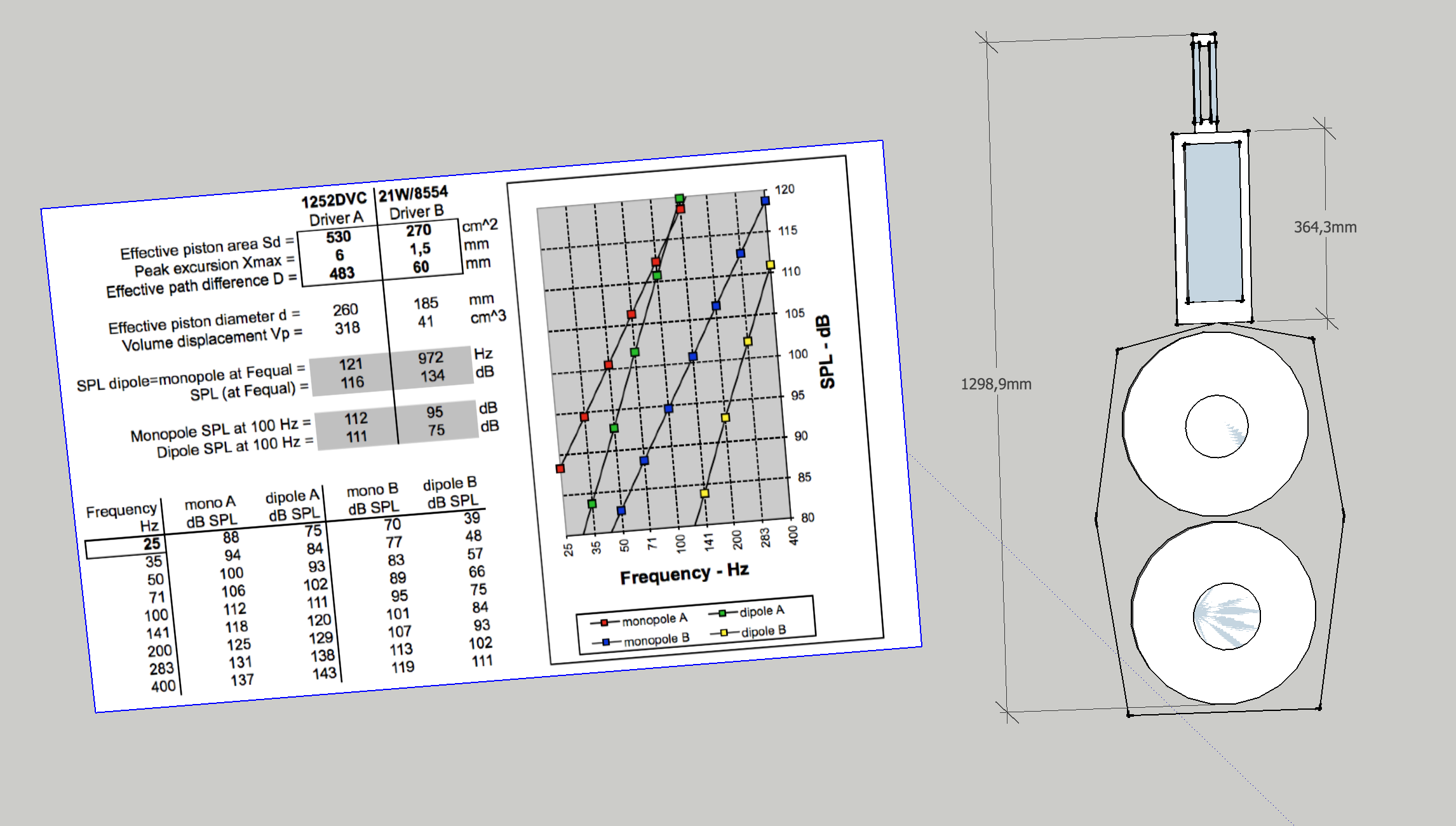

witch one is it in the picture>? 30x10 is 300 cm2 dont see it anywhere. also this is about woofers. volume displacement in a membrane is slightly different i think since the sides dont move as much air as the middle part.(or is this why you chose 250cm2) dont know a method to calculate it or something. but i can imagine that the middle part has a xmax of 1mm a pretty big part of the membrane does not. btw is 2mm one way xmax ?
not sure if this model is looking at a pistonic action,
I agree with your questions. Yes tried to compensate for the less moving edges. xmax is 1/2 p-p.
but with strong magnets a 2or maybe even 3mm xmax(one way) is easy obtainable.
i mean i think magnepan used 1.5-2mm with the rubber magnets that peform even worse then normal ferite, and is not push pull either.
try femm maybe you can see the difference between your neo's with xmax of 3 mm versus lowest ferite with xmax of 1.5. see witch one is stronger (neos will be, but how much). ofcourse you have to take in account that the magnepan uses a bigger surface area as well

Some minor alternations will have to be made probably but this is the general idea...
I have withheld some crucial details as i think there will be a commercial interest in this.
yeah that looks like a planar 🙂 . you are either using incredible thick metal or you get some bending going 🙂. the neo's have struts for strength. the eminim have super thick metal bars. nice trace layout , look like the neo's ? and i like the flange! nice detail
what i got my doubts about is the width of the slots and the width of the traces. i am not sure if you get high/and even enough field in between those magnets to be honest.
they might be to far apart to form a decent field?? lookup femm please. you can moddel the cut out and you know what you got. now its just gambling with money.
magnet open area percentage looks smaller then most designs, thats why i think you should model it maybe
It's 5mm thick steel plates.
I can go up to N50 magnets...4X4 at the beginning.
I have provision for an external middle reinforcing bar is their strength proves too much.
I have made my comparisons and this looks very promising.
I am willing to make 3-4 prototypes and measure the outcome...
It's going to be a blast!
