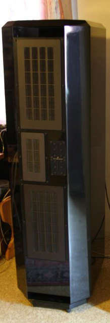

George i am sorry that i have not read your review.
I am not very active in whatsbestforum lately because i saw a shift to a kind of products (and a similar in mentality) that are (...ahem) beyond my wallet and comprehension...
That is an interesting speaker...and it's a pity it's not very well known.
Let me share some light into why i am doing this:
In the course of many years in the this hobby i have acquired a particular interest in planar speakers.
To my ears their ability to portray speed, attack, resolution, and nuances/harmonics is beyond reproach.
You can't escape mass and inertia...unless you can make a midrange cone that weighs 1 gram...?
I have witnessed this over and over and to these ears it's a fact of life.
I have heard big Infinities, Apogees, Martin Logans, Audiostatics and Magnepans.
Soon i started to realize there are sectors within this group: magnetostatics vs electrostatics, closed back vs dipoles, fullrange vs hybrids...
I've listened to all of them but one has to make up his mind in the end.
I chose hybrid-closed back-magnetostatics because of practicality and potentially excellent sound.
I am not saying in any way that the other types can't play excellent...just that this is the compromise i can live with as:
1)It gives me speed nuance harmonics and detail that is MUSICAL.
2)It gives me bass (i LIKE bass) in a practical shape as it employs woofers that are KINGS low down (unless you can afford the cash and room for MG20's or Analysis Orion)!
3)They can be used as an ordinary speaker with no need for AC power and step up transformers that make things complicated and expensive...
There is a fly in the ointment though and it has a name:integration!
The integration of something having ultra low mass and doing it's job by making minute movements of a large foil area with something that has a heavy cone that moves back and forth several cm IS a problem.
We can't completely solve it but we can ameliorate it and make inaudible.
Three things that (IMHO) can help within the parameters of a certain design:
a)A low crossover point.
b)a boost in bass response of the lower mid region that gives oomph/presence that planars genetically lack.
c)Gently Xover slopes.
As for a) it would be good to be able to cross at around 200 Hz keeping the most of the human voice in one piece.
As for b) you need bigger (or more) panels that can produce creditable low mid frequencies...AND you can put them in a closed back configuration that will boost the critical area.
As for c)the 24db/oct Xovers are the rage because they assign each to their own making life easier on the drivers (and designers).
But they make the speaker a sum of parts instead of a musical instrument...thus musicality suffers!
And they certainly won't help in masking the transition from woofer to panel!
And that brings us to this driver:
I want something that can cross at eg 250hz but will not disintegrate at 100 Hz!
And my woofer will still play a fair bit at 500Hz...
Woofer loading is another topic.
Let's just say i love TL bass...

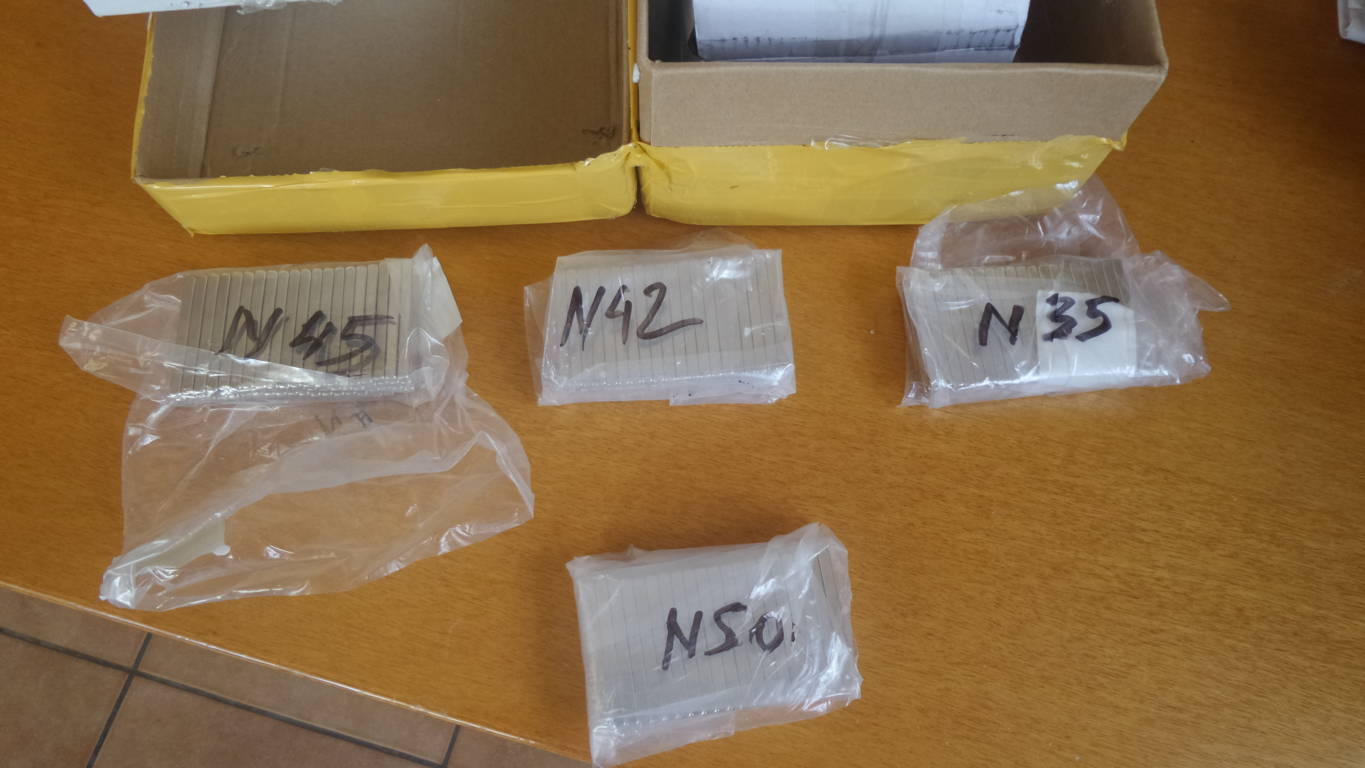

I will when i receive the parts from the CNC shop...we had to wait to receive the bakelite sheet for the spacers...
In the mean time i am pouring my brains out trying to master the FEMM...
Interesting findings!
I will post soon...
BUT i have to test mine to see the limits of the specific design...
I will post soon...

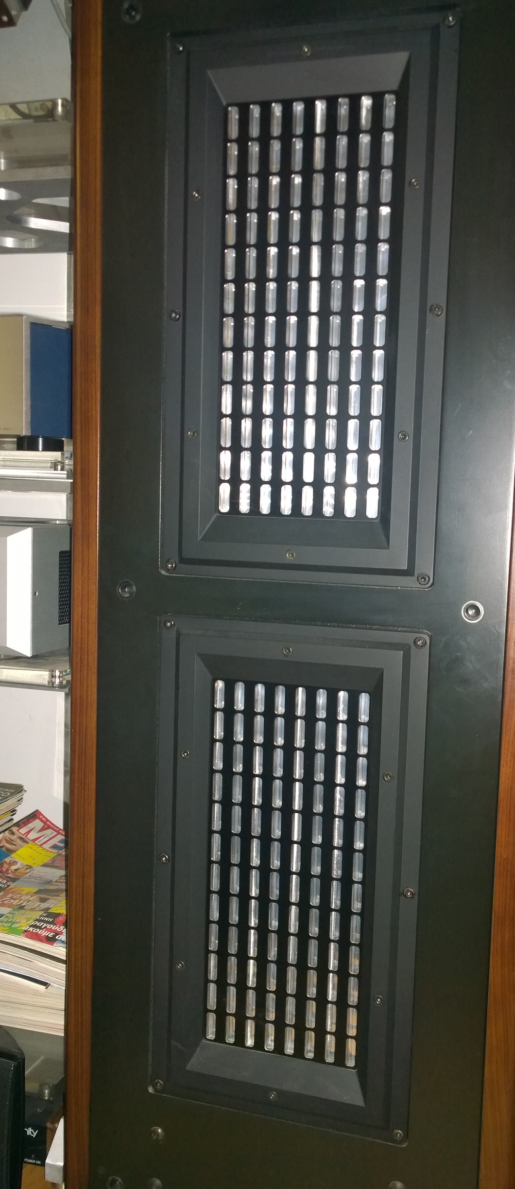

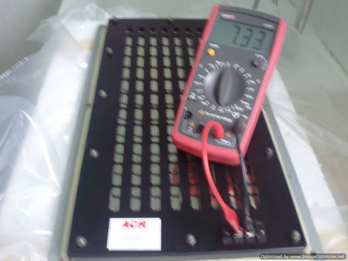

I had a pair...and sold them.
Opened them up by drilling out the rivets...replacing them with bolts afterwards.
I mean...who uses rivets on a driver?
I was not very happy with it.
It does not go as low as advertized.
Usable to 500 Hz (single driver).
Of course can benefit from a monopole configuration...again to 250 Hz if you want some gentle Xover space around it.
To my eyes it looks cheap and cheerfull made to a price point and feels like so...

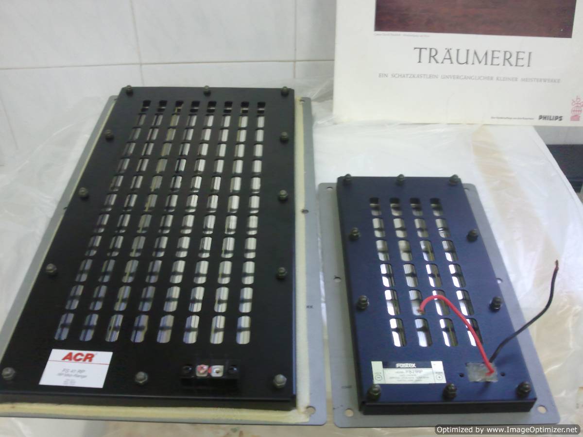

Are you still going for that 0.25 mm Kapton? That is way too thick! Apogee used 0.025 mm for their bass drivers operating below 500 Hz.
I see that you calculate excursions of +- several mm. That is really not true for such a small diaphragm. The foil cannot tension that much and it will also make a bend with an even force applied - reducing the effective movement to about half. There is no movement around the edges.
If we look at drivers as Fostex FS-21/41, Infinty EMIM/L-EMIM (L-EMIM=Fostex FS-41!) etc. They cannot move very much air and that is also a limiting factor in some designs like the Infinity RS 2.5. You will need a large number of driver for that.
Graz in Australia have some replacement diaphragms for the EMIM, corrugated ones that are not attached on all sides, the are more like ribbons. Sure they will hit the magnets, you need to increase the distance between the them - lowering the efficiency.
If your goal is the use your drivers the all the way down to 200-250 Hz, you will need to move some air... That is difficult for many small planars. The midrange driver of my Magnepan Tympani IVa is 8x140 cm, good to about 400 Hz.
Welcome Roger!
The Kapton foil that is readily available is 20 micron (i missed a zero!).
I can find even thinner with glue backing or not if for making a sandwich foil.
The maximum allowance will be either 2.5 or 2mm (that is before hitting the magnets).
Big low mid panels (FS41/LEMIM) have a 5mm between magnets.
Of course i don't know if they reach that limit but that's the design - i have measured it.
If i want it modified i can always cut thinner spacers!
I have talked to Graz many times...clever guy and willing to discuss. We were talking once about the viability of a true bass panel...
About the suspension of the foil:when it is glued on all four sides that limits the displacement - mainly because of the tension applied to the sides and not on top and bottom. That is because all drivers are taller than wider (Piega excepted).
The H.E. LEMIM is made like this: on the sides the very thick foil -0.120mm in total- is just suspended between two foam strips and glued on top and bottom.
It will not go very high with this thickness though...limited to 100-500Hz only.
However all true midrange drivers are glued all way around...even the FS41RP bass panel is like that - i don't know about the old LEMIM.
I am in the dark as to how much bass my design will produce.
I just have to make it and measure.
All i can do is to make it a bit larger than the usual mid... and hope for the best.

The rumor is that Infinity made it's planars outside USA(?) whereas Fostex was Japan only.
I am not so sure they used the same foils...I have in my own possession 3 pcs of FS41 and a friend has a great speaker named SAC Anthaeus that has 4 of them.
The foils in all of them are as tight as day one when in the BETAs of another friend and everywhere i look the foils in old LEMIM are all wrinkled...
The magnets in LEMIM are ceramic when in FS41 are samarium cobalt.
The whole thing looks better made and lasts the test of time much better than LEMIM.
So...perhaps the foils were all made by Fostex but the rest has a different execution.
