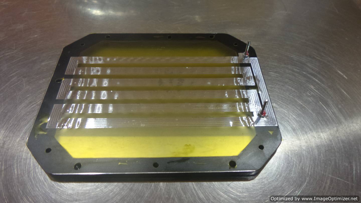

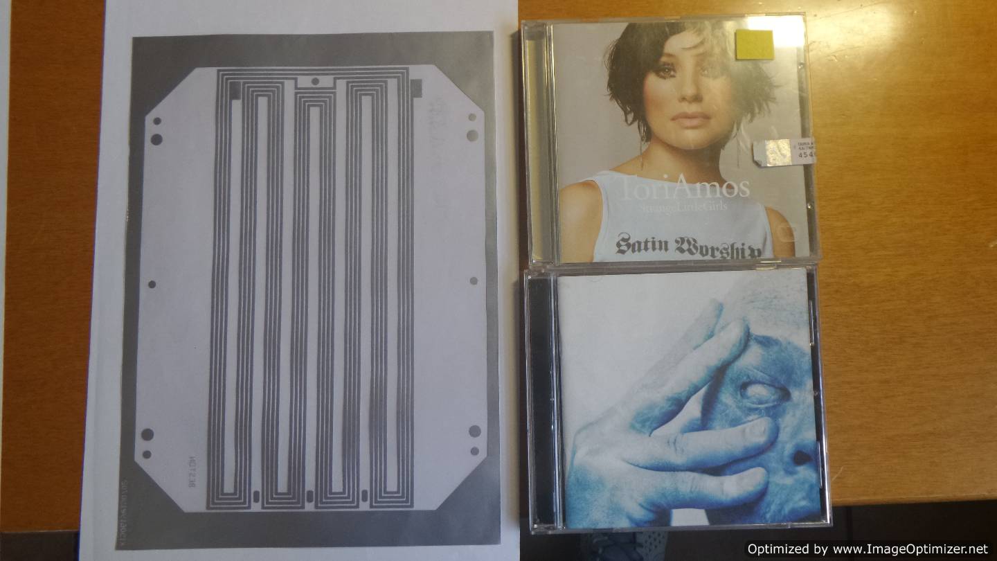

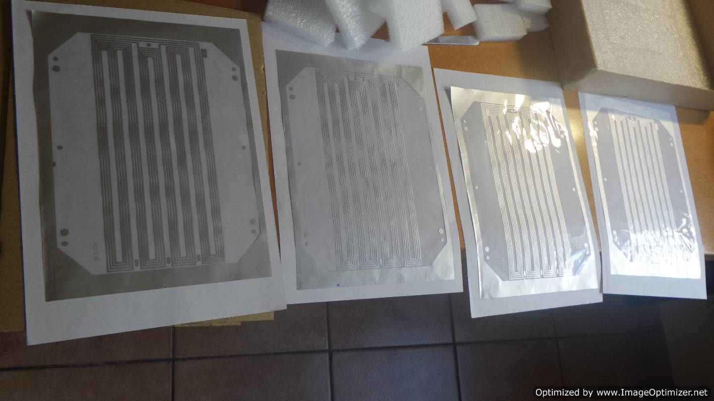

Well guys...picked up my test foils today!
Four pieces in all and very happy about it!
Took a couple photos of them.
Very well executed...just like i planned them.
Now i have to put some pressure on those CNC guys...

Unfortunately they are going to be yellow in the end...
I added the cds for scale...
I hope you like my selection!
Haha, weli thought kapton is yellow i think this is the Pe version. The final one will be yellow 🙂

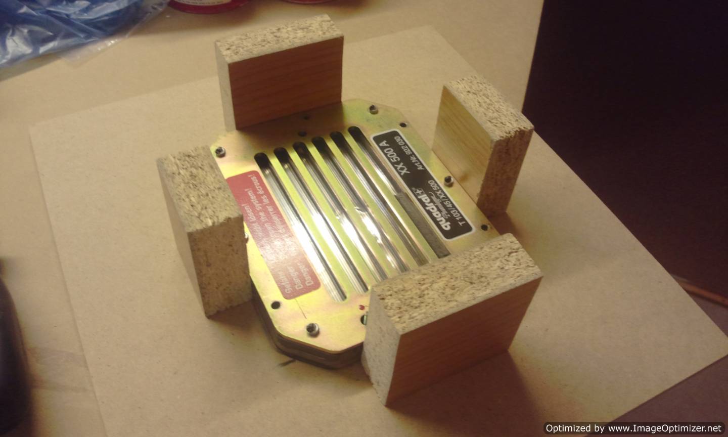

Have been playing with a planar some years ago Sensible Audio ... one hint with "push-pull" design ... be very carefull when putting the 2 sides together .... I used mags that where 2 mm thick you are using some monster ones ... there is really much force in play and they will try to missalign and pull together in the groves between the other mags on the opposite plate ... smack 😉

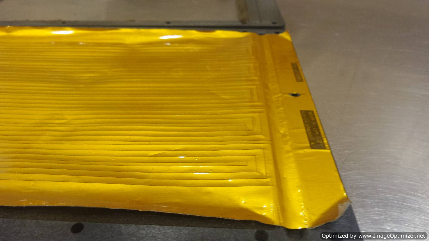

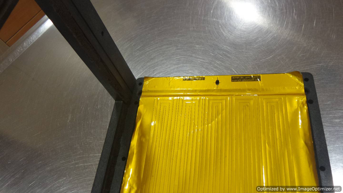

One thing I have been thinking about is how the power handling ability is affected by running the ends of the traces under the frame. It of course depends on how the diaphragm is mounted or glued to the frame ... but if it is done so it is no thermally conductive to the fram and therefore to metall and then air ... this will be the weak spot power wise. To have some damping I think I would use double sided tape to mount the diaphragm ..... not sure how much of a problem this will actually be ... just worth considering.

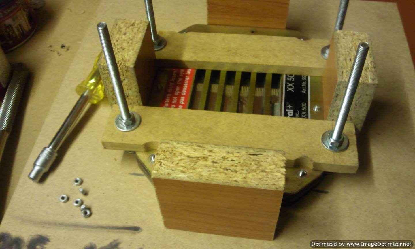

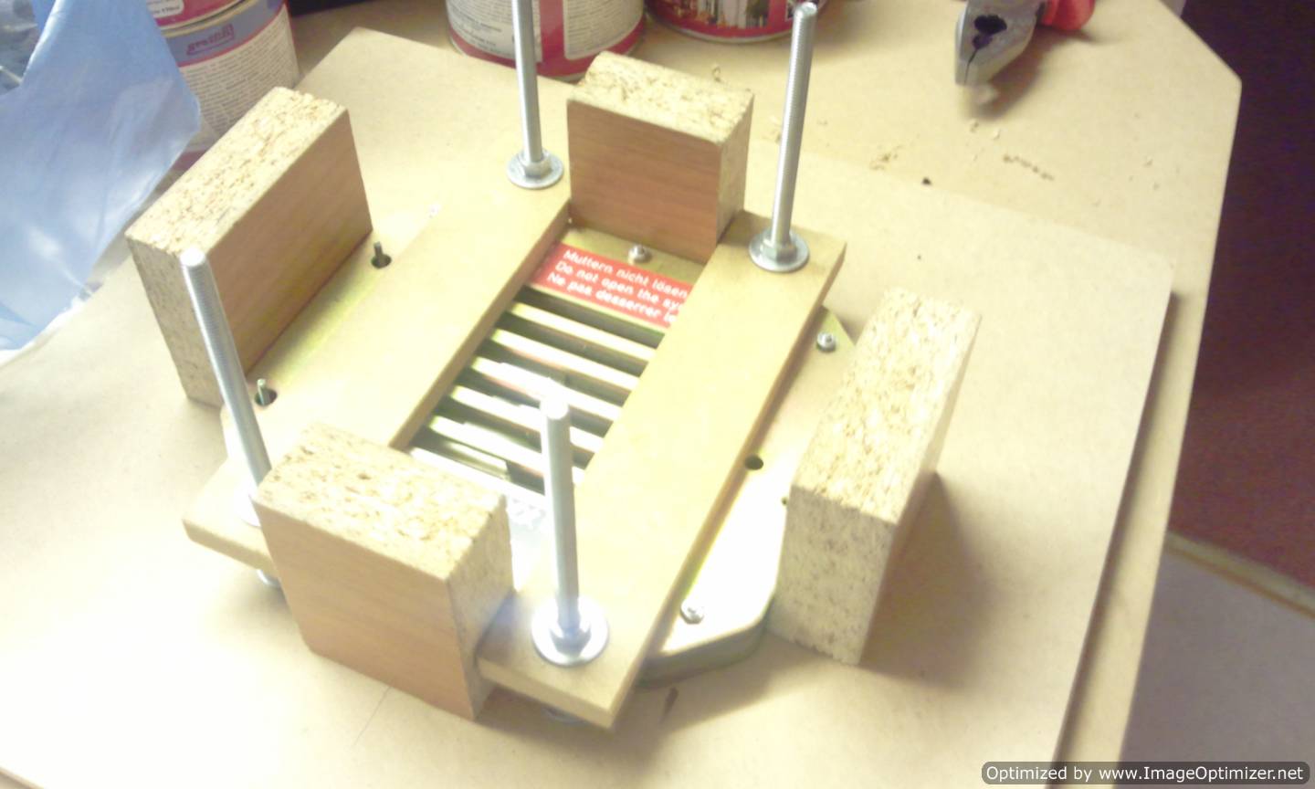

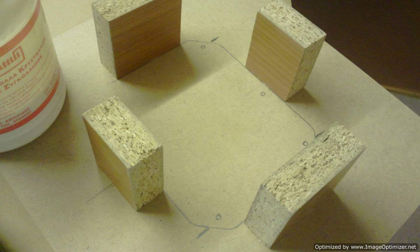

I know how easy it is to mis-align the frames when opening and closing!
I have my fair share of opening and closing various planars and have noticed
how difficult is to keep them exactly opposite when they are coming close OR pulling away!
I have made myself a certain type of "guide" that is very effective in securing just that.
Just some pieces of MDF and careful placement and there is NO WAY something bad it's going to happen.
See pics below.
As for the traces running under the frame...it is very much widely used and have seen it again and again so i imagine there is no obvious problem.
Again see pics.
I imagine that the diaphragm is an air cooled motor as it has a gigantic ratio with direct air contact...therefore that portion is acting as a intercooler (car term!) for the whole area.
On the gluing area i will probably use a really thin layer of double sided sticky tape (for PE foil only).
Not fancy but with the pressure applied from the clamping screws all around it will hold.
See pics below.
Again see pics.

Color of course irrelevant. The 2 CDs are unknown to me.
Well...it's Tori Amos's Strange Little Girl and Porcupine Tree's In Absentia...

Good to see you are in control with the jig ... looks good.
