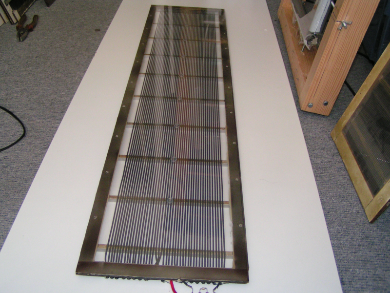

Audiostatics are an example of full range statics without dampingmesh or grill cloth
That's true, but they do have another kind of damping. Audiostatic uses silicone dots that are placed between membrane and the crossmembers that support the wires, see picture.
I once measured a panel duing a rebuild before and after application of the dots and the effect was quite substantial. I can't find the measurements anymore but with the dots you get a lower and wider resonance peak. Q of the peak dropped from somewhere in de 20+ range to well below 10. Same effect as a mesh or cloth type damping basically, although a mesh probably can give more damping than the dots can achieve. It's a trade off. Woolier more resonant bass but better tranparancy in the mids and highs.
When i wrote my message about audiostatics I thought about the dots but didnt mention. The reason is that I am not sure if they truly dampen. Q lowers obviously but it also broadens. I.am wondering about the area under the curve; is there less resonance because of dots or is it just redistributed. Maybe maudio remembers? Maybe it is bit of both? I m guessing so because the dots are relatvely soft so absorption of energy may occur. Higher resonances could be better damped by air.
I think the amount of damping is small, especially in the low frequencies. The dots have some flexibility but not much, I don't think they allow much movement of the membrane at the fixing points. So I can't see the dots absorbing much low frequency energy. I think you're right that the effect is mostly due to breaking up the membrane in smaller sections.
